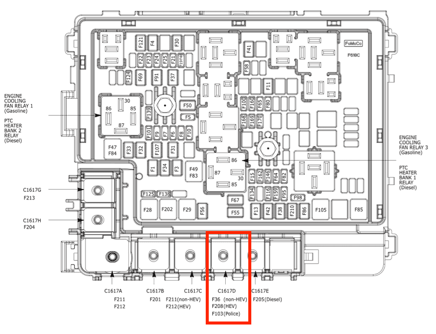

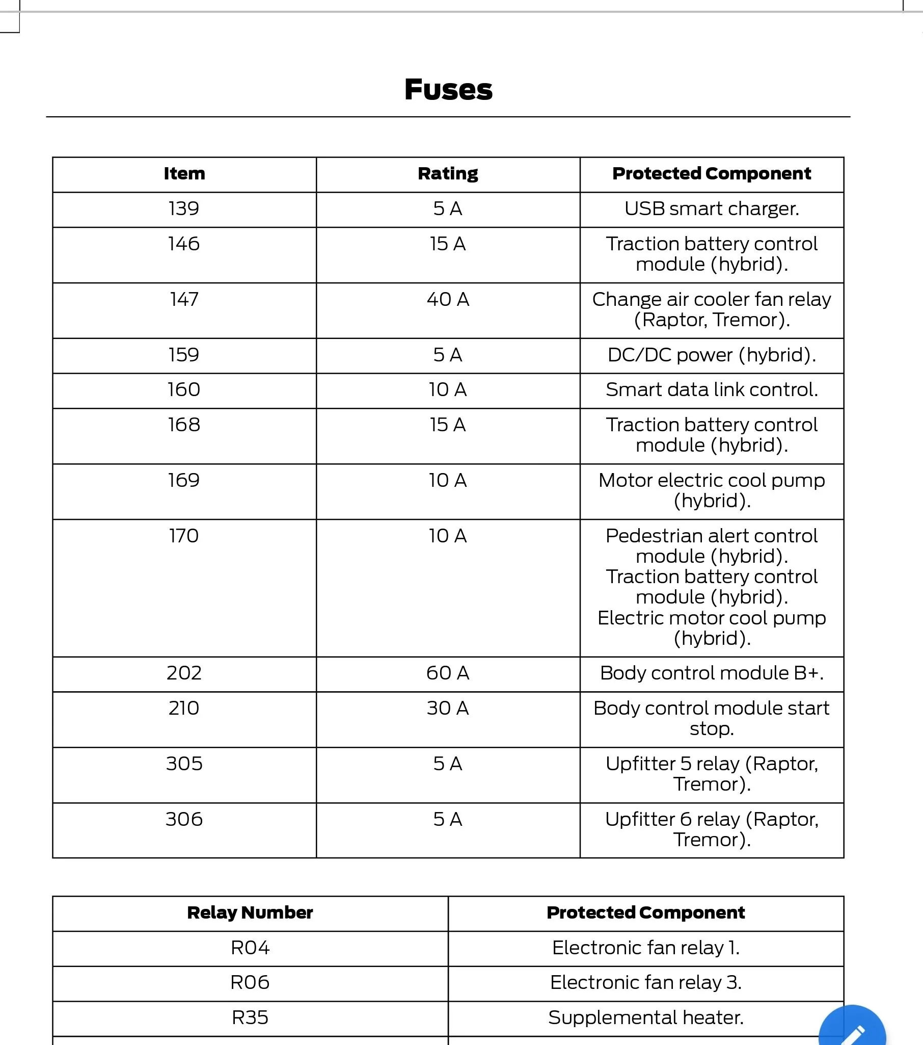

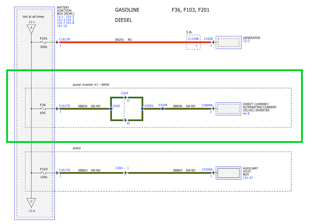

I don't see fuse 36 in the under hood fuse panel.
Maybe not on that list because it's a special high-current fuse? This from the Workshop Manual:
Ford F-150 f150 power points issue HIGH CURRENT F36
Ford F-150 f150 power points issue 400W INVERTER POWER
