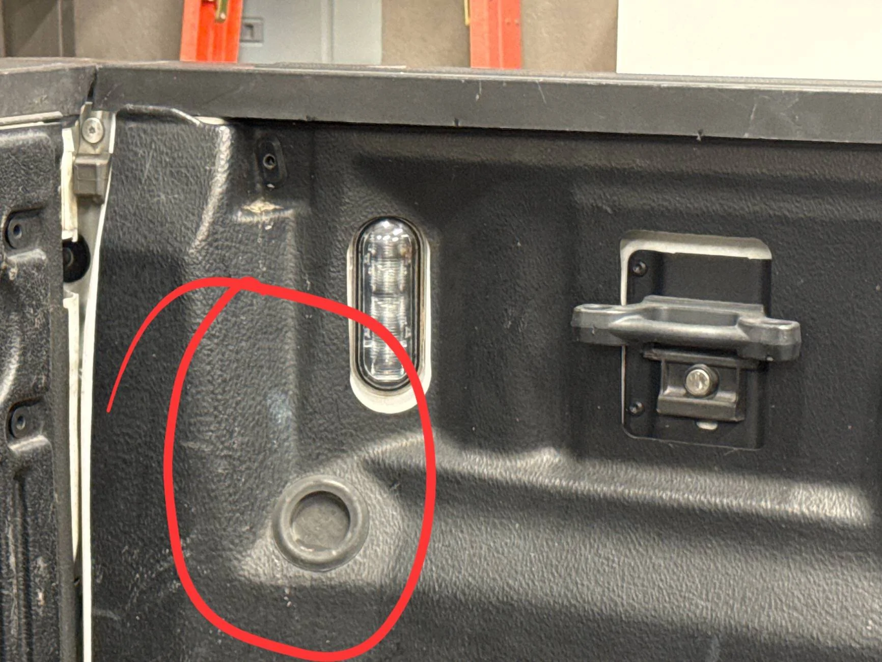

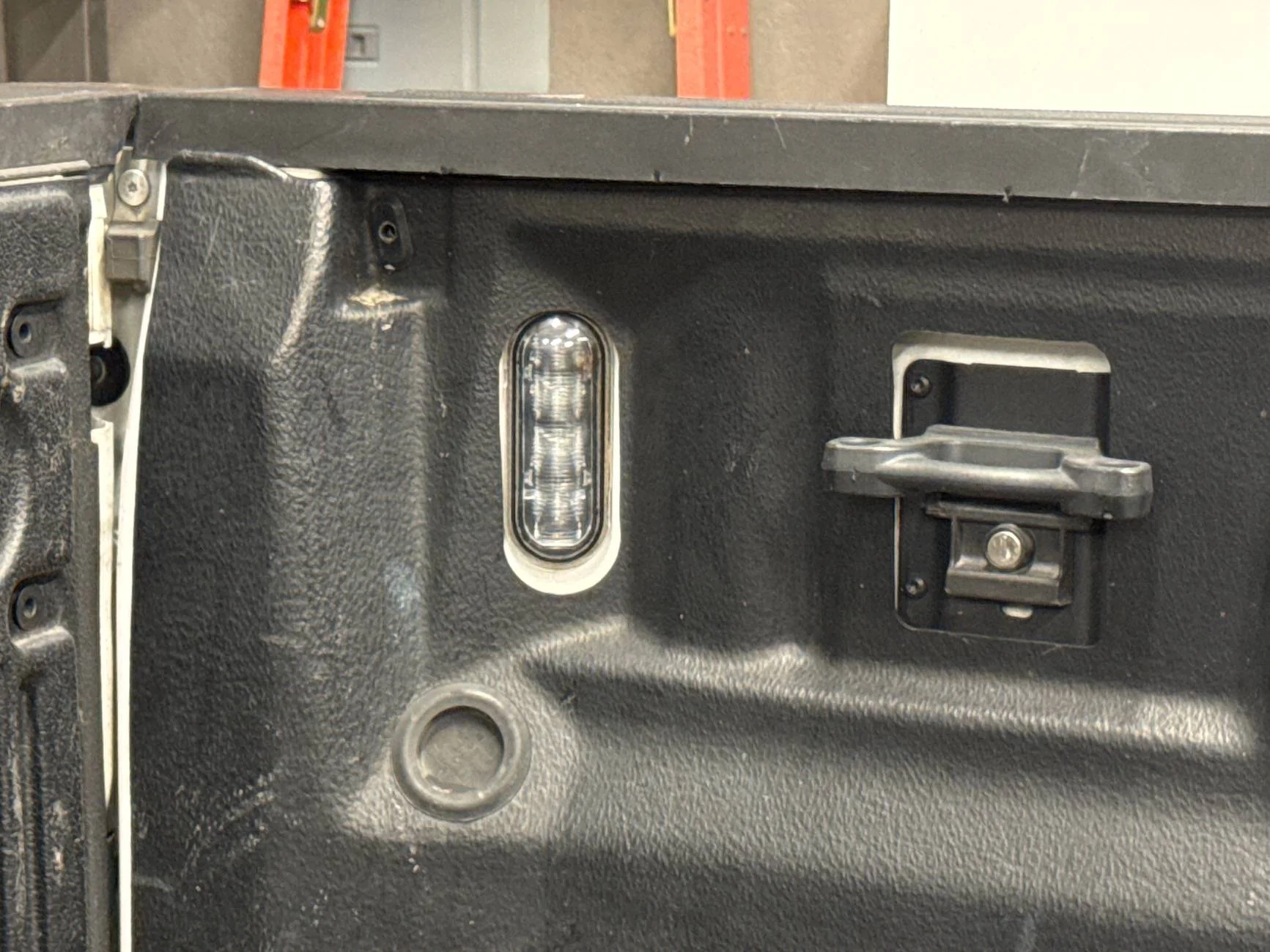

I’ve had this truck over a year and still haven’t figured how to turn these on, 2021 f150 lariat.
Any ideas??

Do they turn on when you press on the switch
The switch must be higher up, I’ve pulled the round cover out the bed liner before but wasn’t anything behind it

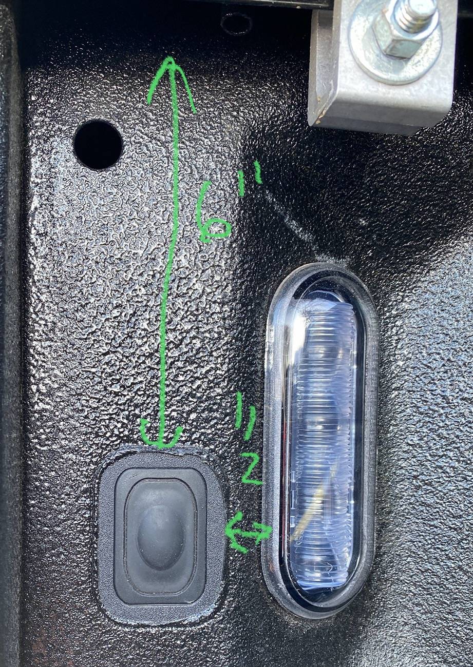

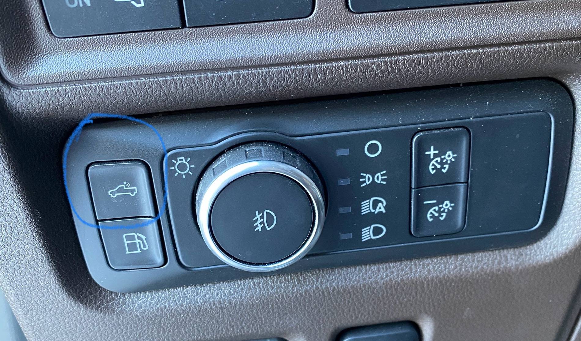

There also should be a switch for the rear cab lights by the headlight switch, that will turn them on also. Peel the bedliner away from the box and you’ll see the switch in the bed.

Attached , In cab switch for box lighting or switch in the box , six inches down from top of box rail and about 1/2 from the light.

Yeah I moved my bed liner and found the switch! Thank you sir
