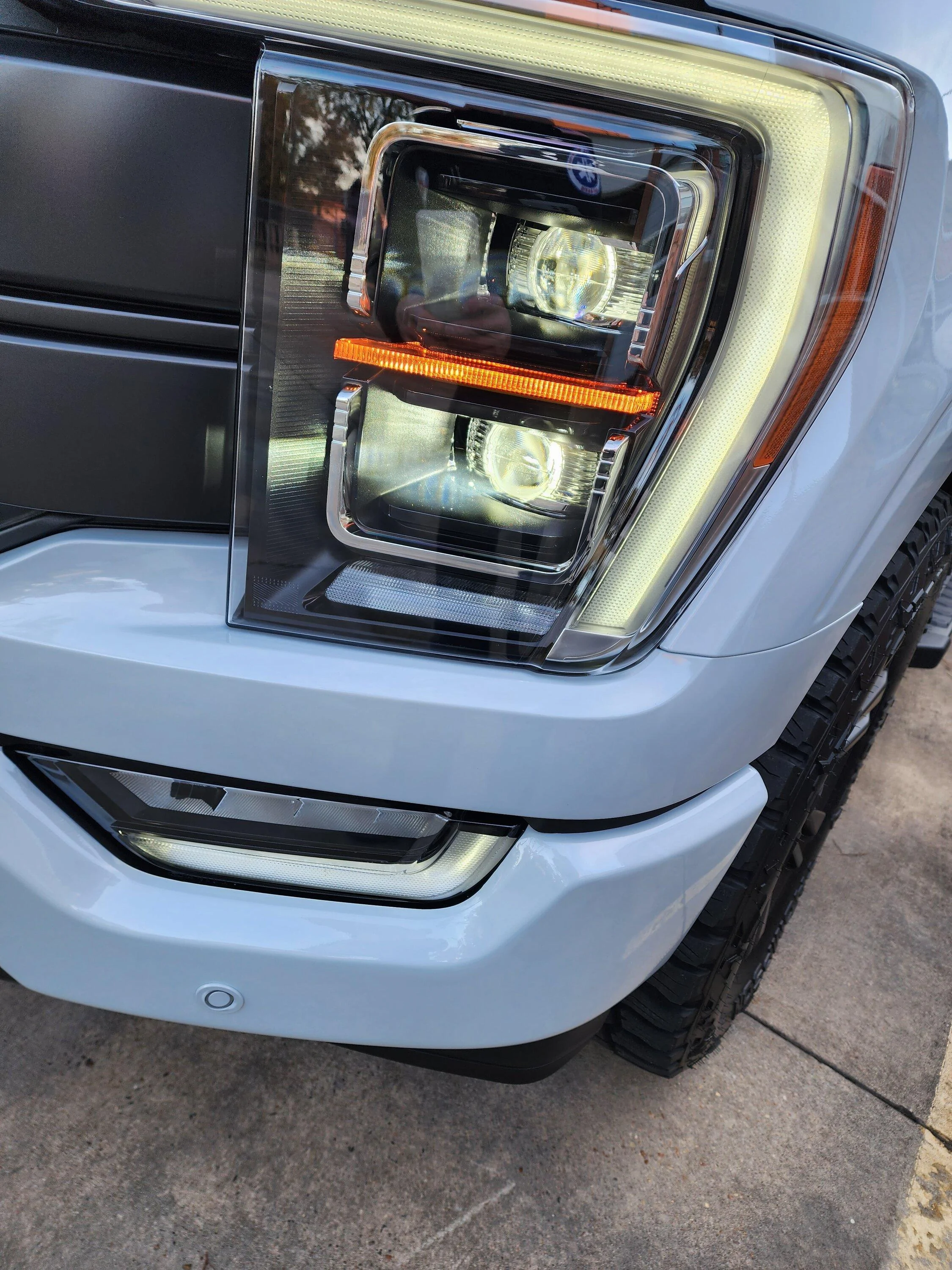

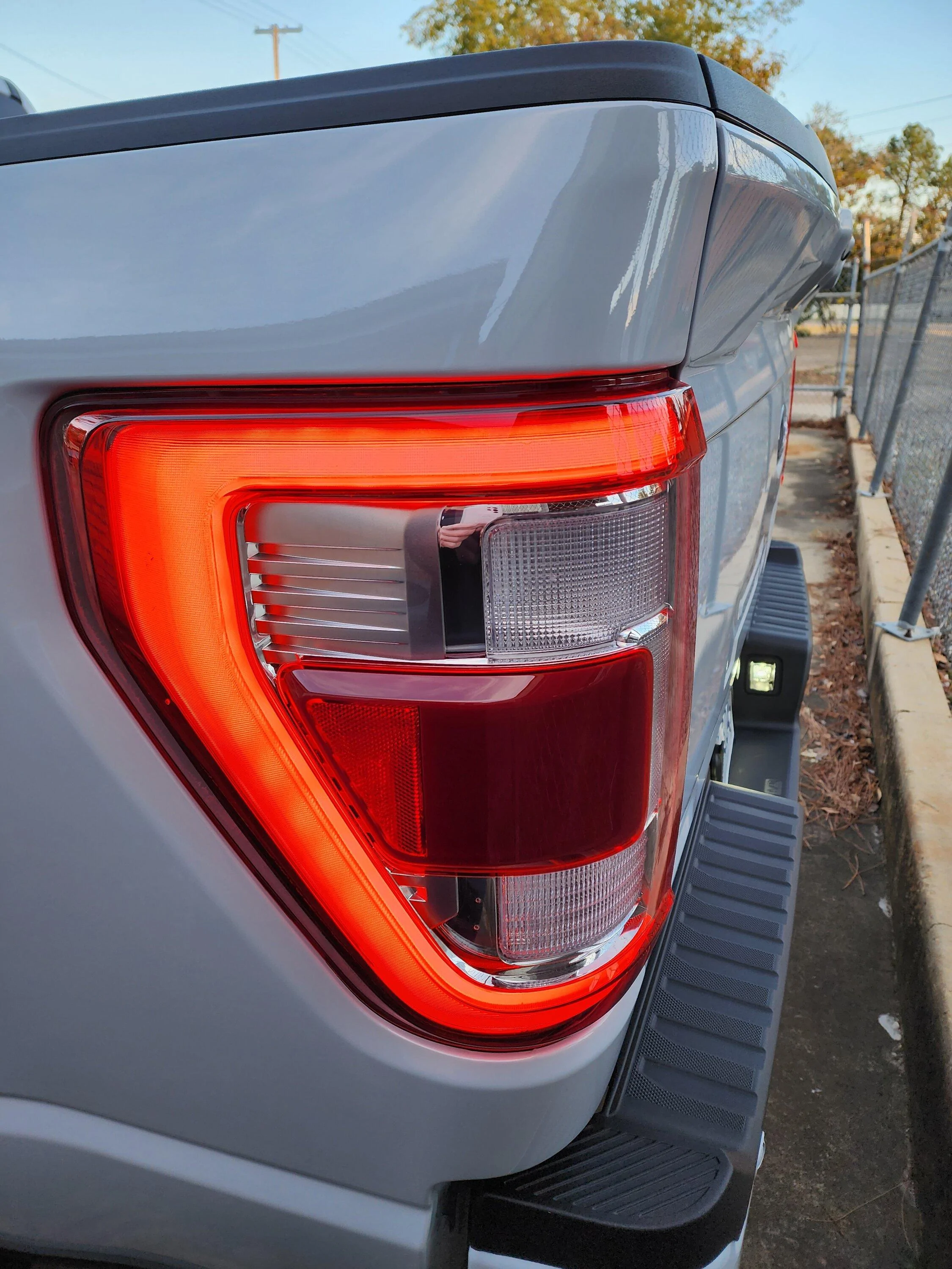

I'm noticing that the exterior lightning incliding mirrors, head lamps, tail lamps, fog lights stay on for a certain period after exiting vehicle and locking it. I also noticed when I had the truck in my garage and closed garage door, exited locked vehicle, lights dimmed to off immediately.?‍♂
Is this because daytime vs night? Garage is dark.

Are your lights set to auto or on?
Ok so. I turned the lights to on then back to auto. I'm not sure what they were on because the light wasn't illuminated until I changed them.
So I always keep them on auto but...I could have bumped it or turned them to in when cleaning. ??‍♂?‍♂

I find when I lock the truck with the button on the inside of the door, all lights stay on for awhile. If I lock the truck with the fob or the door keypad, They turn off much much faster.
