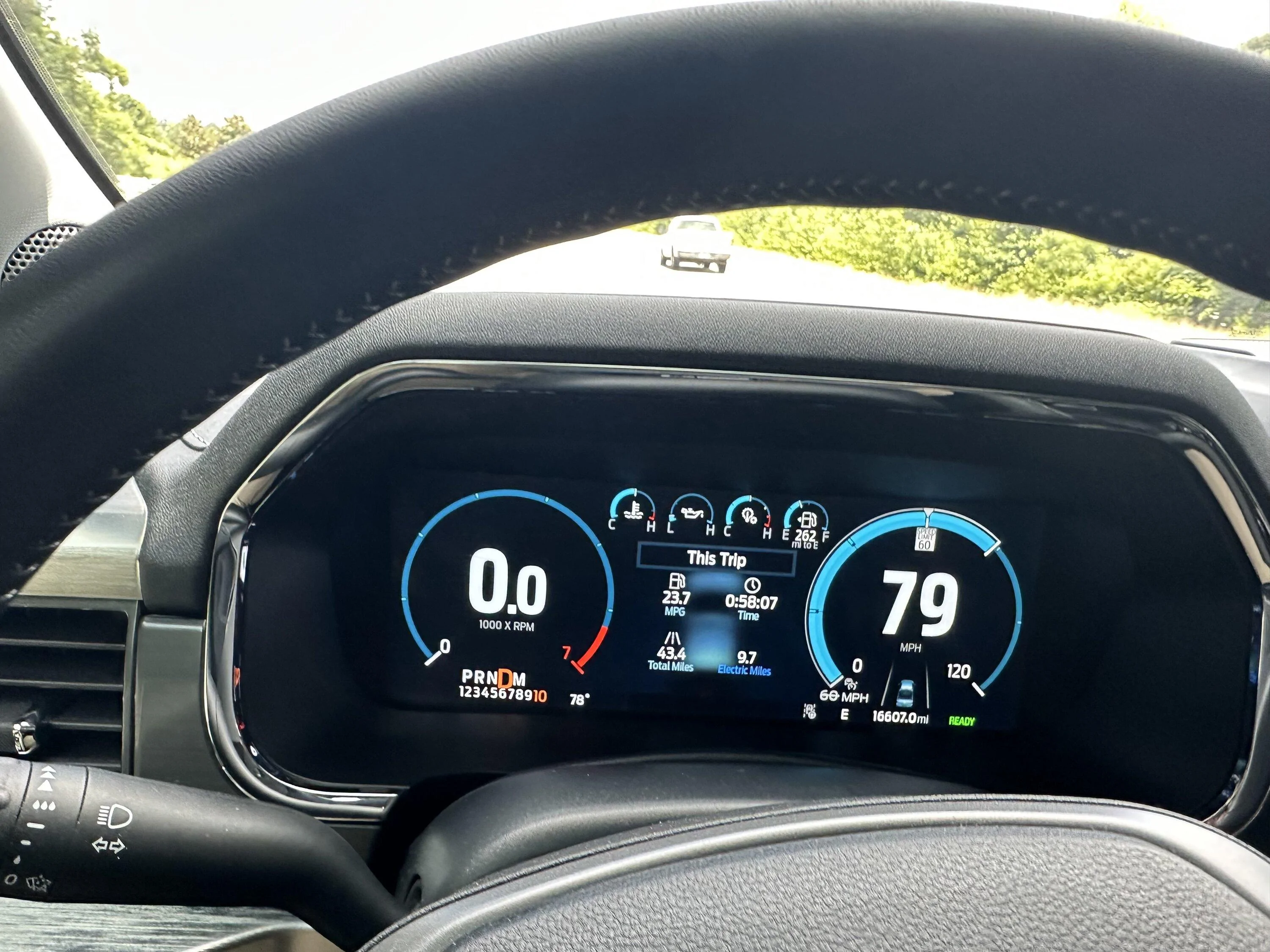

I tried multiple times today in my travels to recreate your scenario and I could not get the ICE to kick on. I was able to top out at the bottom of one of my downhills at 79 MPH. No engine break so I was unable to check MPG. Do you have a pic? Not much help I know but trying. I have read that the system will engage the ICE as an engine break and no fuel is being used as previously stated by @tbinmd and I have experienced the engine break scenario but never checked MPG.

Were you braking here or just coasting? And are you sure your HV battery was at max charge? The EV Coach screen is the best indicator you can get; once the HV battery has been topped off, the Charging bar will get very short.
Apologies if you already know all of this, in case I sound pedantic. ?

100% coast. Very little brake. I am not sure about charge of the battery. I have watched the EV coach previously and will try again. I had another down hill today but used it for a different situation…pushed her to 101?. Couldn’t resist.
No apologies needed and thanks for improving my vernacular!?. Pedantic…
I’ll keep trying as in my travels I encounter many opportunities to coast. THANKS!!!

Someone can correct me if I'm wrong, but I think engine braking only kicks in when you're applying the brake. Otherwise I'd imagine the truck will just let you coast in EV mode for as long as you'd like or up until the HV battery is depleted from electronic draw.
