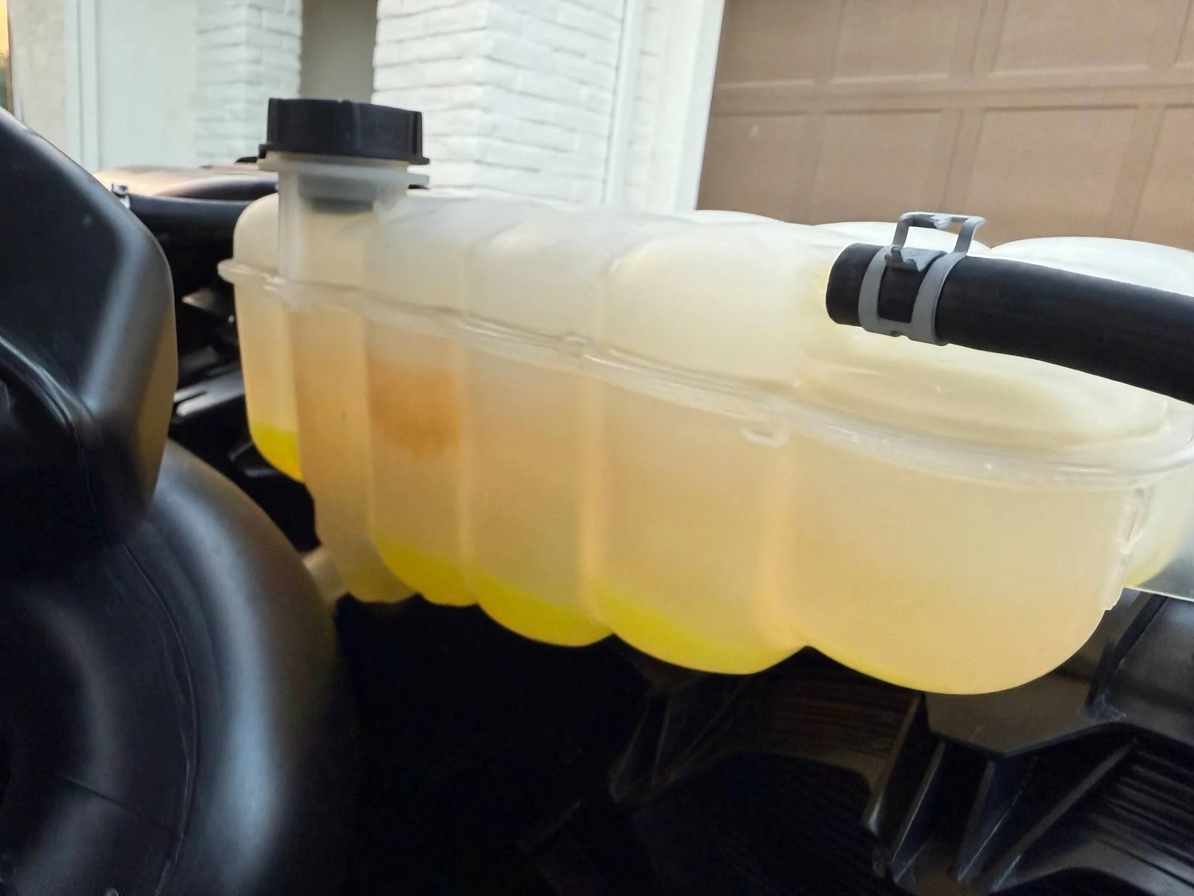

Well, my engine coolant seems to be ALL GONE! On a brand new truck!
Ford F-150 Engine Operating Temperature Concern 7DDBE0DB-79B6-430C-82AC-EA4E42F6D449
But where did it all go ??? Checked under truck and I don’t see any leaks

Holy got damm. I've seen my PowerBoost hit 230° pulling into the gas station when towing and getting off the freeway but that's just NUTS!
"Where did my coolant go" indeed.
Oh yeah, I had a feeling! Mine was low from the factory. Some have reported leaks from the exhaust heat exchanger piping, but I think that’s on a separate loop from the tank you showed? I’d get it to a dealer asap, as least for a coolant top up and record of the issue

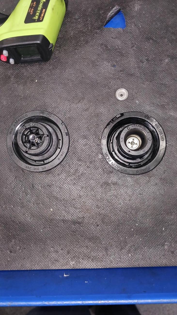

avm916
drew
May 13, 2025
CA
f150
self employed
So I’m late to the party but here’s my experience. Just bought a brand new 2025 f150 tremor 5.0 v8. When I was looking and test driving the truck at the dealer I noticed some coolant spillage is under the hood. I asked the sales guy and he told me that they top all fluids off when they receive vehicle from the factory. It’s supposedly the protocol. I didn’t much of it and figured it’s normal. The clans tank was full. Drove off the lot and when I got home there was some coolant spillage but a tiny bit. Still didn’t think much. On day 20 of ownership, I pull up home at night, my wife gets out of the truck first and panics says “something is pouring out of the truck” sure enough it was coolant. Next day I drive to work, parked and noticed more leaking. But, before I could even park I turned on detailed info on dash and noticed that as soon as I turned into the parking g lot the temp started to climb. Usually it rat 187-193F but this time it very quickly started to go past 200F. So I took the truck into the dealer right after work which is luckily 2 min drive away from my work. They diagnosed it and found that a wrong expansion tank cap was installed at the factory and the valve that was from a 3.5l economist was installed on my 5.0l v8. Anyway, picked up my truck today and everything seems good.
Ford F-150 Engine Operating Temperature Concern IMG_3506
Ford F-150 Engine Operating Temperature Concern IMG_3507
Ford F-150 Engine Operating Temperature Concern IMG_3454
Ford F-150 Engine Operating Temperature Concern IMG_3464
