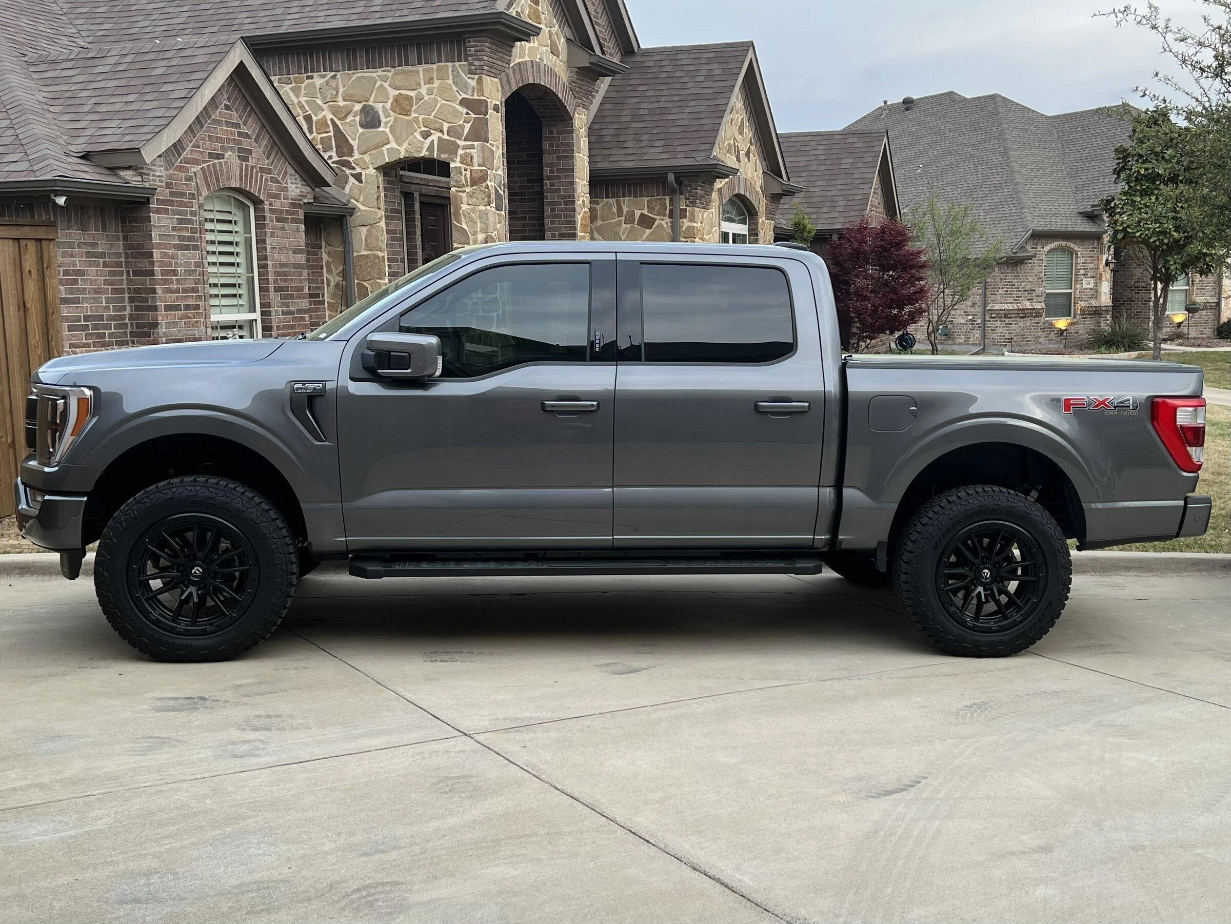

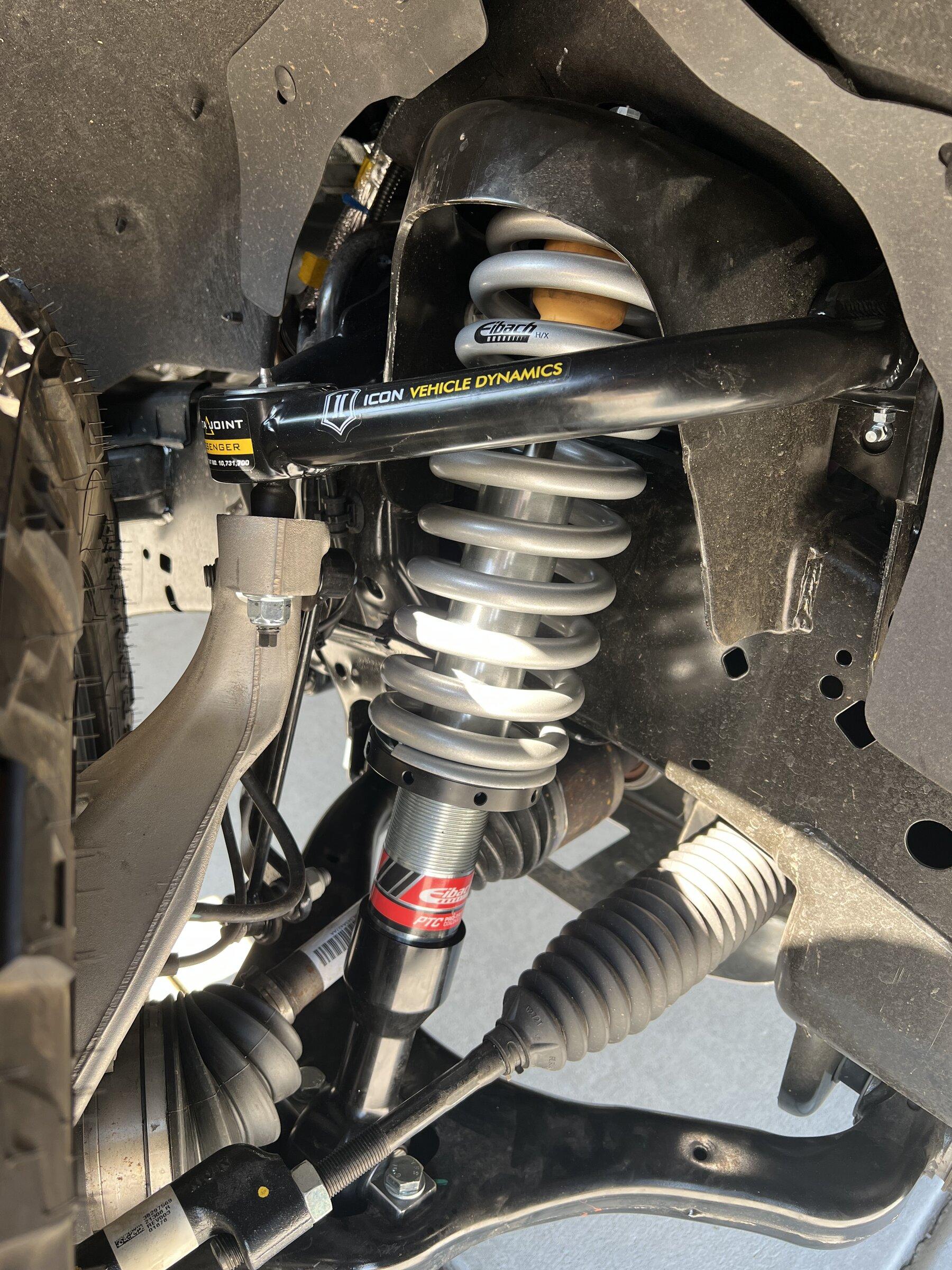

I like the way this front suspension handles. Maybe slightly firmer than stock, but not rough.
I also have Airlift bags in the back to add a little rake back. I had 295/60/20s, but they rubbed more than I liked. I went back to the stock size, 275/60/20, with an all terrain and I think they look ok.

It looks great. Do you think the upgraded UCAs are necessary with the stock tires?
Did the eibach coilovers raise the front a little above level?

I have the Eibachs on mine and see no reason to install aftermarket control arms. But…I have mine turned down an inch from how they come from Eibach, so it’s closer to a 2” level than a 3” like OP has.
