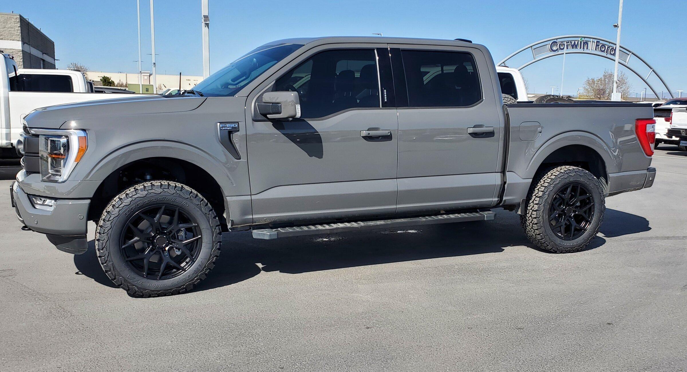

Icon Stage 3 suspension installed

I saw that today. I haven't had any issues but I also have less than a hundred miles on it.
