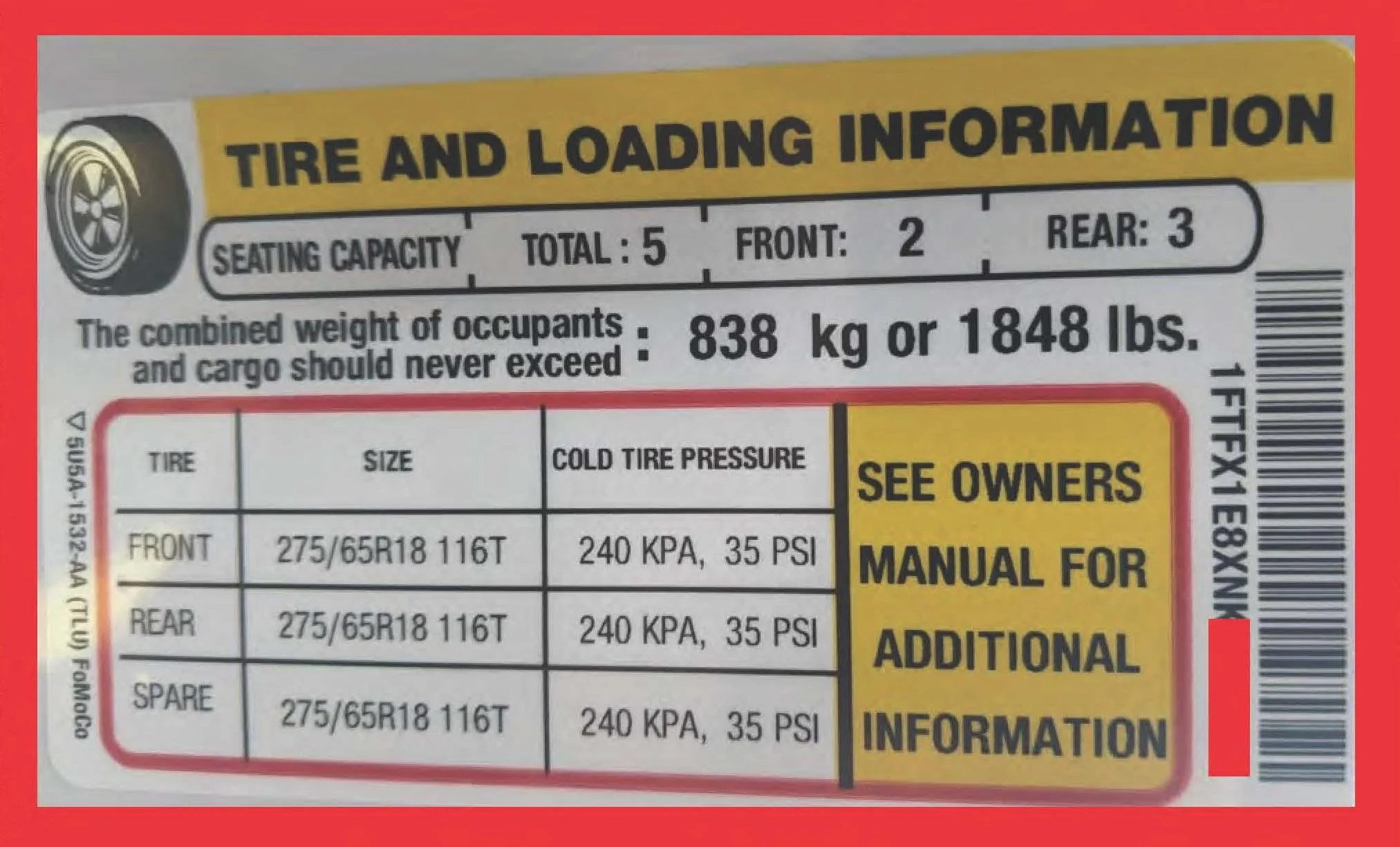

My truck is a 2023 F150 Tremor V8.
I'm trying to track down my payload (mainly the bed) max, as well as my towing max.
The only sticker I found in the door had the following info....
GVWR: 7050
Front GAWR: 3600
Rear GAWR: 3800
I missing the weight of the vehicle, as well as what it can tow.

If you don't have the infamous yellow sticker, you can open an account at ford.com, input your vin and there will be a link called vehicle dashboard. On that page, will be a link to a towing calculator. Your truck's payload and towing capacity will be there.
Beyond that, I'd ask your dealer about getting a replacement.
Yep, keep looking or contact your dealer - this sticker is required by law on F150 class trucks:
Ford F-150 Easiest way to get to my Payload and Towing Numbers? Payload
The combined weight of occupants and cargo should never exceed: xxx kg or xxxx lbs. is the 'VIN-specific payload' for your truck equipped as it left the factory (do not subtract the weight of fuel from that, it's already considered; do subtract the driver's weight from that, the driver is an occupant).
Your vehicle curb weight technically is the GVWR number from the other sticker minus the payload number from above (may not match exactly what you get on a CAT Scale but will be very close).
There is no 'sticker' showing your towing capacity, you must derive that from the applicable Trailer Towing Guide.

Old eyes, and moving too fast, and I missed the all the info on what I thought was just the "Tire Pressuer" sticker!
I'm at 1544 lbs for the "should never exceed" amount.
I will have to spend some time Trailer Tower Guide link....that's going to take a bit of reading to figure out what my max tow capability is.
Thanks for all the info.

Take that time and read more thoroughly than you did the tire pressure sticker (gentle 'gig' in good spirits ;) :) (y)).
There's a wealth of good background information in there and a section on frontal area limitations that's missing on the mentioned shortcut webpage towing calculator.
In my defense, I didn't have my reading glasses!!! :)
But as soon as you posted that pic with the tire pressures, I was like....D'oh!!!!!
