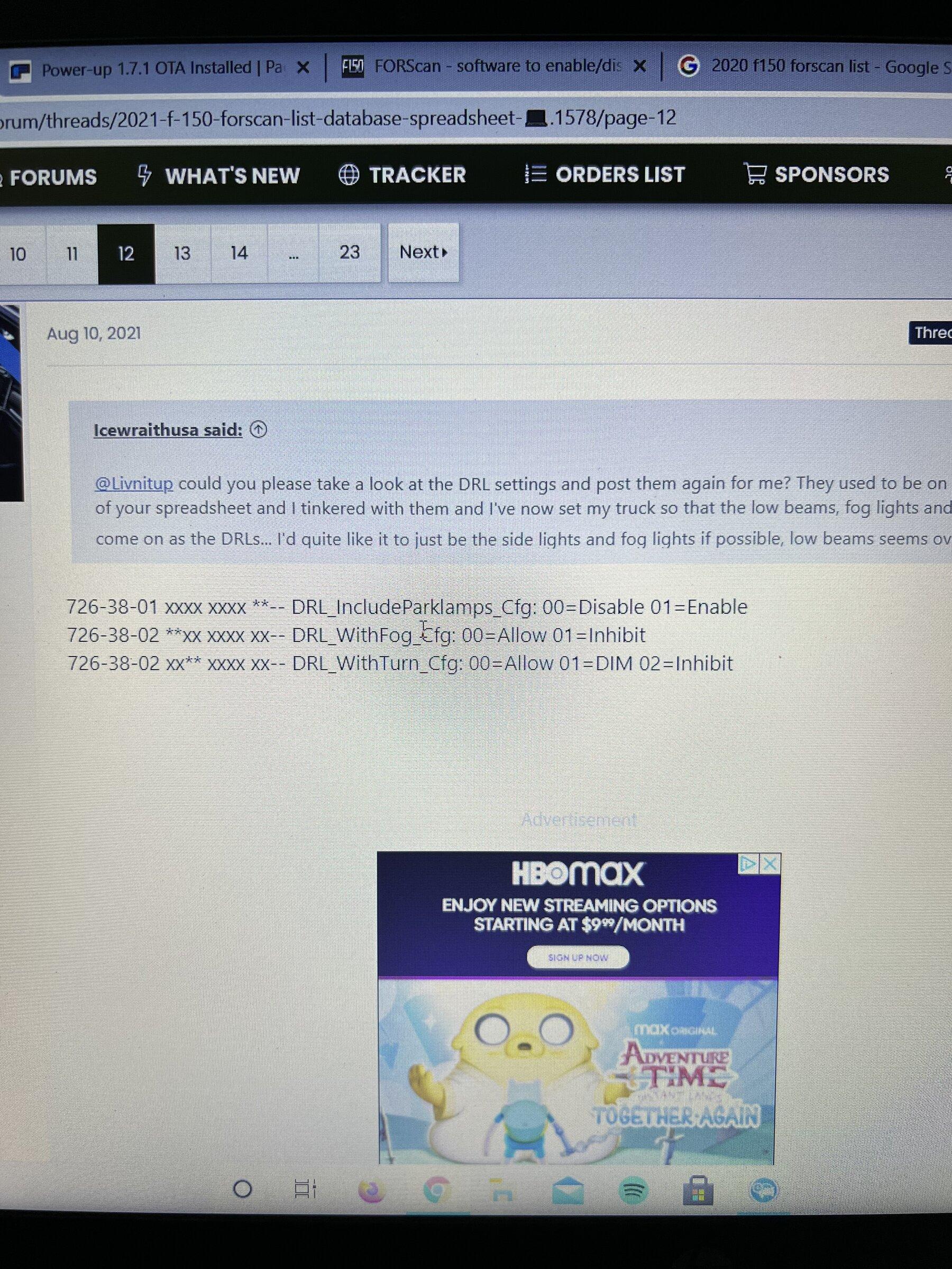

Did you change the “2”s that are in that line? Make sure you’re using BCM (As-Built), scroll down until you find line 726-42-01. Then the as-built numbers in that line, just change the numbers where the “_” is on the line, that’s it. Don’t write the complete line and do not change anything that is in place of the “x”. (do not write the “x”s).
Well sometimes I have to step away for a day. It worked as described this round.
