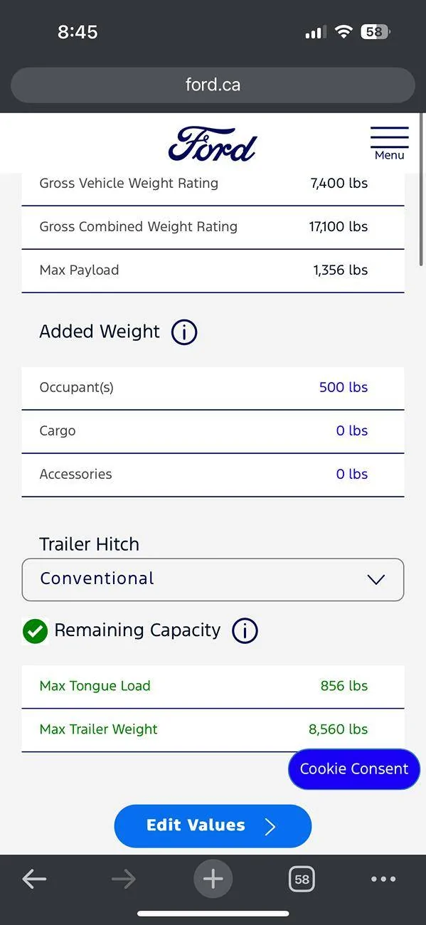

I just traded my ‘21 XLT PowerBoost for a ‘24 lariat PowerBoost. The lariat did not have trailer tow package but since it is a PowerBoost it already has bigger rear axle, frame and more leaf springs from what I can tell from reading on this site. The tow package for 1500$ would have given me bed scales and a manual trailer break.

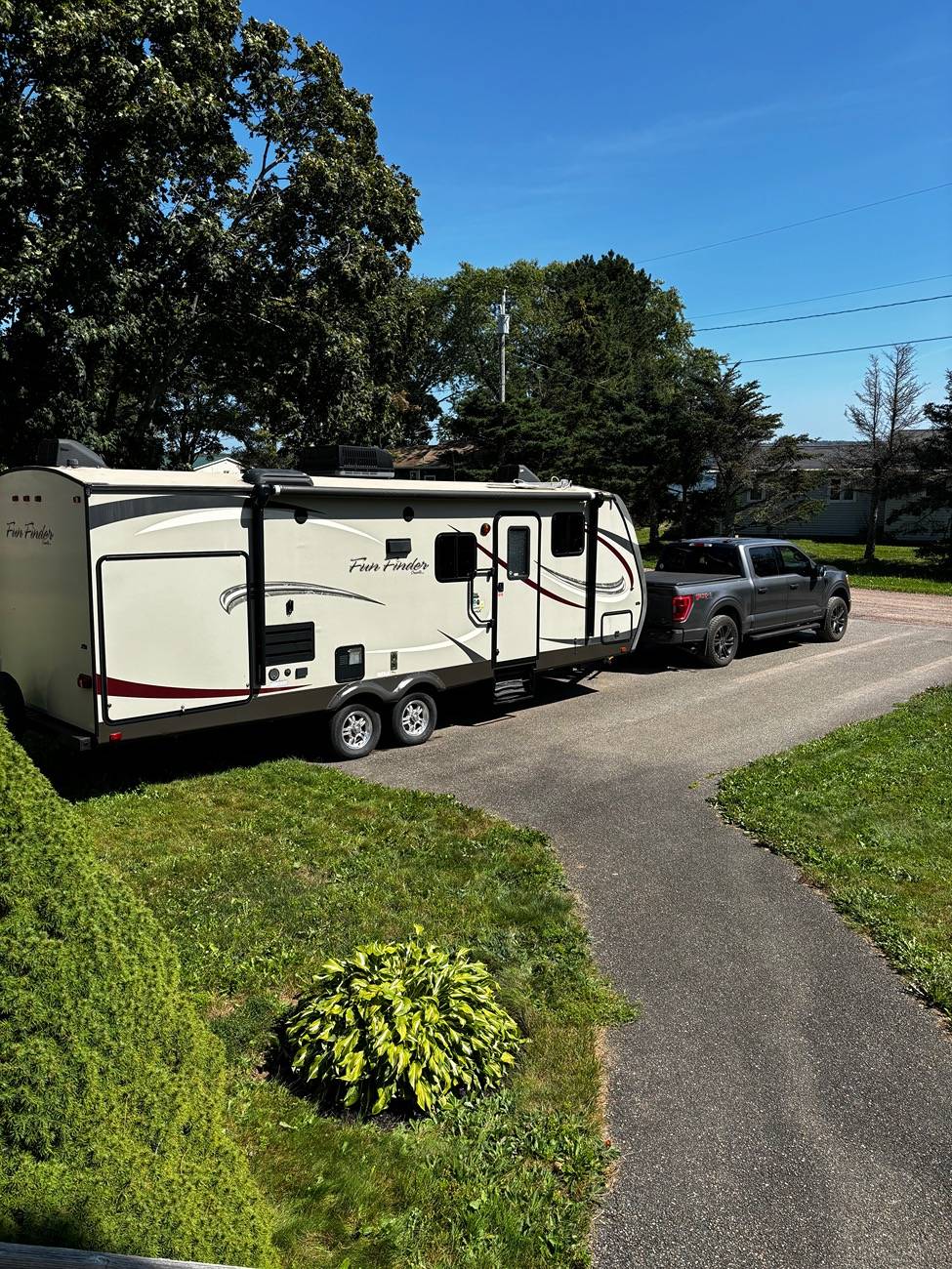

I don’t need the scales. I don’t tow heavy things that often. However I do tow my mother in laws camper (28ft, GVWR 7485lbs, tongue weight 485lbs according to the manufacturers specs) a couple of times a year for her to storage and to campground for the summer. Usually only and hour or two away on Flat east coast terrain.
My new truck has 7pin wiring harness and from what I’ve read the trailer brakes will still activate when I brake with the truck brakes. With my ‘21 that had the manual trailer break controller I never used it.
I can get the trailer brake controller added for about 600$. And I have no problem doing that if that it what is needed/ recommended. However I am new to towing anything that big and am wondering if I am using the manual trailer brake wrong and should be using it more or is just the automatic breaks that come on when the truck brakes good enough for what I do?
Can someone with more experience please educate me?
Attached are pics of trucks towing / payload numbers and a picture of trailers numbers based on manufacturer specs. Also these numbers would be assuming max payload of the camper is being used which it is not it’s fairly empty.

  1. Even with a 7-pin connector, if you don't have a trailer brake controller you have NO trailer braking.
  2. Most (all?) jurisdictions, both US and Canada, require operating trailer brakes with a GTWR over ~3-4k# (certainly on a trailer that size). Yeah, it's unlikely you'll get caught without unless something goes wrong (BTW, Canadian penalties for this sort of violation tend to be more rigorous / severe than in the US).
  3. The truck's brakes alone are not designed to stop the whole rig, especially in a short distance / emergency situation.
  4. IMO prudence dictates having a proper trailer brake system when towing something that big.
Yes, I'd get the truck properly equipped for the infrequent task. And I'd counsel you to take the time to read the instructions and get the controller properly set-up for the rig, especially as a new-to-towing driver.
