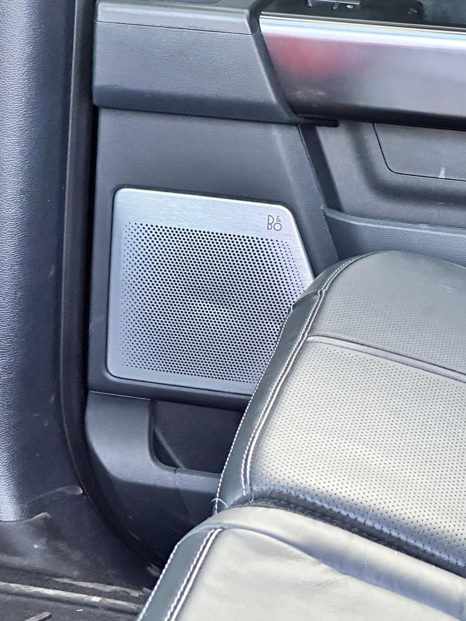

Hello, my back speaker got dented. Any advice on the fix?
Is it a speaker replacement? Panel replacement? Or am I SOL.
It's dented pretty bad. Hard to tell in the photo.
Ford F-150 Dented speaker IMG_2815
Thanks!

Should be able to just order grill cover. Not sure.

You can buy just that cover
Msrp
18 speaker $55
8 speaker $45
let me know if you need the part numbers. I work at a ford dealership in the parts dept.

Pop the grill out and use a small ball peen on the back side to lightly tap the back side and straighten it out. Place the grill on a flat surface and gently tap a few times on one side then the other side of the dent working towards the center.
