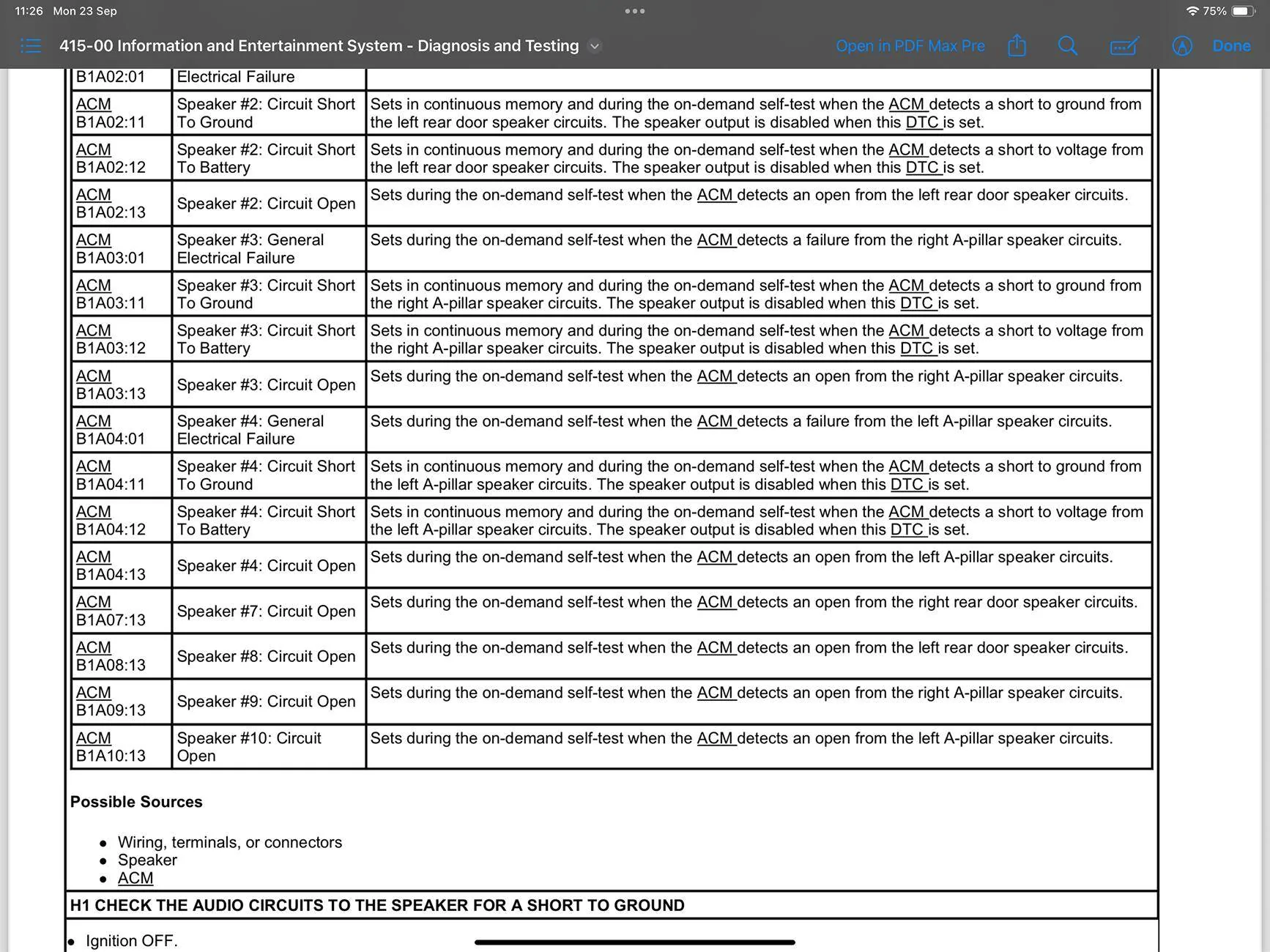

The ACM on my 2023 F-150 is reporting a bad number 7 speaker. This is the 18 speaker system. The problem is I can’t figure out where speaker number 7 is. Does anyone have a diagram that identifies the speakers or know where speaker 7 is located?

Note: I was not the original person who found the info, I just saved the document for future reference. It's in the workshop manual section attached. Go to pinpoint tests H and I for all the location detail; also attached is a pic showing speaker 7 location on the ACM.

This is perfect. Thank you!

By the way, other pinpoint tests could apply, depending upon the DTC reported. You'll find the right one at the beginning of the doc; it's "like" an index.

It’s a B1A07:13 DTC, Circuit Open Error. I’ll read through the document but sounds like a bad connection or failed speaker.

#7 = RH rear door -- typical speaker to blow
