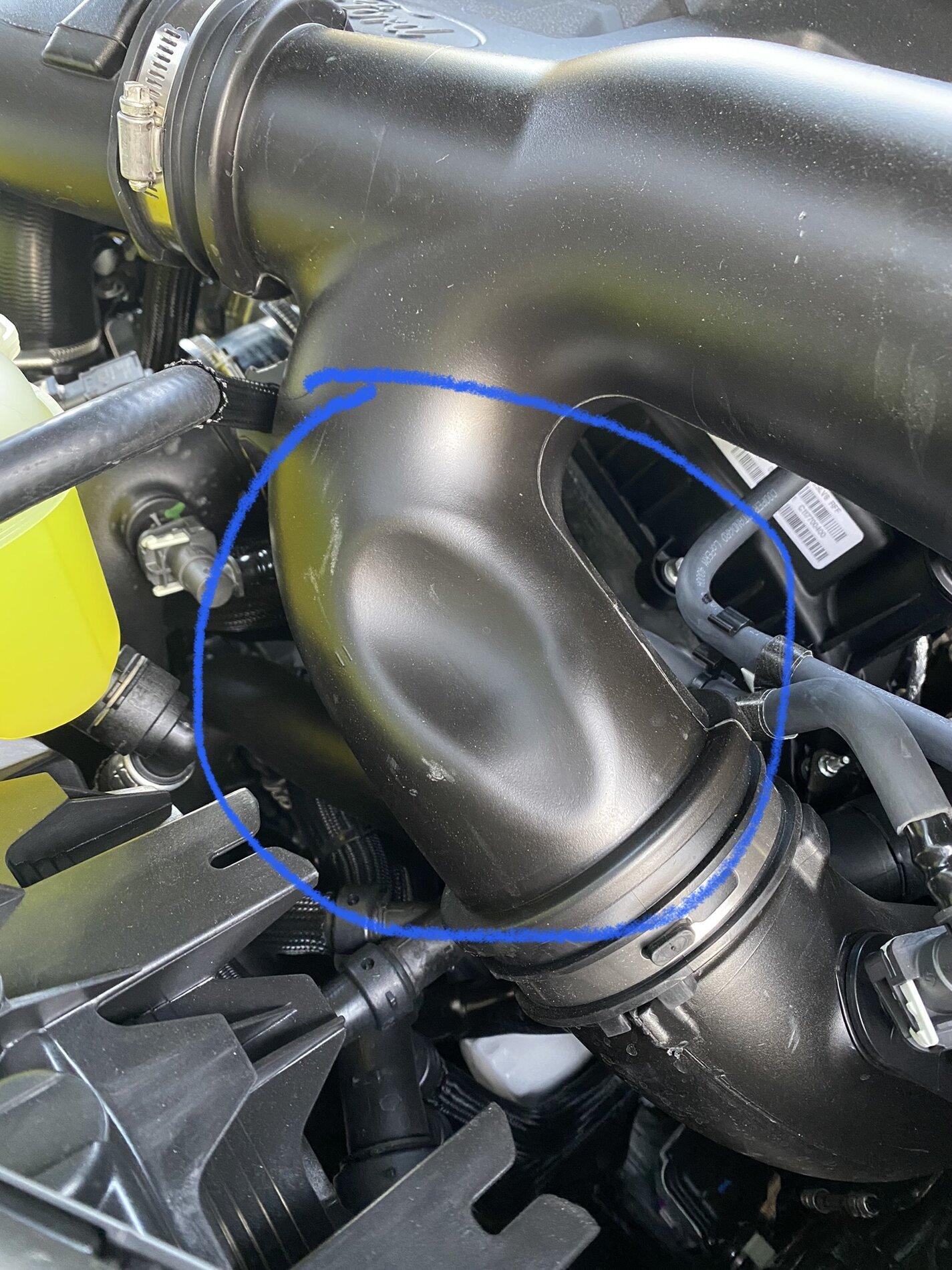

Dent In Air Intake Tube or Normal?

Thank you all! That began to scare me a bit! Glad that it appears to be normal!

It’s true. It looked like it could be a design characteristic, but I wasn’t sure. I could also see something in the engine possibly getting really hot and melting the tube at that point.

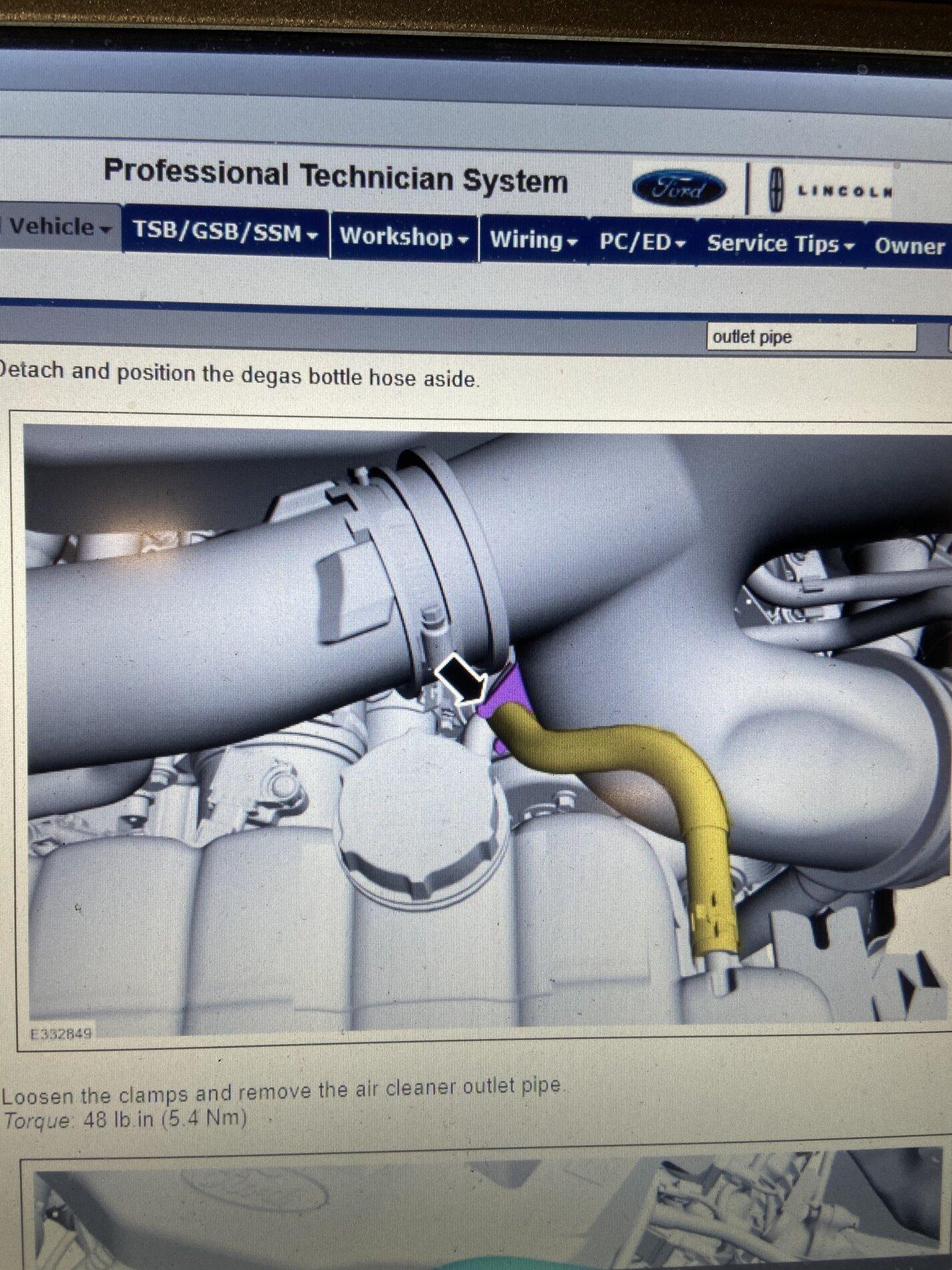

All 3.5’s have this dent. It’s because the PB,s have another coolant tank that sits right there. Check PB engine photos.
Great to know. I’m glad it’s a PowerBoost design. The coolant tank on the EcoBoost engines seems pretty for away from that indent to need it.

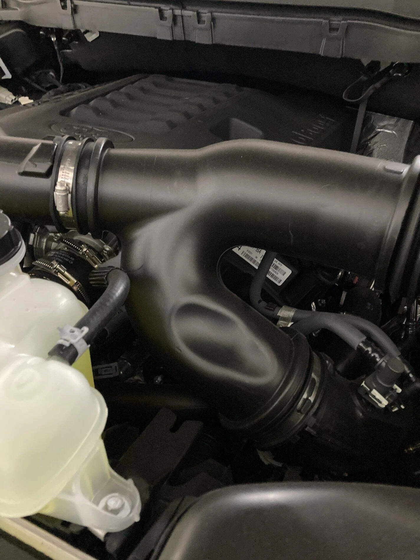

For anyone else concerned, here is further confirmation this indentation is normal.
The engine bay of a new F-150 with the 3.5L V6 EcoBoost engine. You can see it has it too.
Ford F-150 Dent In Air Intake Tube or Normal? 0BBE1899-11D1-4FFE-B996-63BCA57F2194

For those keeping track, here is a photo of the engine bay from a PowerBoost. You can see it has an extra coolant reservoir right about where that indentation in the intake tube is. Case closed!
Ford F-150 Dent In Air Intake Tube or Normal? 582EAE9A-4B49-4287-A627-B1A228DC6A72

3.5 liter EcoBoost V6 on the top picture, 3.5 liter PowerBoost Hybrid V6 on the bottom picture:
Ford F-150 Dent In Air Intake Tube or Normal? CCFB695E-C5C6-48E0-8689-B29C5E7CCC6F
