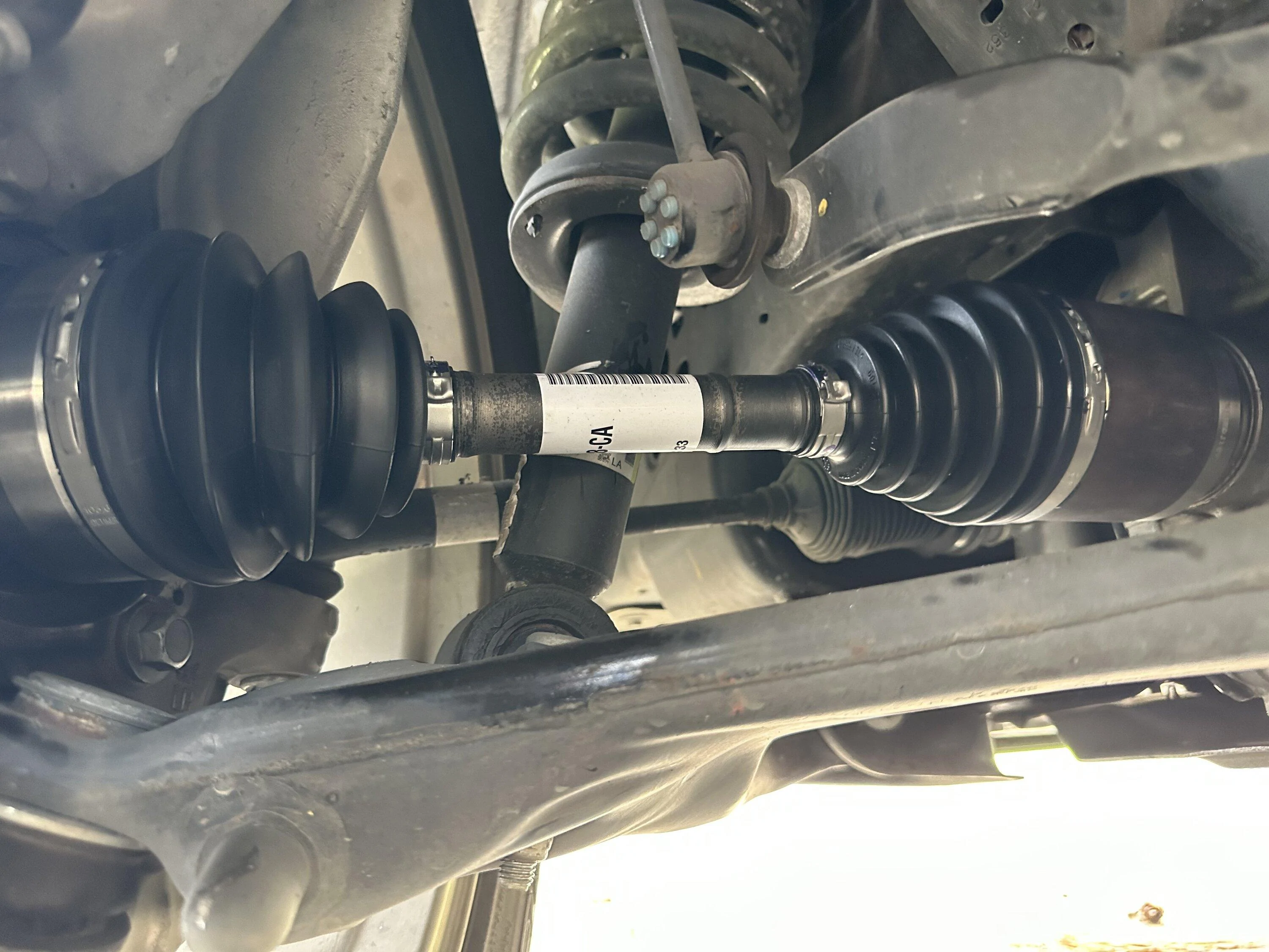

Hey guys i was just looking under my truck and saw a spot that might look like grease/oil on the CV axle connecting to the wheel hub. Is this cause for concern?

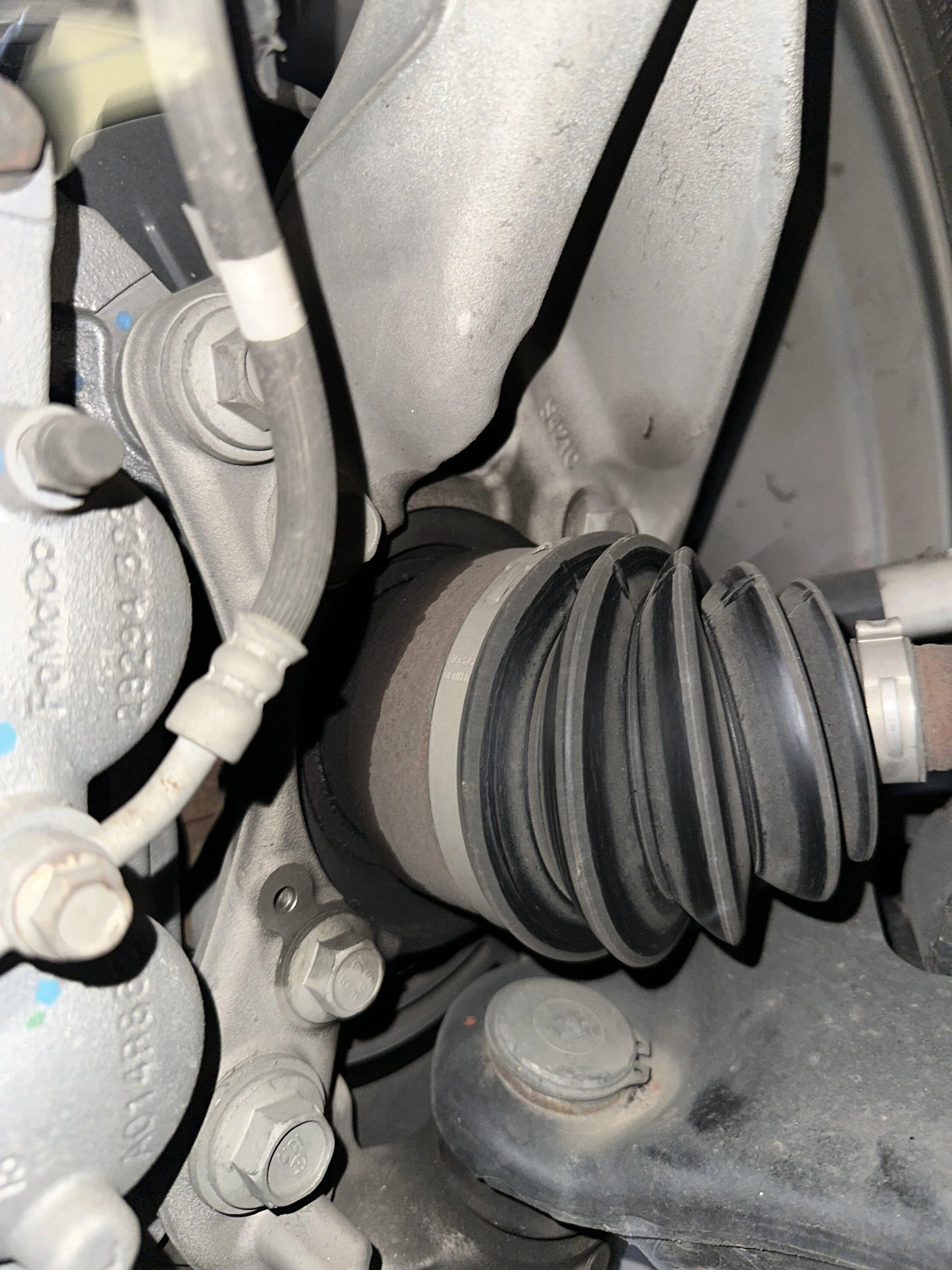

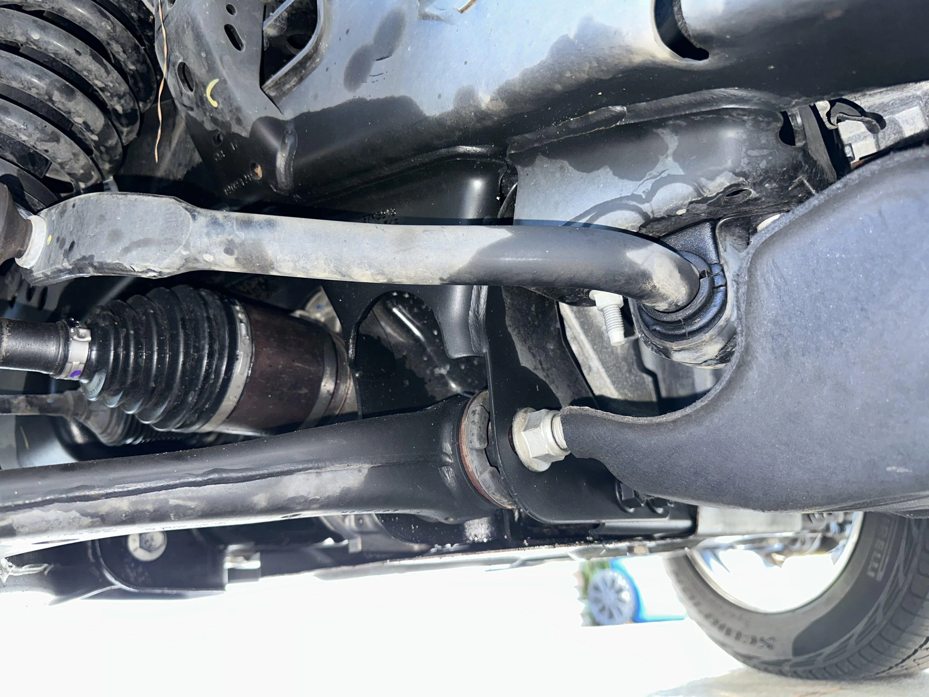

Just found the same. Passenger is a little worse than Driver. Have appt with dealer JULY 20!!! Actually have 3 issues. Slow leaking coolant and camera/adaptive cruise/collision assist failure. Not a lot of help but sharing. My oil change guy is solid and he noticed and stated it needed to get in.

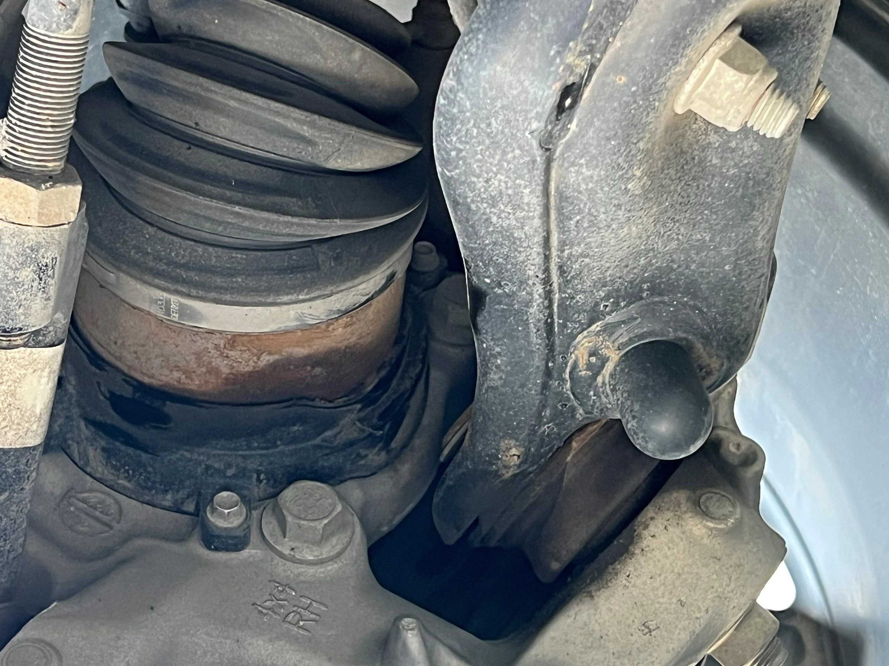

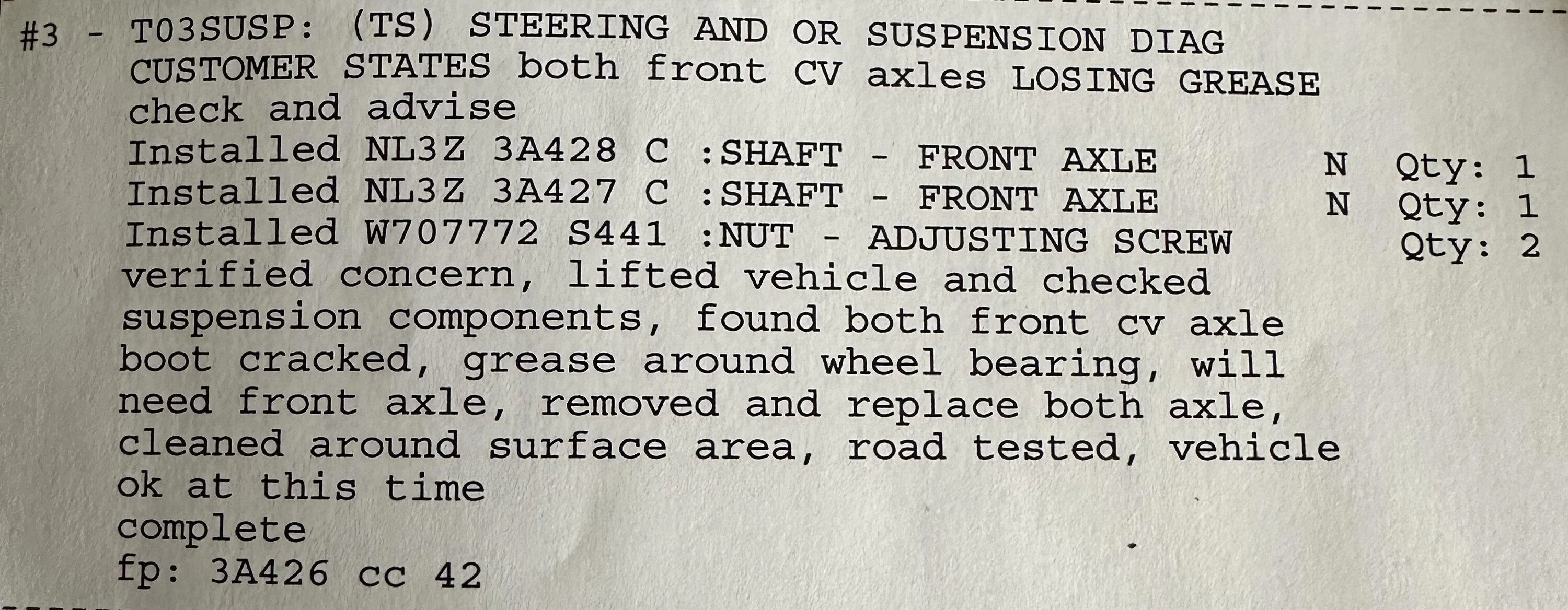

Replaced under warranty. Glad my oil change guy alerted me.

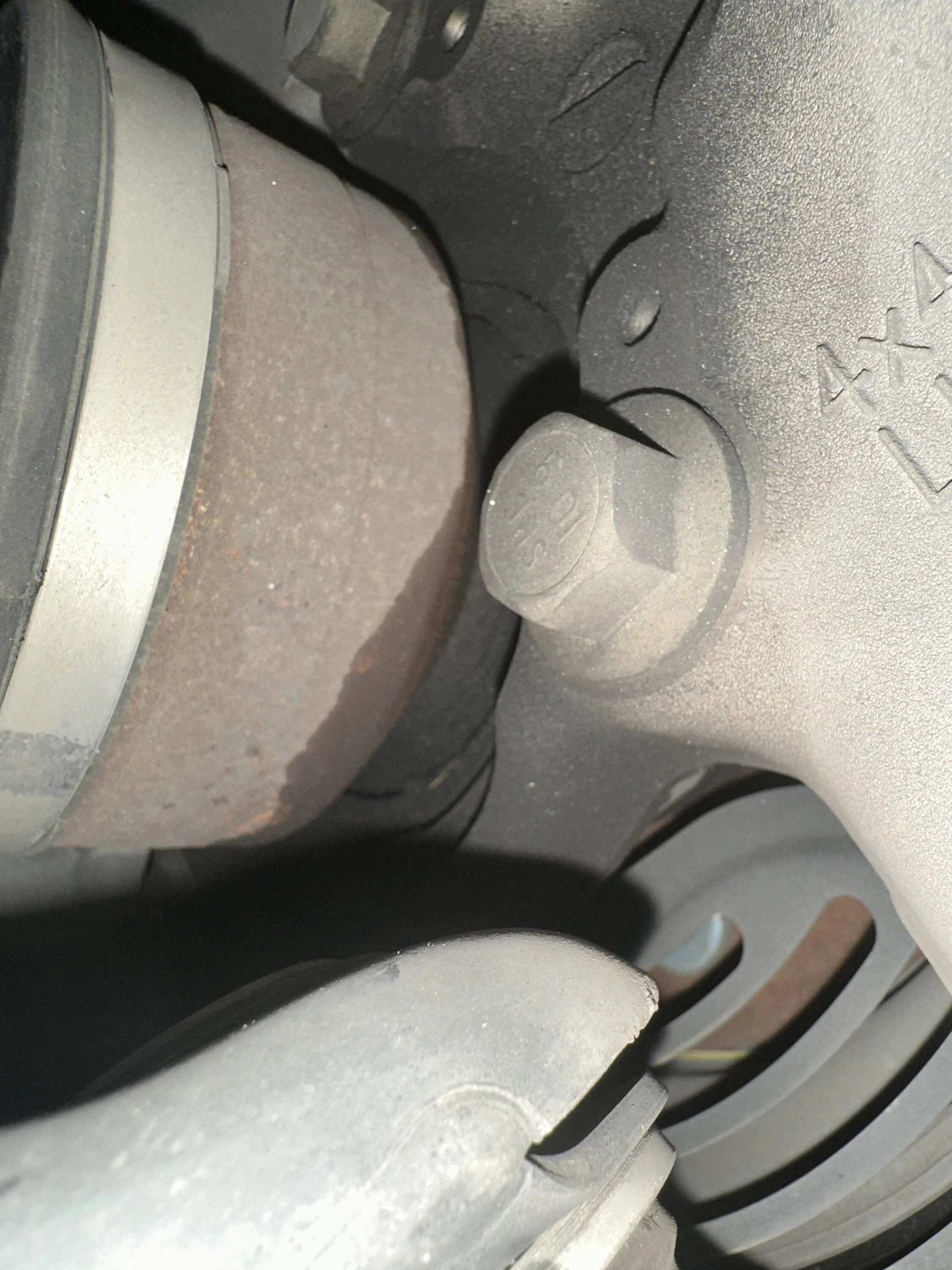

I should have added what new looks like for reference…
