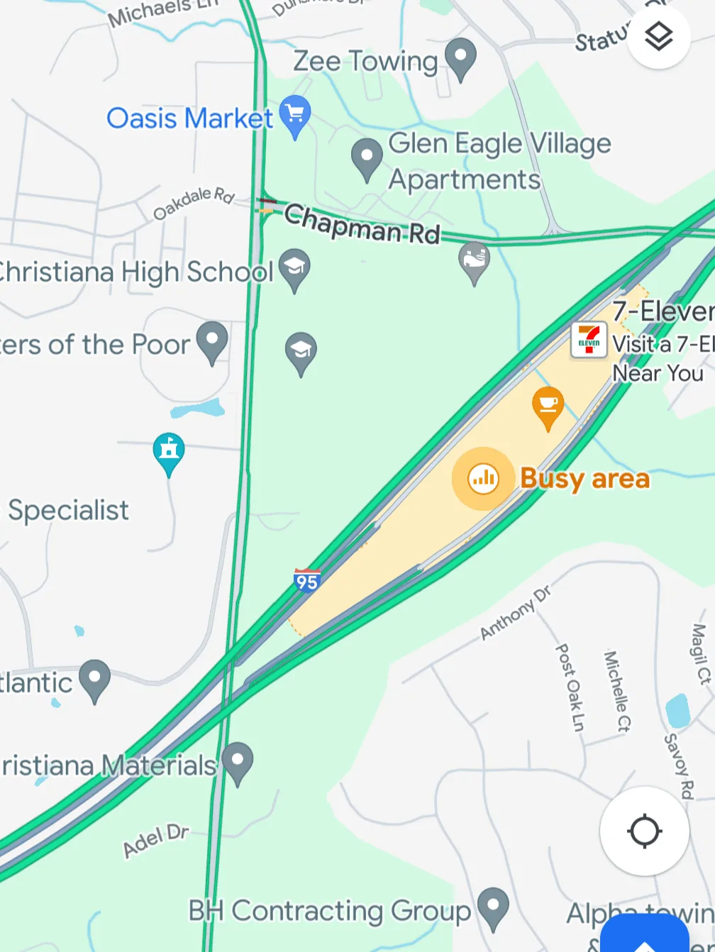

Yes, speed sign recognition uses both visual and geo-location markers.
Recognition is something you like or hate. It isn't perfect and the geo-location markers are sometimes a PITA. Worse case I've encountered with recognition was driving on I-95, service center was located between the highway lanes, the exit speed was 35, the truck saw this sign and hit the brakes hard. Fortunately no one was behind me.
