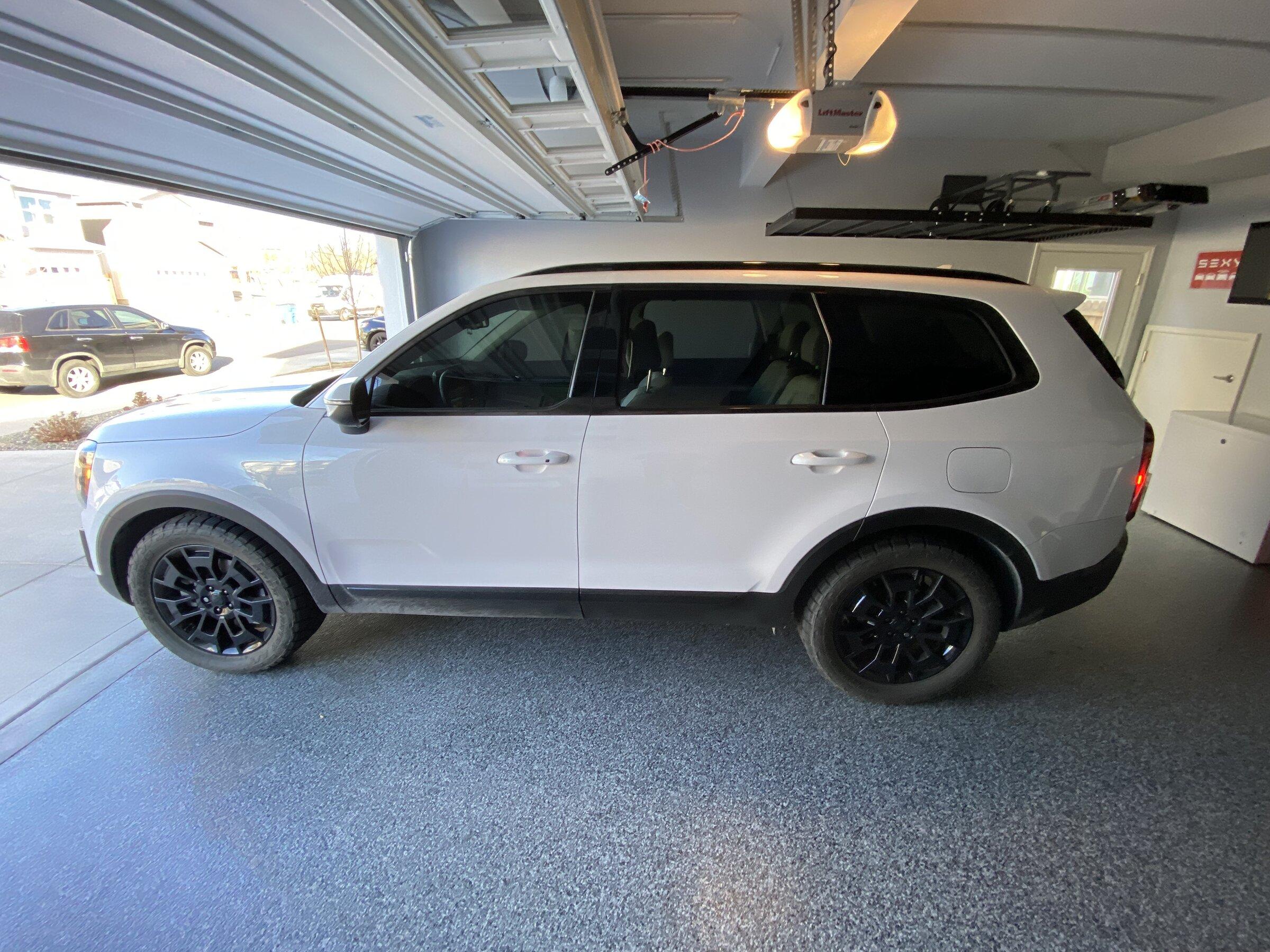

I wonder why it only rubs in reverse. Our telluride does the same with big tires, only in reverse.
Please post some photos of the Telluride with big tires!
If I hadn't needed to get a new truck for work, that's definitely the route I was looking. They look awesome!

They aren't actually that big, and this is a bad pic but here you go. I was actually going to go down to 17" and get bigger sidewalls but decided not to at the last minute because the cost of the level and the wheels was a lot.
