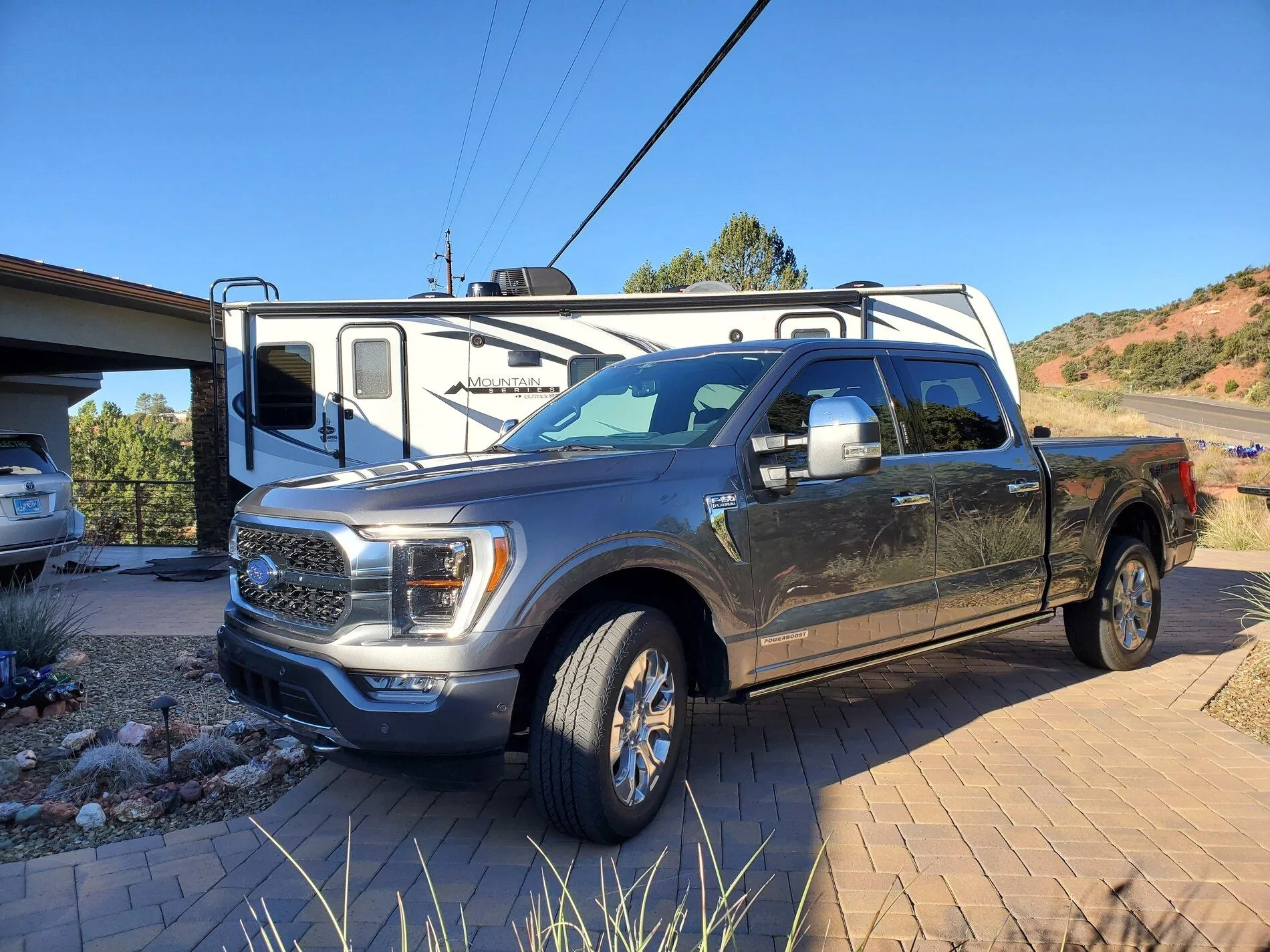

You are correct mine with crew cab 6.5 bed comes in at 1344lbs. I will have to get an accurate tongue weight, dry the specs are 720lbs but with two propane tanks I rounded up to 800lbs. I always tow dry but if I did add water the tank is behind the wheels. It is close so will try and get that good read on the tongue weight. Thanks for pointing that out.
