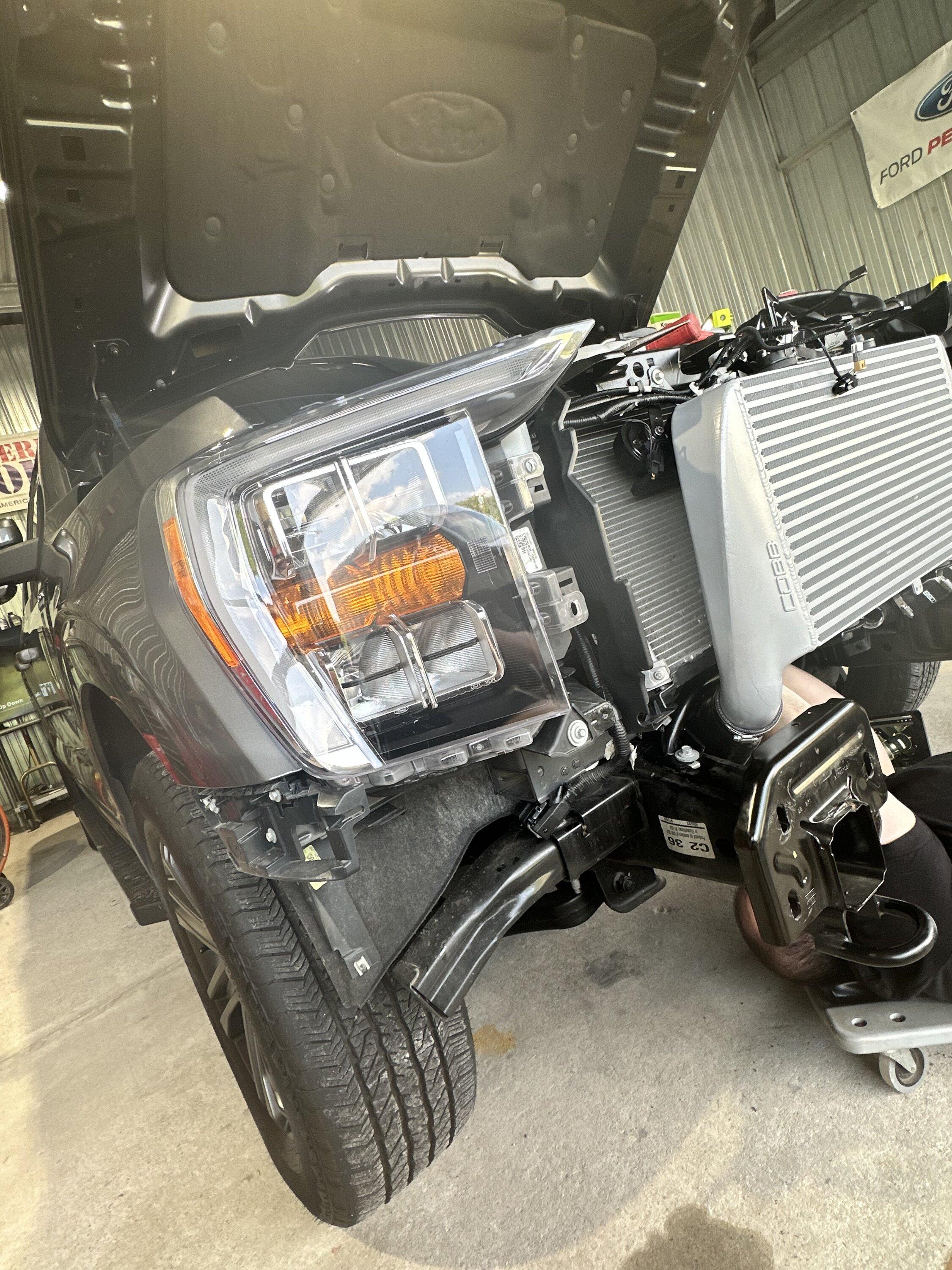

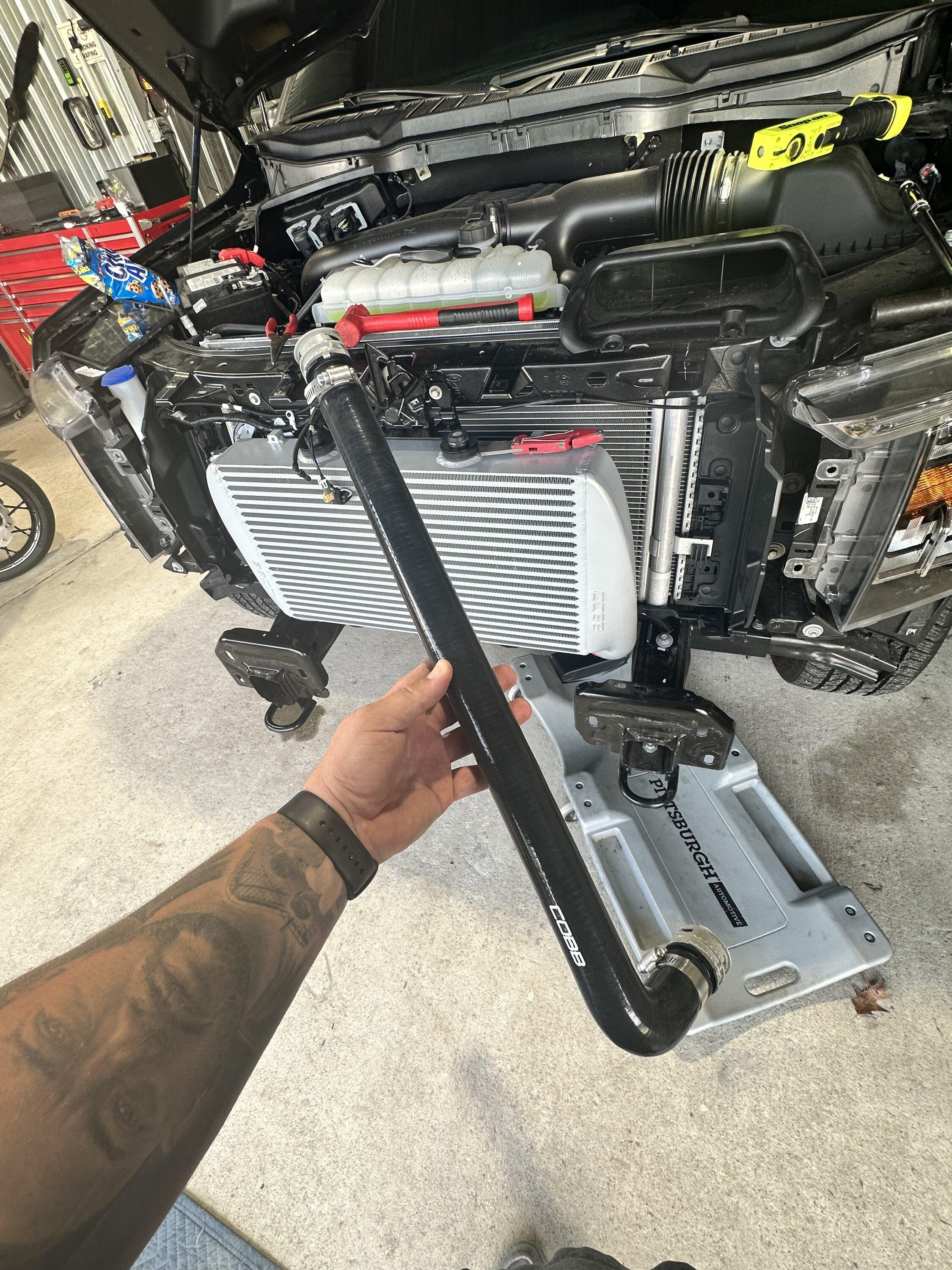

Hey guys. Anyone else install the Cobb front mount?! I’m installing mine now and Cobb provides a house that goes from the factory intake pipe, to your factory bypass valve. Anyways, I’m deleting my bypass valve as I picked up a turbosmart blow off. I’m wondering if anyone plugged their intake pipe instead of putting their supplied pipe on and then sticking a plug into that.
I look forward to letting you guys know how I like it, fit, finish, and performance. Most the info I can find on this intercooler being installed is for raptor model trucks.

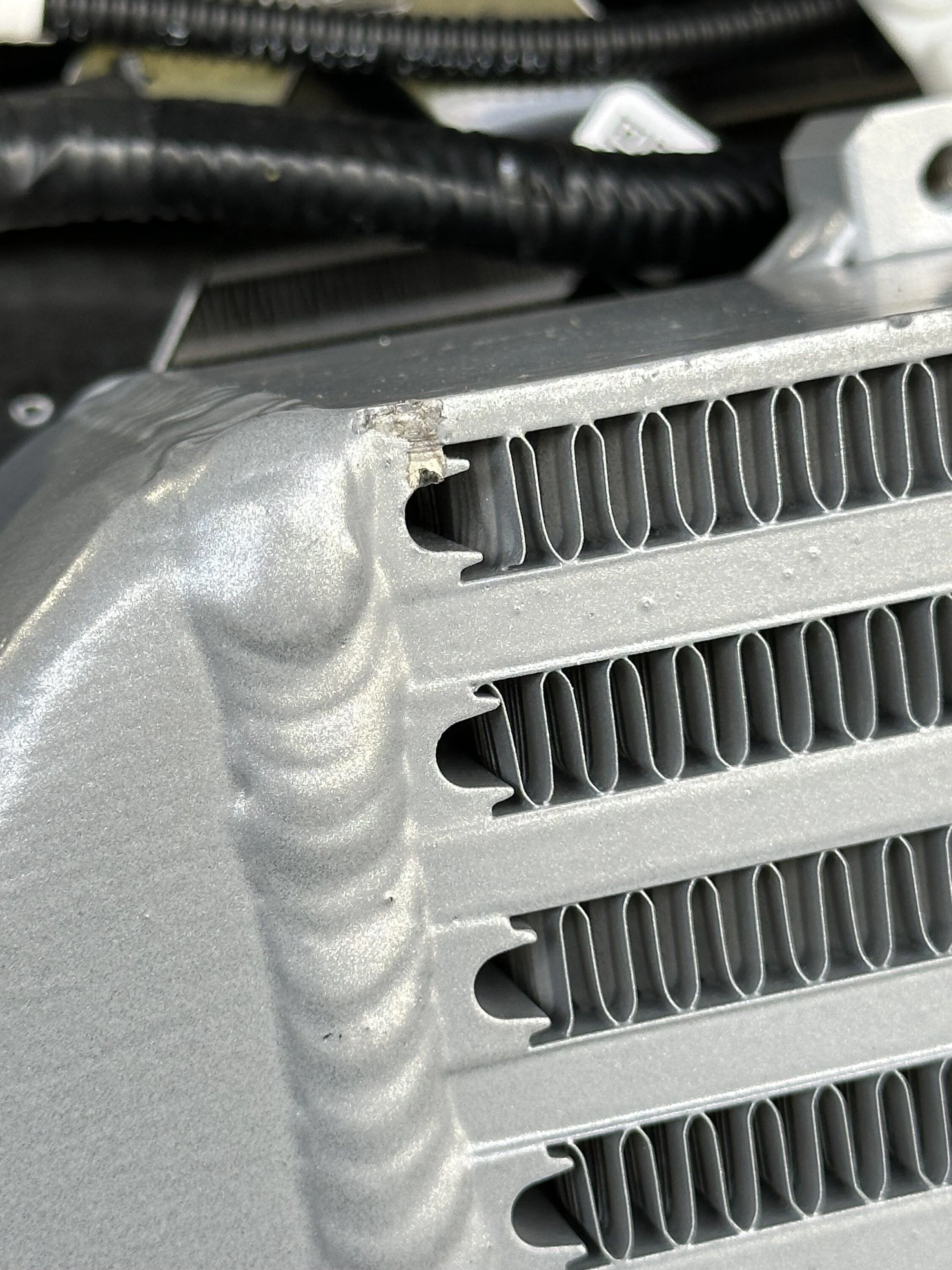

Well…
The “powdercoating” on the intercooler seems kinda crappy for being a $1500 (+/-) intercooler.
Whatever, I can address that later. Anyways, hopefully it performs well.
