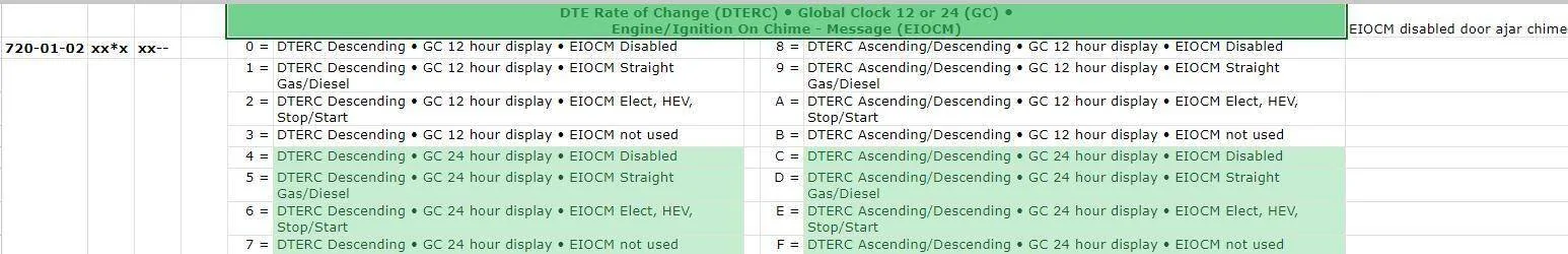

Do you have FORScan? A member on the Lightning forum wanted to do the same thing and had the same issue. This is what fixed it. In his case that it is an EV, he changed this value to a 6:
Ford F-150 Clock reverts back to 12 Hour setting 1727367424505-0i
In your case, I'd try:
720-01-02
xx5x xx--

Thank you. I do not have FORScan but one of the younger guys at the fire station does.

Same issue here, but not every night. Once or twice a week. I assumed it happened when they would push updates. I have Forscan and will try next week. Let me know if the Forscan change works for you.
