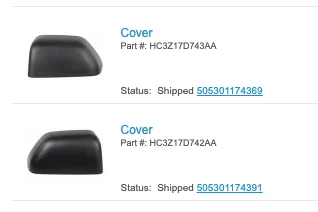

Maybe someone knows the tricks. Also in my pics the other cap ends with the 3 digit. I show only one new cap box.
Well I can say this after reading another post I went and bought Ford black plastic textured skull caps that match perfectly but upon trying to install when I was removing the chrome ones I did notice one difference, there are tabs on the caps, the chrome tabs are in a different place than the plastic ones I bought and show here in my post. I knew I had to break the chrome ones bottom hook tab and didn't want to remove the chrome and then these black ones would not work, so now I am stuck with two black caps and not doing anything. So hard to find videos or anyone showing that they have ACTUALLY replaced these chrome ones with the ones I bought. There also has to be a way to remove these damn skull caps without breaking them, and without dismantling the mirror which I am told that can break easily because it has numerous plastic tabs also. I just wish Ford was f....ing smarter and sold a black out F150 or a Sport like I bought but with all black trim.

Here are the ones I ordered that worked fine for me -
Ford F-150 Chrome skull caps replacing with black textured, it's a no go 1636125336583
Looks like they may be the same as your part number, not sure what the 1X means on your box.

yes those are the same as mine. So you have a 21' ? Did you break the chrome ones off at the bottom tab? If these work I have no problem breaking those $100 each chrome ones LOL, to get these on. Thanks.

I replaced the chrome caps on my 2021 F150 tow mirror with the black caps. Those tabs you circled can be tricky as they need to slide into narrow slots. As for removing the chrome ones without breaking them. Yeah, it's possible , but you have to remove the mirror and take apart some of the housing. There are a couple of YouTube videos. But I wouldn't bother, I tried following the stupid videos and ended up cracking one of the damn mirrors. Expensive dumb ass mistake. Just break the tabs on the chrome caps and save yourself the headache.
Yep, have a '21. I did take the mirrors out (super easy to do, angle them up and out and they just pull right out) but even with that I did brake the bottom tabs on the chrome ones.

thanks, so with the mirror out you could not push that chrome tab and release it without breaking? To confirm, the mirrors just pull out?
