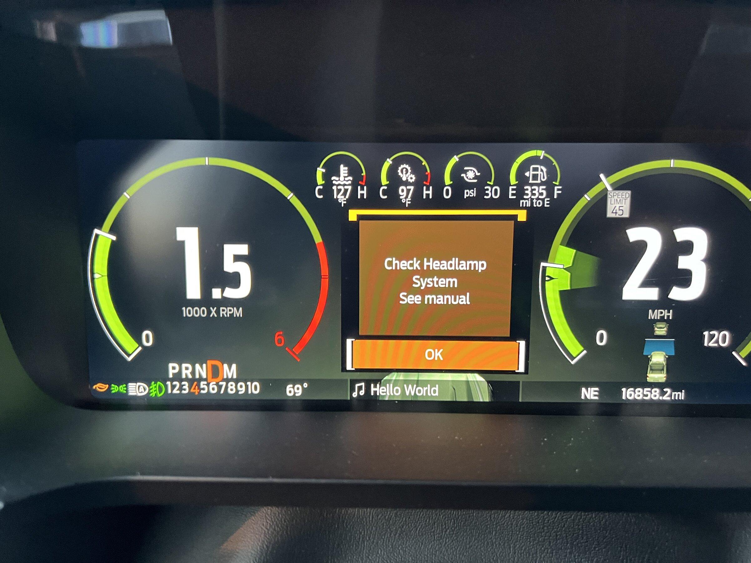

This is the third time I am getting this pop up. The dealer looked at it, said the battery charge was a bit low, charged it up, and sent me on my way. Months later, it’s back, twice in a week now.
Anyone had this issue? Truck battery is only 9 months old.

Hi Platinum peasant, have you or your local dealership been able to set mine what was the cause of this check headlamp see manual message?
if so, would you mind sharing if they were able to repair it & what needdd to be done to clear the error message?

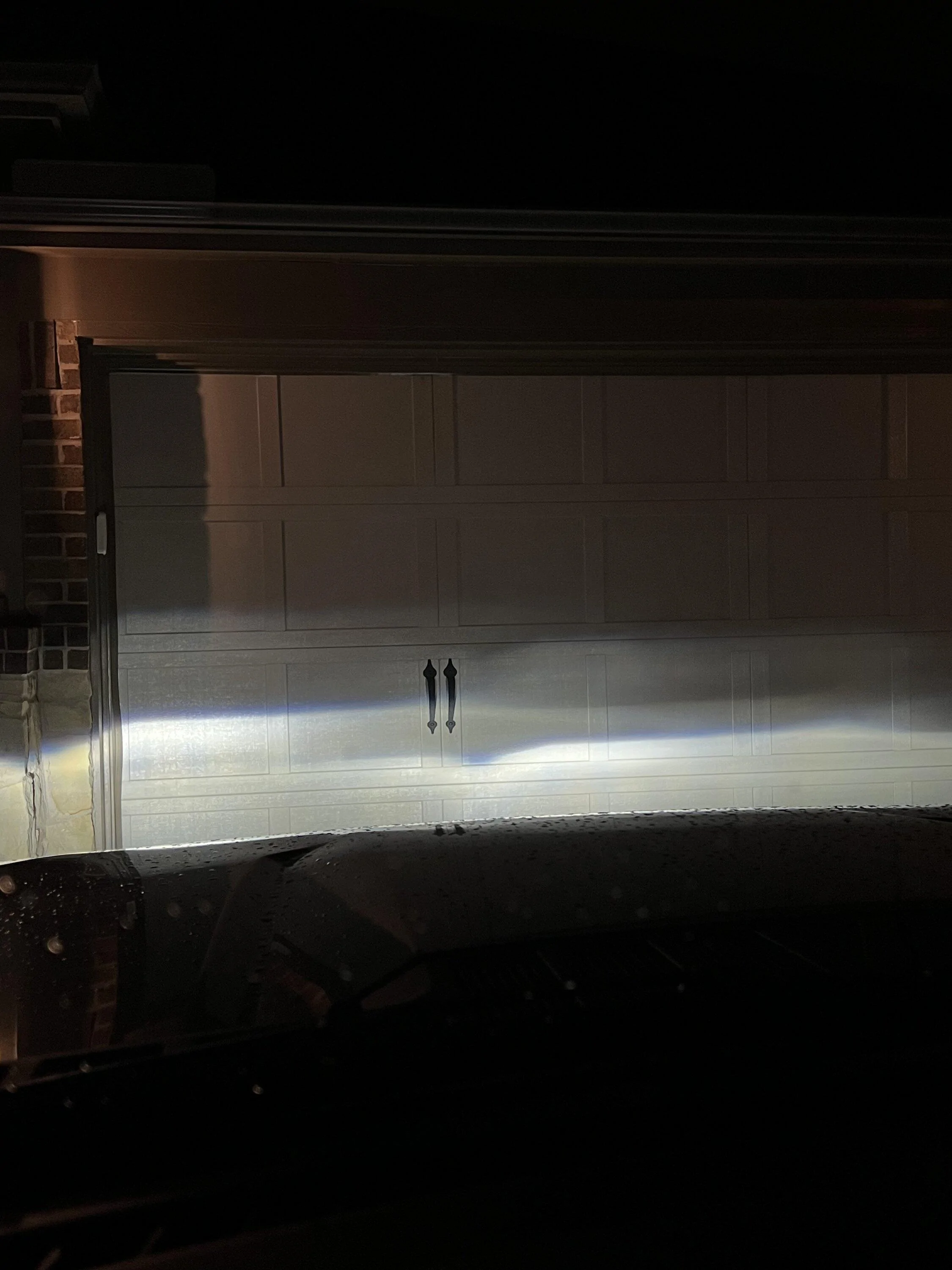

Mine would pop up that message when the headlight dancing thing didn't have the lights adjust correctly. It has not happened anymore after my trucks software was all updated. Pictures attached of aligned and screwed up aiming. Restarting the truck always fixed the aiming.
