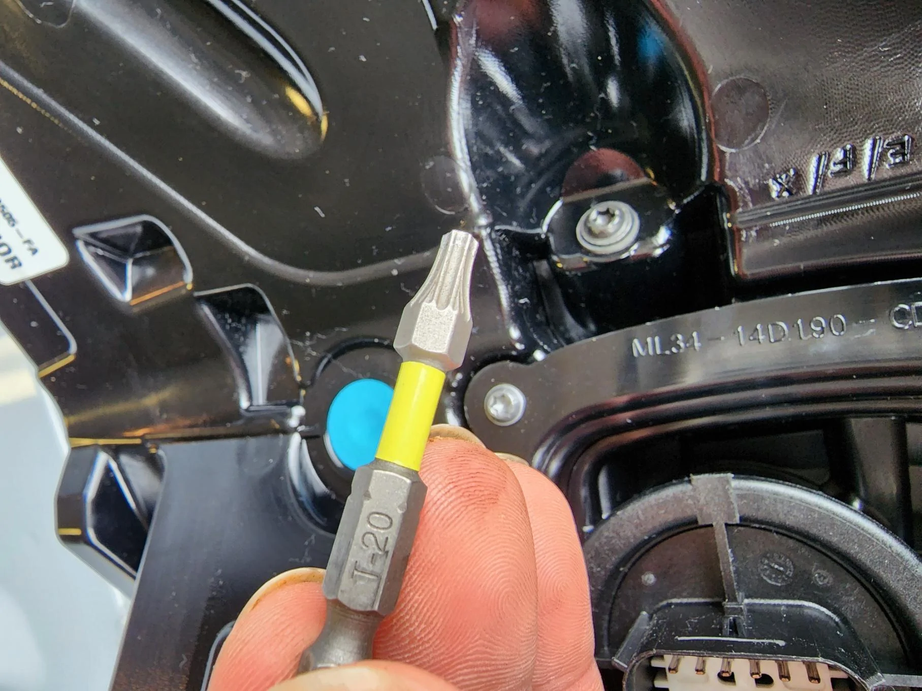

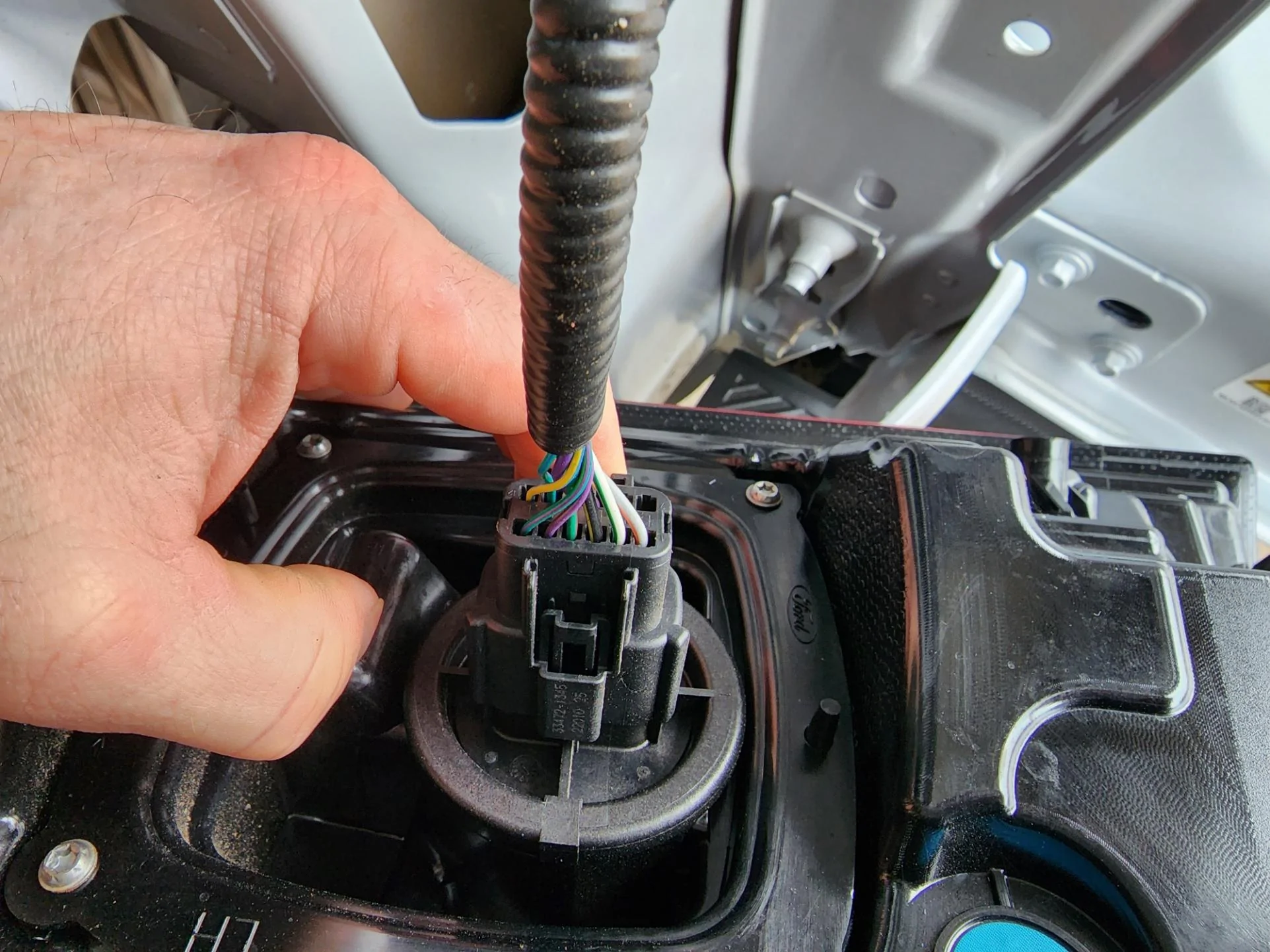

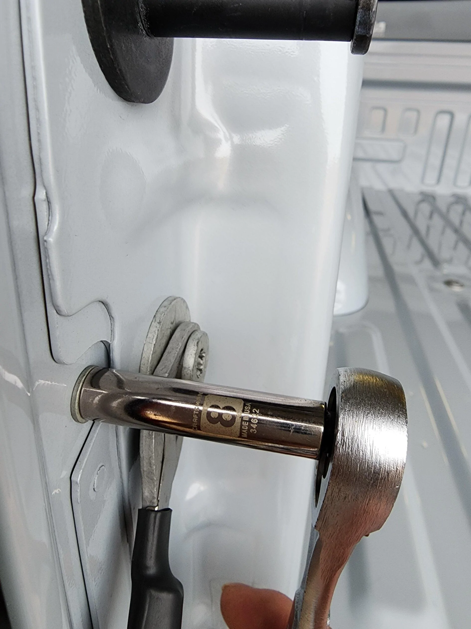

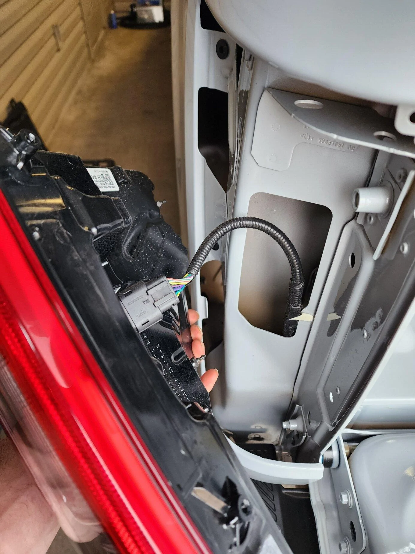

I changed my Lariat led tail lights today to tremor/bap tail lights. I figured I would show the process of keeping your original BLIS modules and transferring them over to the new tail.
8mm socket for screws to remove lights
Torx 20 to remove BLIS modules. There is a small hole if you will to pull up on to remove the module. It is seated in there with a rubber gasket.
