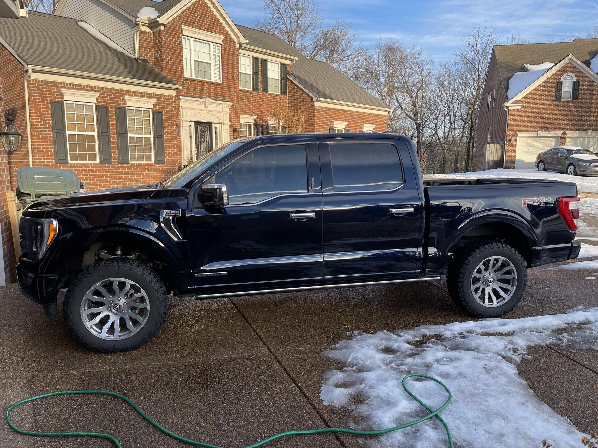

The ceramic coating made a huge difference. It cleaned up very nicely with not much effort. I highly recommend
