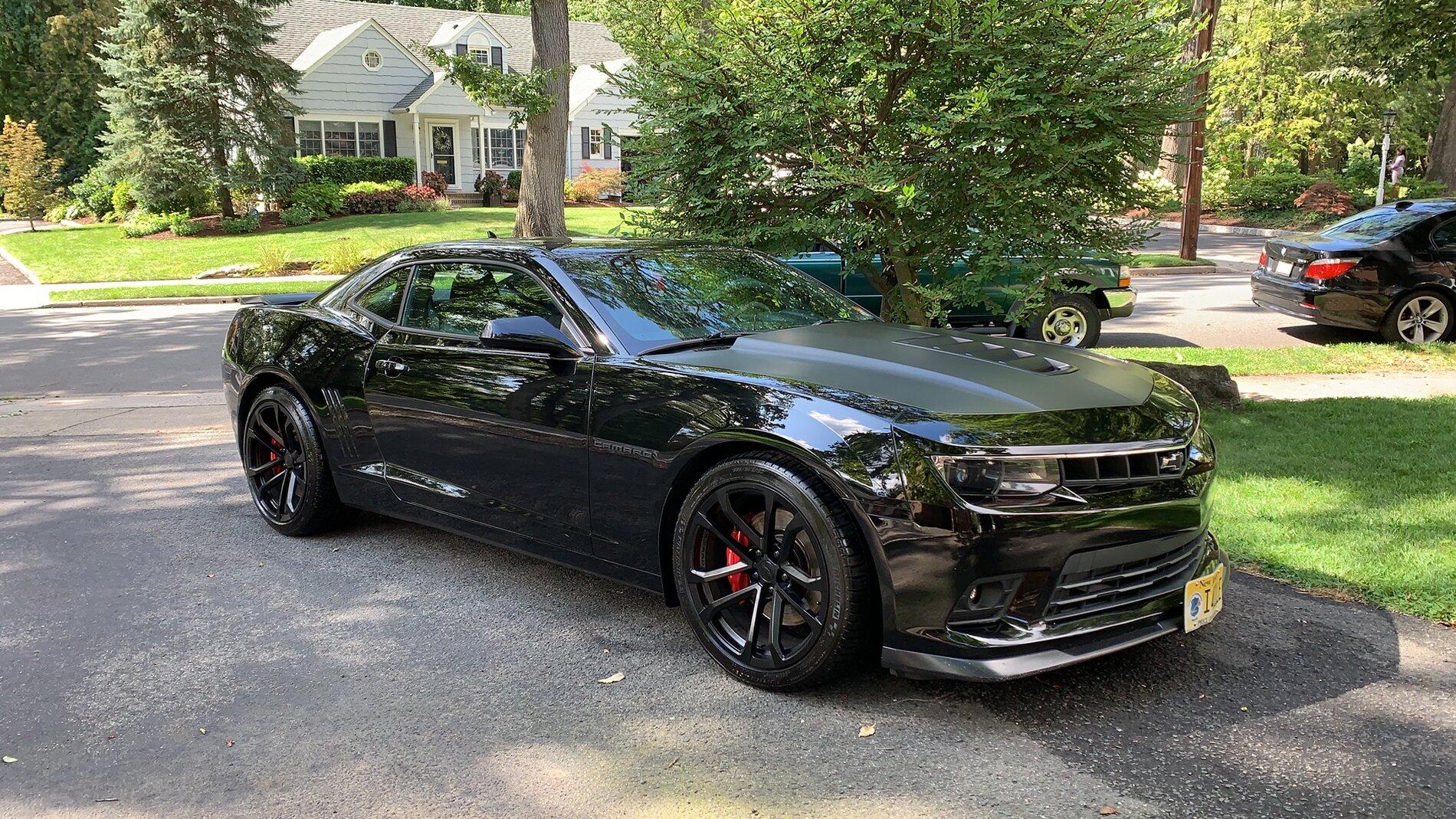

I have had a ceramic coating on my Camaro for 3 years now and it still looks amazing. Its black and has little to no swirl marks (pet peeve - I also do no touch foam cannon washes) After any wash it looks like the car was clayed and waxed (Arctic Coating was the brand) Yes a good shop will go in and do a paint correction. Make no mistake that a brand new paint job still needs corrected. The price is in line with the effort it takes to do this correctly any shop that is saying $600 or whatever is not doing the necessary labor for a lasting job.
as some have said the film works well too I just don't like how it looks up close... and that is where I see the vehicle the most....
