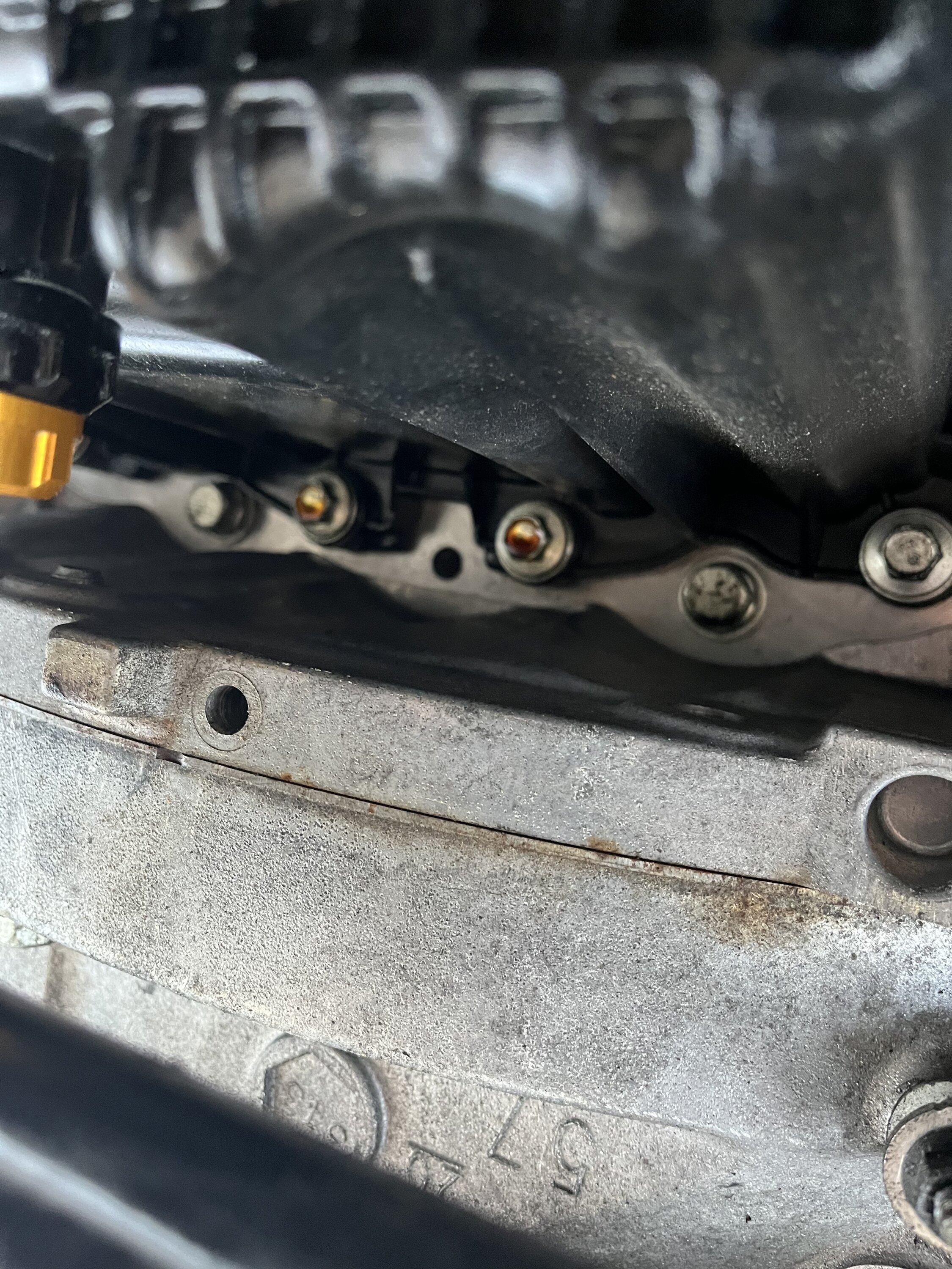

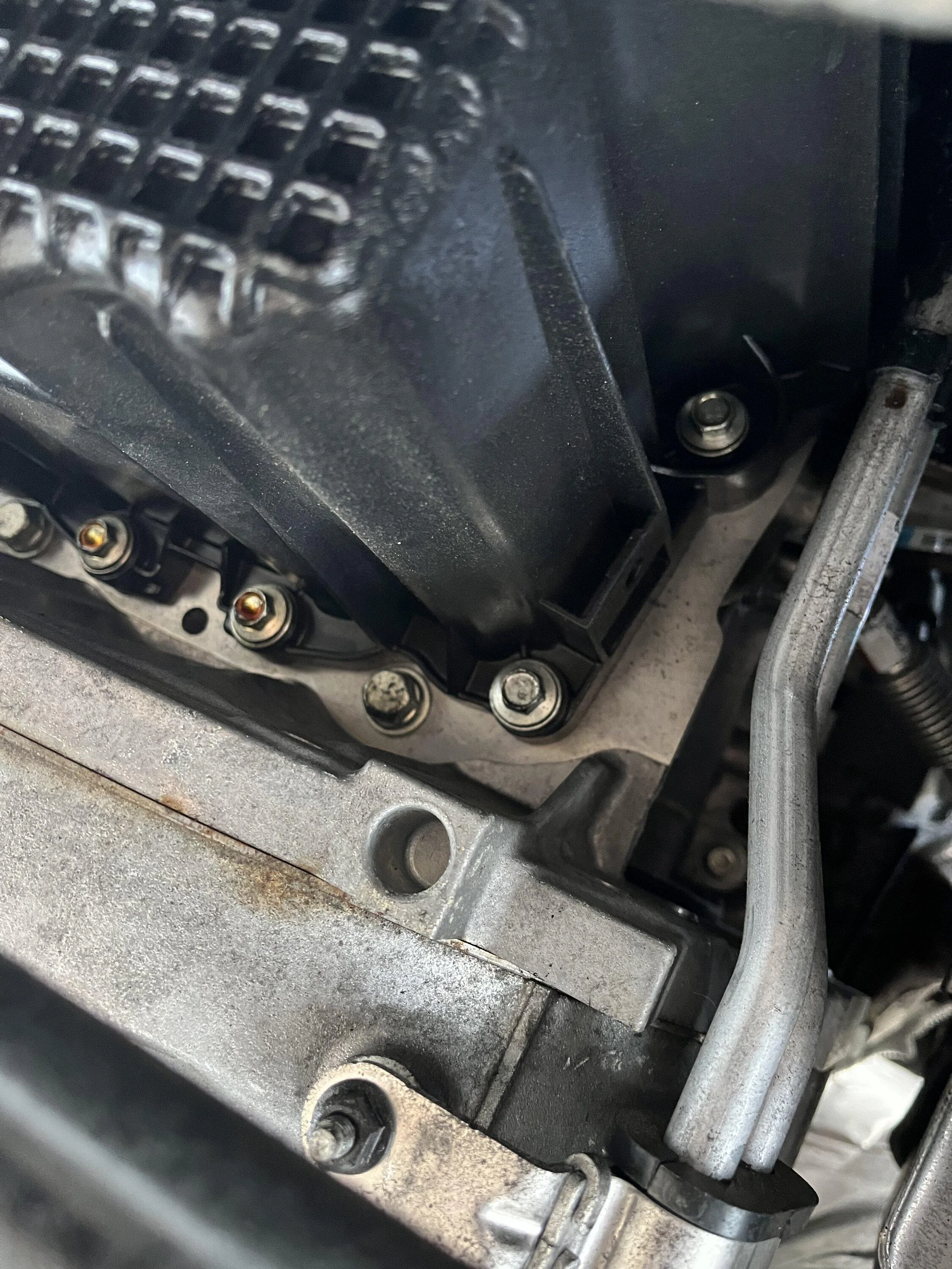

I noticed a small leak along the bolts holding in my plastic oil pan on my 2021 2.7 (see pic below). The dealer declined to repair it saying that my catch can changes the crank case pressure and therefore they won’t fix it under warranty. Are they just BS’ing me?
the dealer near me is pretty tough to work with, but as long as this is covered under my power train warranty I can deal with it later after my next move and I am near a better dealer. Anyone else had issues like this?

That is BS. Unless your catchcan is not a typical one for sale, there is zero pressure change. The catchcan is a completely pass thru setup. It simply introduces a place for liquids to collect instead of being drawn into the intake manifold. Make clear to them that there are legal implications if they continue to refuse service.

Does a catch can increase CC pressure to the point to blow out seals? No.
Could a crappy modification to the factory CC ventilation system increase CC pressure to the point of blowing out seals? Sure!
If not a major PITA, I would remove the CC before bringing it in.
FWIW, you don't need a catch can on the non-DI 3.5 twin-turbo motors.
