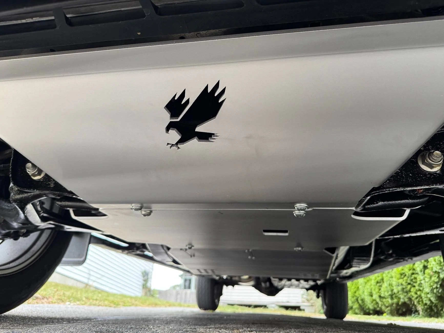

Just picked up my 24 powerboost.
Looking for a no drill cat shield.
Here is the aluminum Talon skid plate 3 piece kit on my 2024 KR PB, perfect fit, no drill required.
Ford F-150 Catalytic converter shield powerboost IMG_4287
Ford F-150 Catalytic converter shield powerboost IMG_4284

Thanks, looks like a the best option

I’ve had full skids in trucks before. They often squeaked and groaned as the chassis flexed. Any issues of this with the Talon set?
