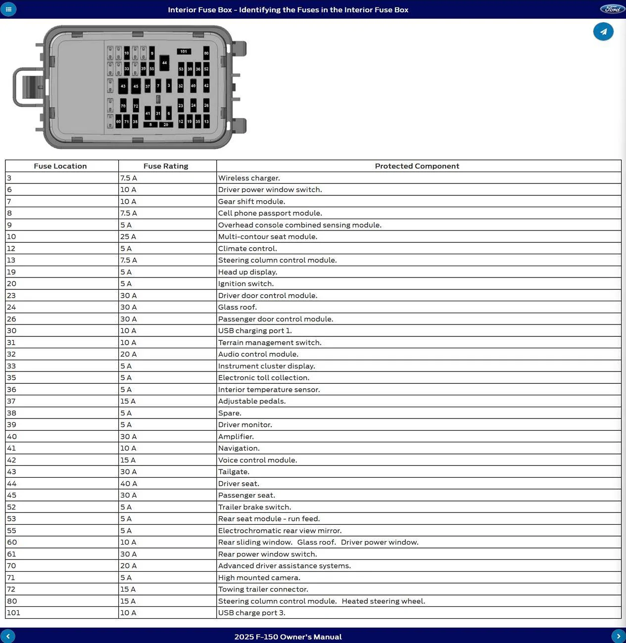

So this issue is still ongoing, but randomly only once I did achieve a wireless connection for one ride. I spoke to a couple dealerships and they are saying 1-5 days with the truck for diagnostics :puke:.
It's a bluetooth issue maybe. So in an effort to avoid that dealership scenario, I am trying to reset the SYNC 4 fuse, but I can't identify it's fuse location based on the online manual for the F-150.
Not sure if APIM would be the same as SYNC but I don't see that either and I don't want to pull random fuses trying to guess.
Any insight would be appreciated on identifying the SYNC fuse on a 25 model.
Thanks
