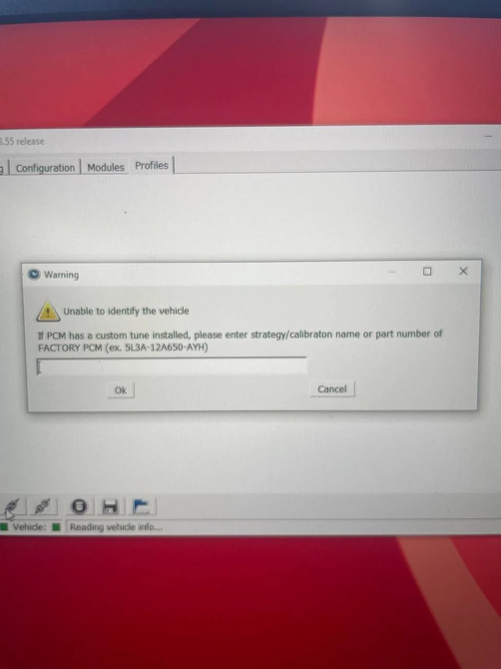

I am seeing the following error when trying to connect my 2024 F150 to Forscan. Any ideas?

tbinmd Well-known member Joined Sep 23, 2021 Threads 4 Messages 946 Reaction score 791 Location USA Vehicles 22 KR F150 Jan 13, 2025 #2 what version are you running? there was a problem with the 24’s that required a new version of forscan. ’

JEB Well-known member Joined Aug 15, 2021 Threads 1 Messages 1,985 Reaction score 1,984 Location US Vehicles 2021 F150 Lariat PB 502a Jan 13, 2025 #3 bflan2001 said: I am seeing the following error when trying to connect my 2024 F150 to Forscan. Any ideas? Click to expand... You can try looking for the PCM strategy in the as-built data. See this thread. https://www.f150gen14.com/forum/threads/pcm-part-location.22344/

OP OP bflan2001 Active member First Name Brian Joined Dec 31, 2024 Threads 7 Messages 28 Reaction score 24 Location CA Vehicles 2024 RCSB 4x4 Occupation Machinist Jan 13, 2025 Thread starter #4 tbinmd said: what version are you running? there was a problem with the 24’s that required a new version of forscan. ’ Click to expand... Downloaded the latest version and it connected, thanks for the heads up! Sponsored
