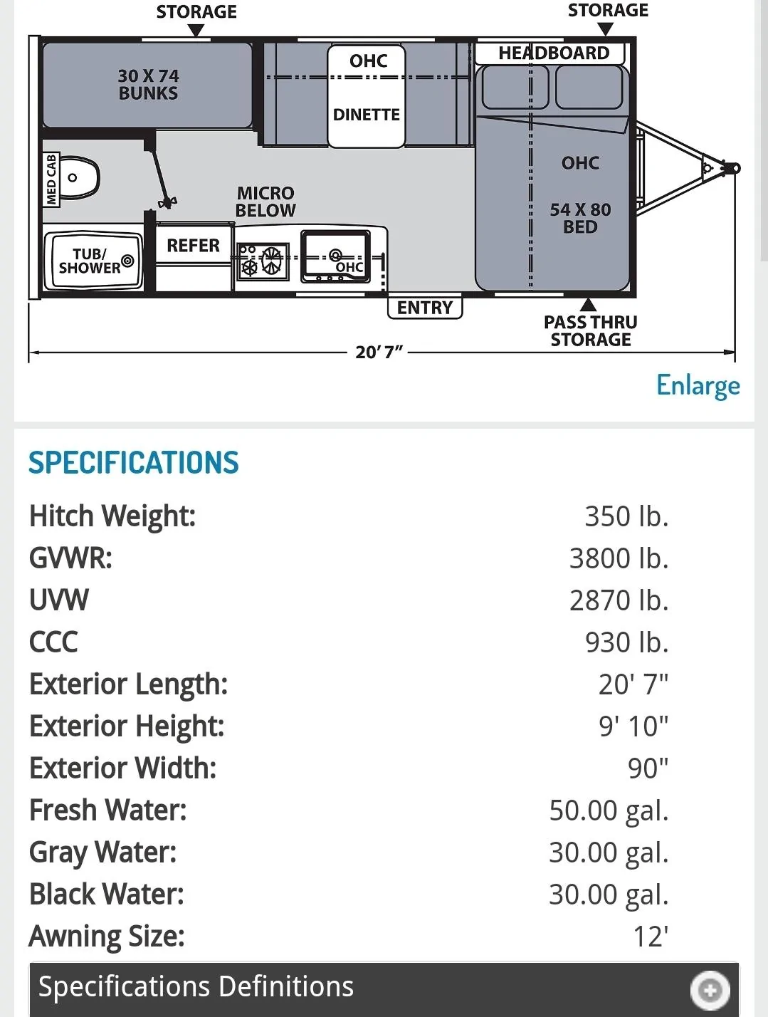

Here is my trailer:
https://coachmenrv.com/travel-trailers/apex-nano/185BH/1593
I’ll probably pull it once without the distribution hitch to see how it goes first and then better judgement will get ahold of me.

Ford F-150 Camper towing question - do I need antisway bar for 3300 LBS camper? Screenshot_20210401-203412_Chrom
Here's another opinion, because I know you want one. ;)
If you crawl on your back and look up at your hitch there is a sticker on there from Ford. It probably says, If you have less than 500 pounds on your hitch.... weight distribution is NOT needed. But I guess it can't hurt. I believe it will also have a number like *1200 or 1500 you can put on your hitch if you are using weight distribution. (Of course payload and other #s reduce these hitch #s)
As you know, IYour specs say 350 pounds.
But, I know you asked about anti-sway.
I guess my only concern would be perhaps severe winds?
somebody once told me if my trailer ever starts to get out of control, Slide the brake control lever over and hit the brakes on the trailer.
*This is not advice.
I have towed approximately 6000 lb with a 22 foot trailer and my Kubota B series tractor... without weight distribution or anti-sway... I did this with my 2014 Ford F-150 with Max trailer tow.... but I never towed in high winds and obviously the profile of a camper is much different...
I offer no advice and basically just my observations ...It's another opinion for you to mull over. ?

Yes but not worried about going near 500 LBs with this trailer. Wind is always a factor in New England.
