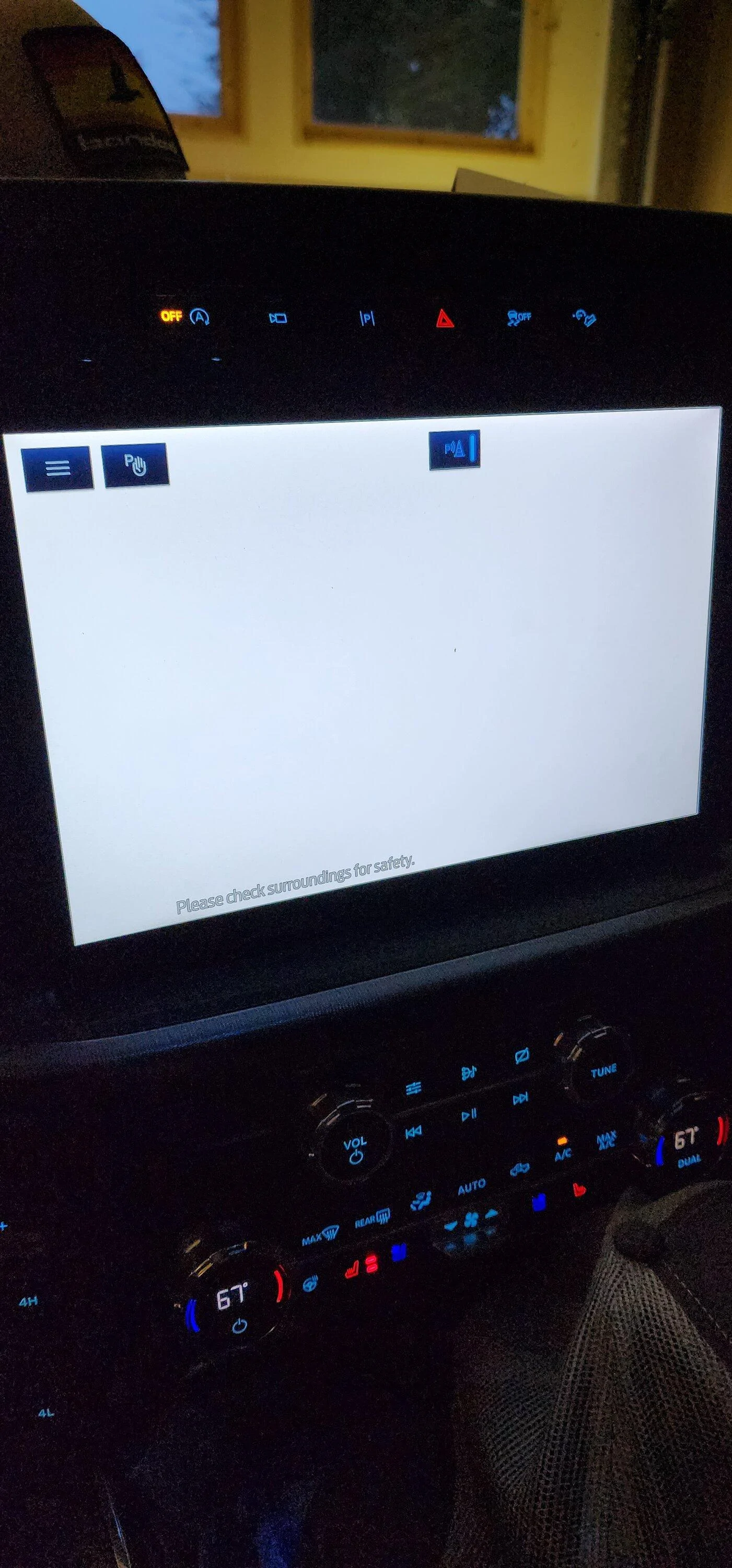

Has anyone else experienced anything like this? First time it happened the screen started glitching so I turned the truck off and started it back up and the cameras were back to working fine. Two weeks later and now it is happening everytime I turn the cameras on or go into reverse and it says cameras are unavailable. Could a camera with a bad connection or faulty camera cause this? Or am I looking at a more serious problem? Truck was built in March of '21 and hasn't been getting updates since about Sept of last year.
Ford F-150 Cameras glitching out and eventually stop working 20230301_175312
Ford F-150 Cameras glitching out and eventually stop working 20230302_070042

Have you pulled the codes? Do you have forscan?

I've had a few episodes like this, with the screen gliching, sometimes turning the camera zone solid blue. They seem to happen after a car wash and work again after the car is dry - I suspect some water is getting onto a video signal cable somewhere.

I haven't taken it to a car wash in a while, only water would be from driving in the rain but it hasn't rained on it the last few times its happened.

I have Forscan, going to do that tonight
Yea, I would check the codes as they're a bunch of camera codes and they may help narrow it down. I would then do a reset the IPMA via forscan, and see if the problem goes away.
Just FYI, I had an issue with the rear camera when I first bought the truck going out on occasion. I noticed the camera lines running into the IPMA (left kick panel area) were super tight, and in a hard bend. I cut a zip tie that was holding them and let the relax a bit, and I haven't had any other issues from them.

Just checked Forscan, had a C1001 on the APIM for vision system. said it was general electrical failure. Cameras weren't working and I reset the DTC and it went away and the cameras are back working now. I guess time will tell if that's the cause of it or if there's something else causing problems.
