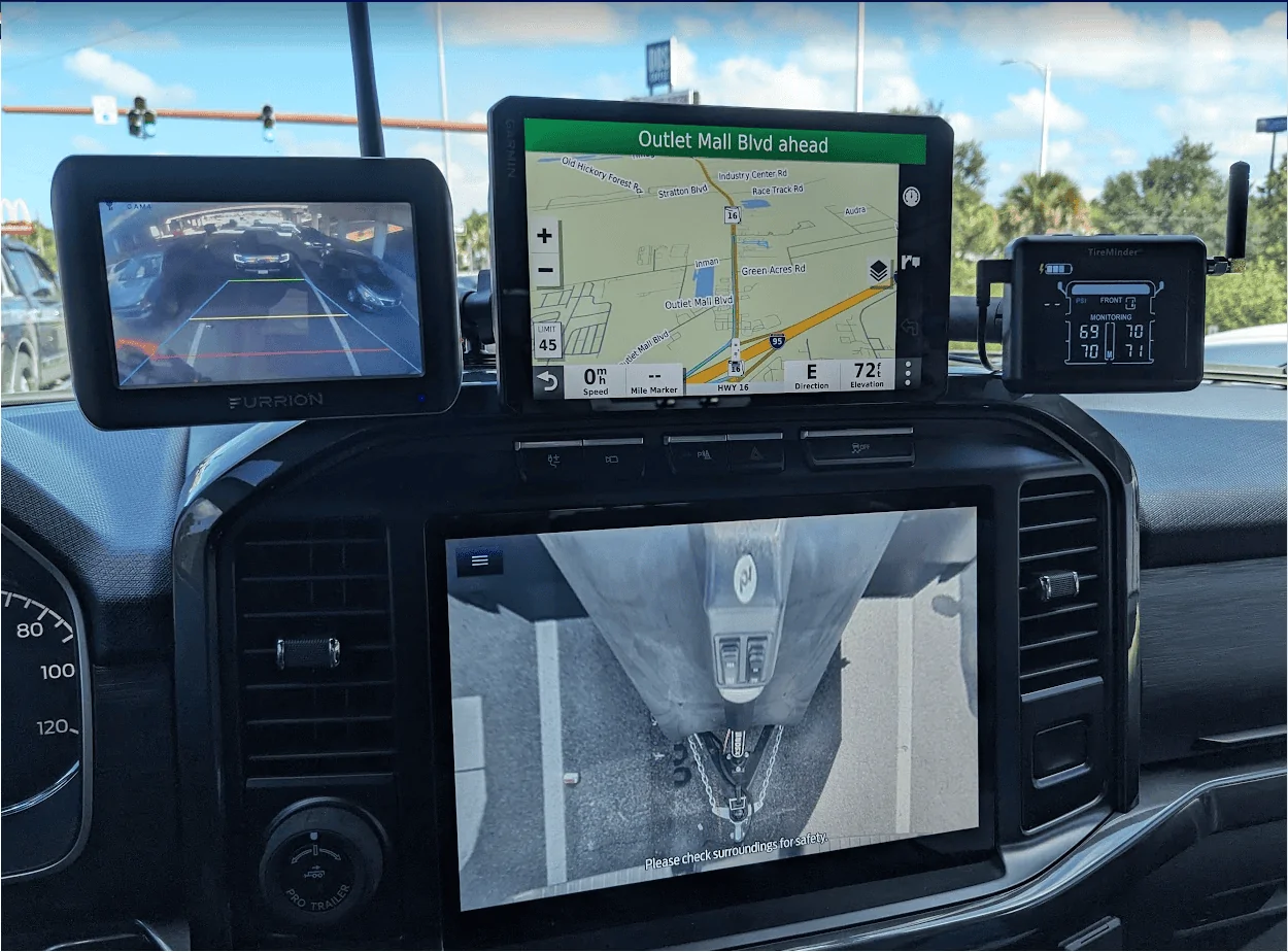

Here is a revised pic of the dash after this past weekend's CAT scale run with new Andersen WDH hitch. This view is with the camera well below driver vision in order to get all four screens tight in the pic. None of the three items block the view of the hood meeting the road from the driver's view.

Great setup! Can 100% stand by Builtright Pro dash mount over their regular one since their Pro line gives great support! I would recommend you using split wire loom on those wires and clean them up. Looks 100x better, you can see it in the pic below at the back.
Have my work radio mounted up there in my work 21 XLT instead of my 22 Lariat. Here’s a quick pic from last year.
