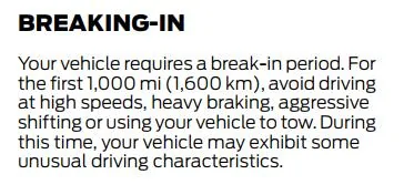

There was nothing in the manual that says you can't leave the truck idling during the break in period. The truck has a 30 min idle setting by default. You can turn that off. I would put in Generator mode and turn A/C on while napping. The PB engine will cycle off/on as needed to charge the hybrid battery. I would also turn off the center display (button under the screen) and put something over the instrument panel to block the light since it doesn't completely turn off. Here is the break-in info from my 2021 PB. I'm sure others here will give you more info. Good luck and safe travels.

Here is what will happen with the PB. You will pull over and if it is hot outside just put the truck in park. Take a nap and the truck will probably run for about 2 minutes and then the ICE shuts off for the next 8 - 10 minutes while you have the air running and you are staying at 70 degrees and napping comfortably. The truck cycle will rinse and repeat until your nap is done.
Stop somewhere for a coffee, rest break, eat etc. and shut the truck off while you are gone. When done start up the truck and keep on truckin. You will be home before you know it and if it ever start to drag, just think of all the extra money you have for mods! Easy.
Drive safe and good luck. Remember if you are tired do not hesitate to stop for a time in a hotel. Adding the cost of a hotel stop to the overall cost of the truck is nothing.
You can set a timer on your phone and just lock out gears while cruising to vary RPMs. The 10 speed's ratios are so close that you don't really need to vary speed just drop gears. If it's empty area, take an exit and hop right back on to roll through the gears and get back up to speed. I'm a bit more aggressive on new engines, not balls out, but keeping the RPMs higher. There's a difference between running higher RPMs and doing it while accelerating. It's easier on the motor turning higher RPMs than it is to build boost at lower RPMs. Just stay out of boost sans accelerating. With no traffic around you, you can slow down some then moderately aggressive get back to speed (Use RPM vs boost). Probably wouldn't use 8/9/10 until a couple hundred miles in. In regular mode the - button will lock out gears. You can also run manual mode running each gear out to 4500 RPM or so, not so much accelerating fast, but just running higher RPMs before shifting.
