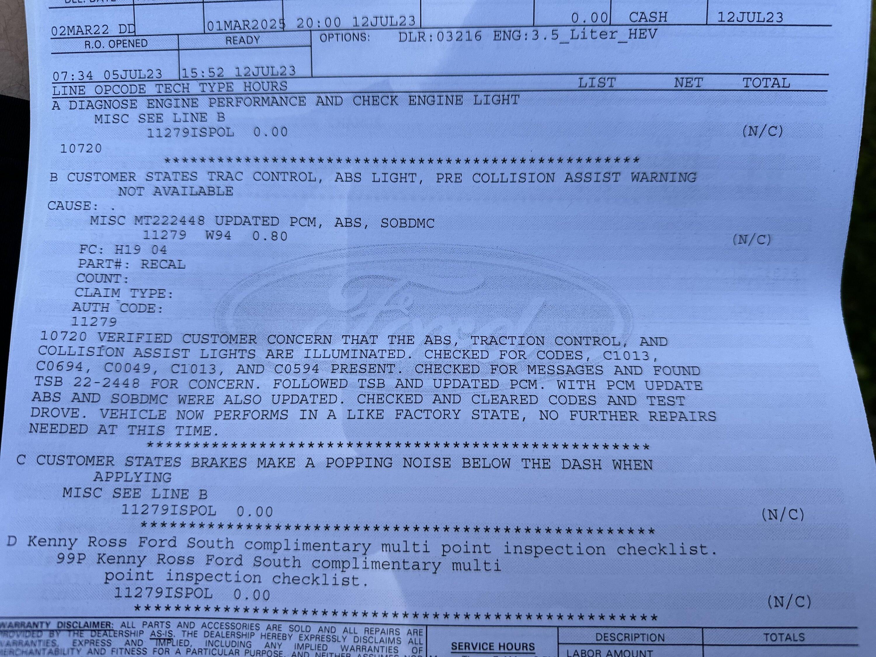

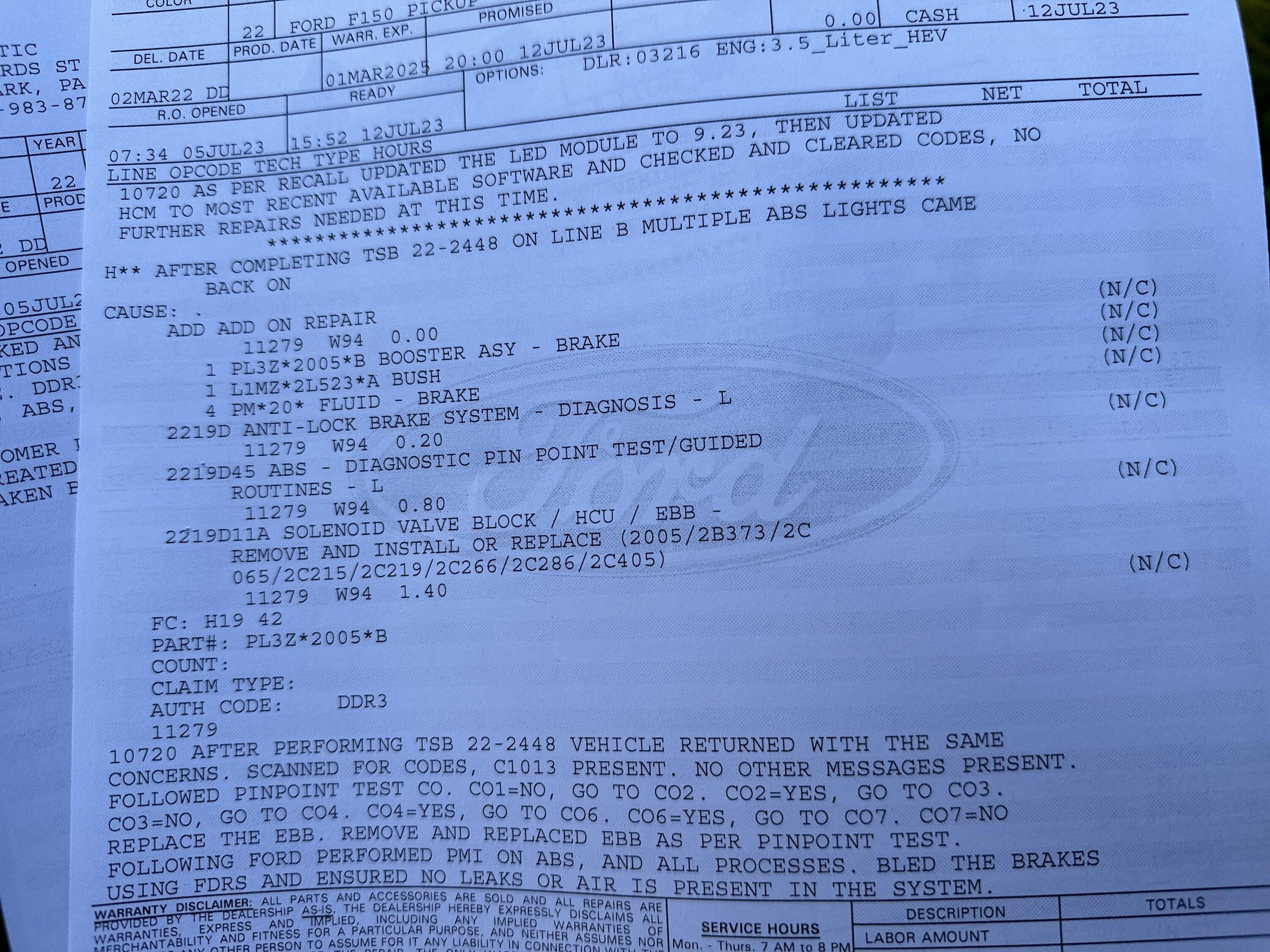

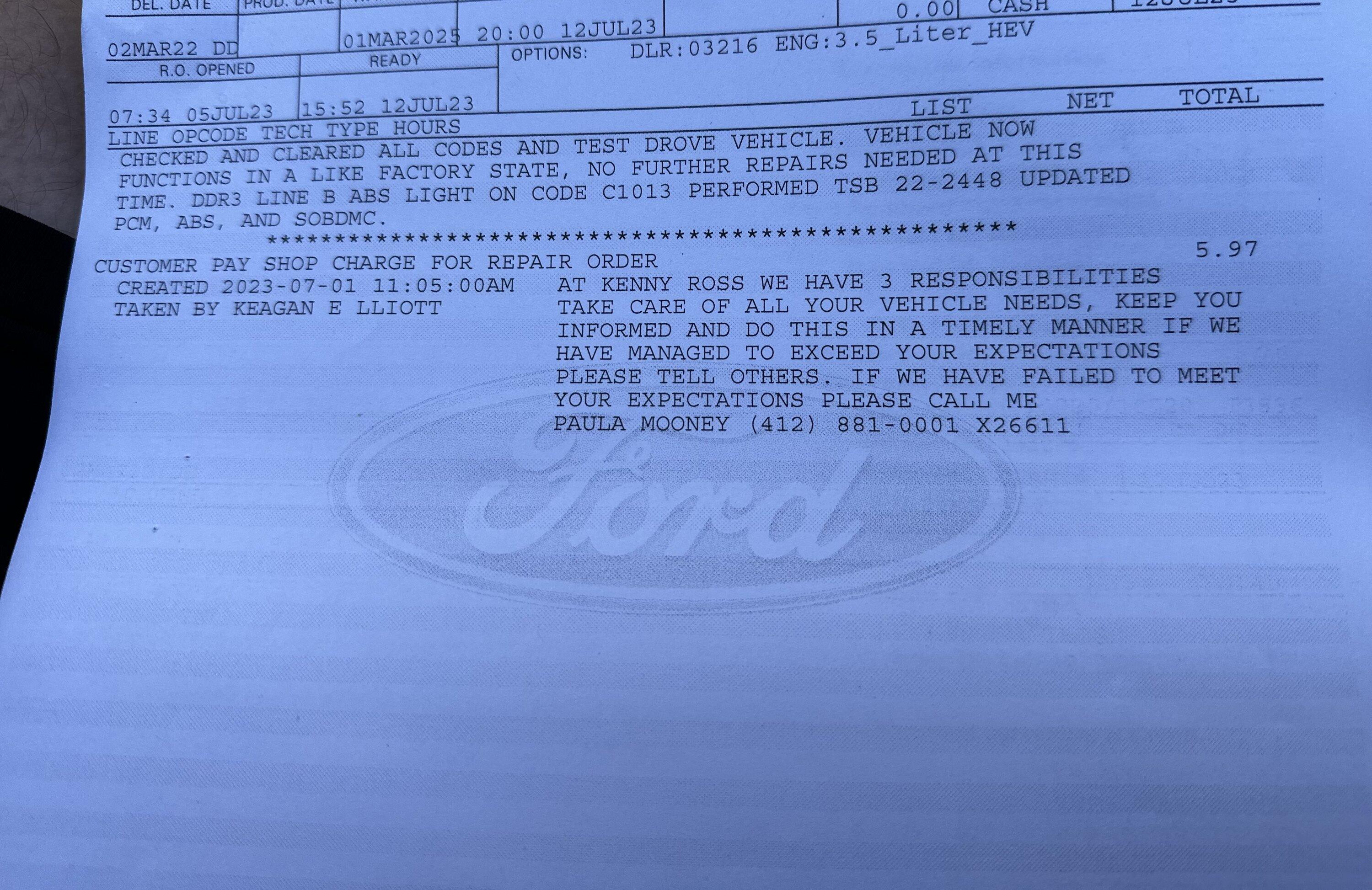

Well, picked up my truck yesterday and happy to report my issue has been resolved. No more popping or noises coming from when the brake pedal is pressed. Also, they updated a bunch of other SW on the truck for improvements.
Ford F-150 Brake pedal issues POWERBOOST IMG_3143
Ford F-150 Brake pedal issues POWERBOOST IMG_3144
Ford F-150 Brake pedal issues POWERBOOST IMG_3145
