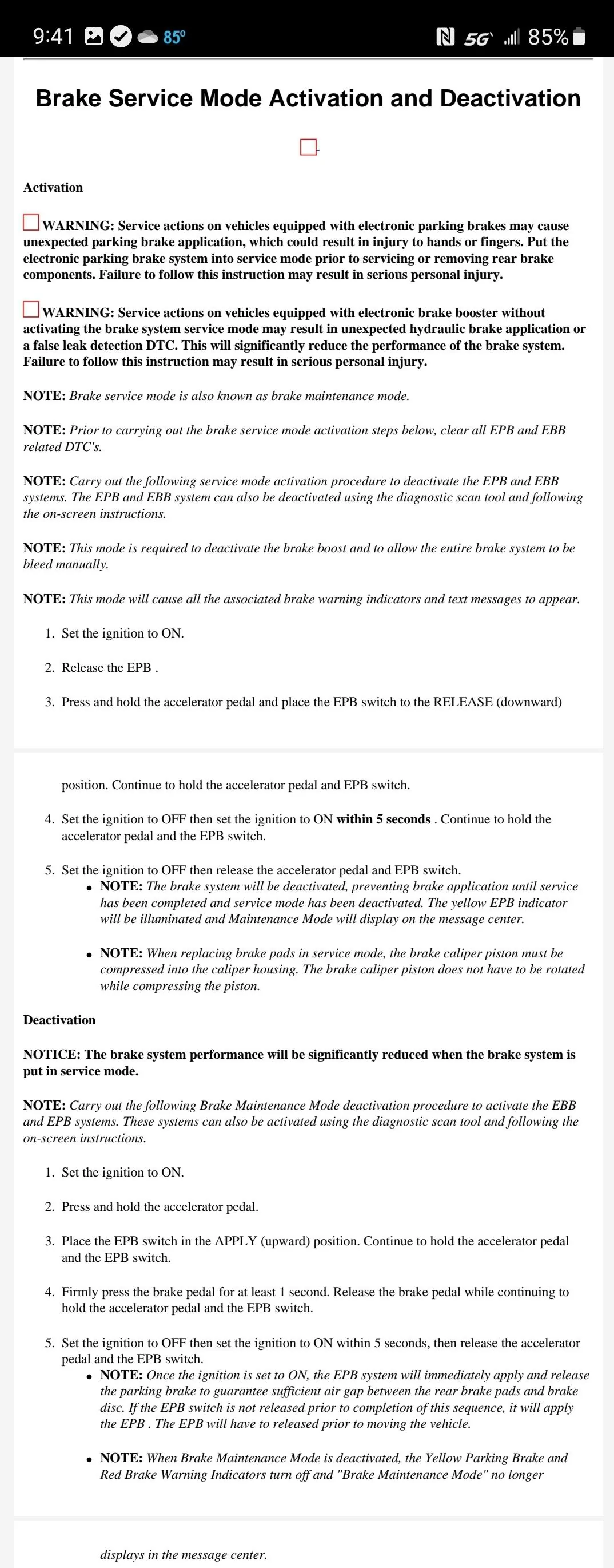

Big Dog Daddy sent me this document for getting in/out of maintenance mode:
Ford F-150 Brake Maintenance Mode Screenshot_20230922_214307_OneDriv
The factory service manual has the following instructions (I have not compared the two)
Ford F-150 Brake Maintenance Mode Screenshot_20230922_214134_OneDriv
Thanks, I've seen that. Those steps did not work to get it into brake maintenance mode nor do they work to get it out. Forscan was the only thing that worked. Just not to get it out now.
