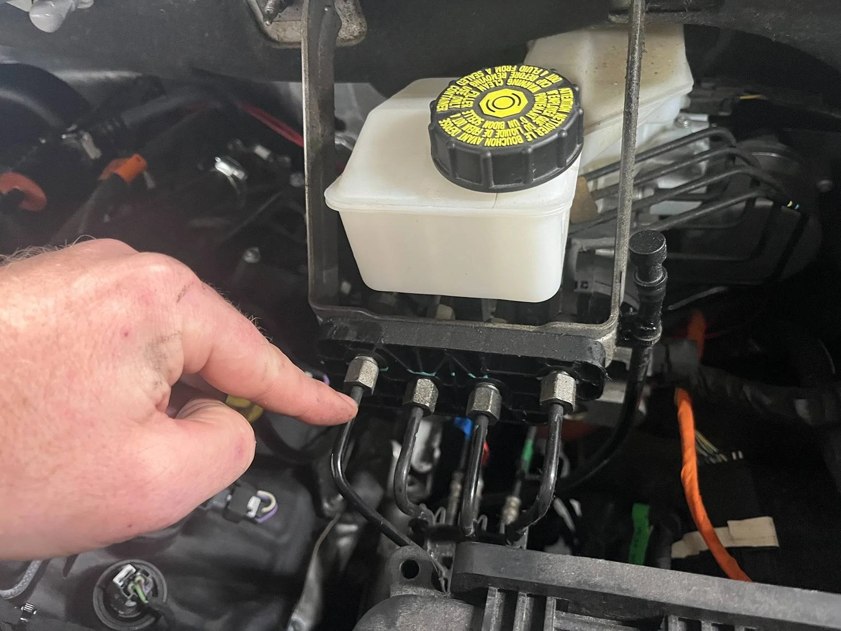

Hey folks, I've got to replace a line that has worn away due to me not allowing enough clearance back when I installed my Vortech blower. If you're looking at the master cylinder it is the far left line (below). I was able to pull its tag (below) but despite having less than 30k miles it has worn away enough to make it indecipherable. I even had my sons look at it and we cant make it out.
Would anyone know where a diagram is for this? I've scoured online and have found the master cylinder and the soft lines at the calipers but not these.

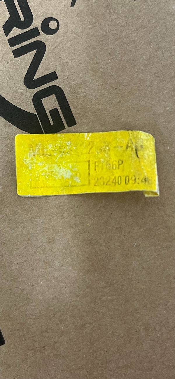

Thanks a ton in advance! The tag is about a foot down the line, you can see the green/red/blue tags on the others. This would be the yellow one. Each has a colored tag which has the part number on one side and a QR code on the other, in my case the ink has nearly worn off them all though. Love the idea but man they gotta get that tag printer cartridge replaced hah.

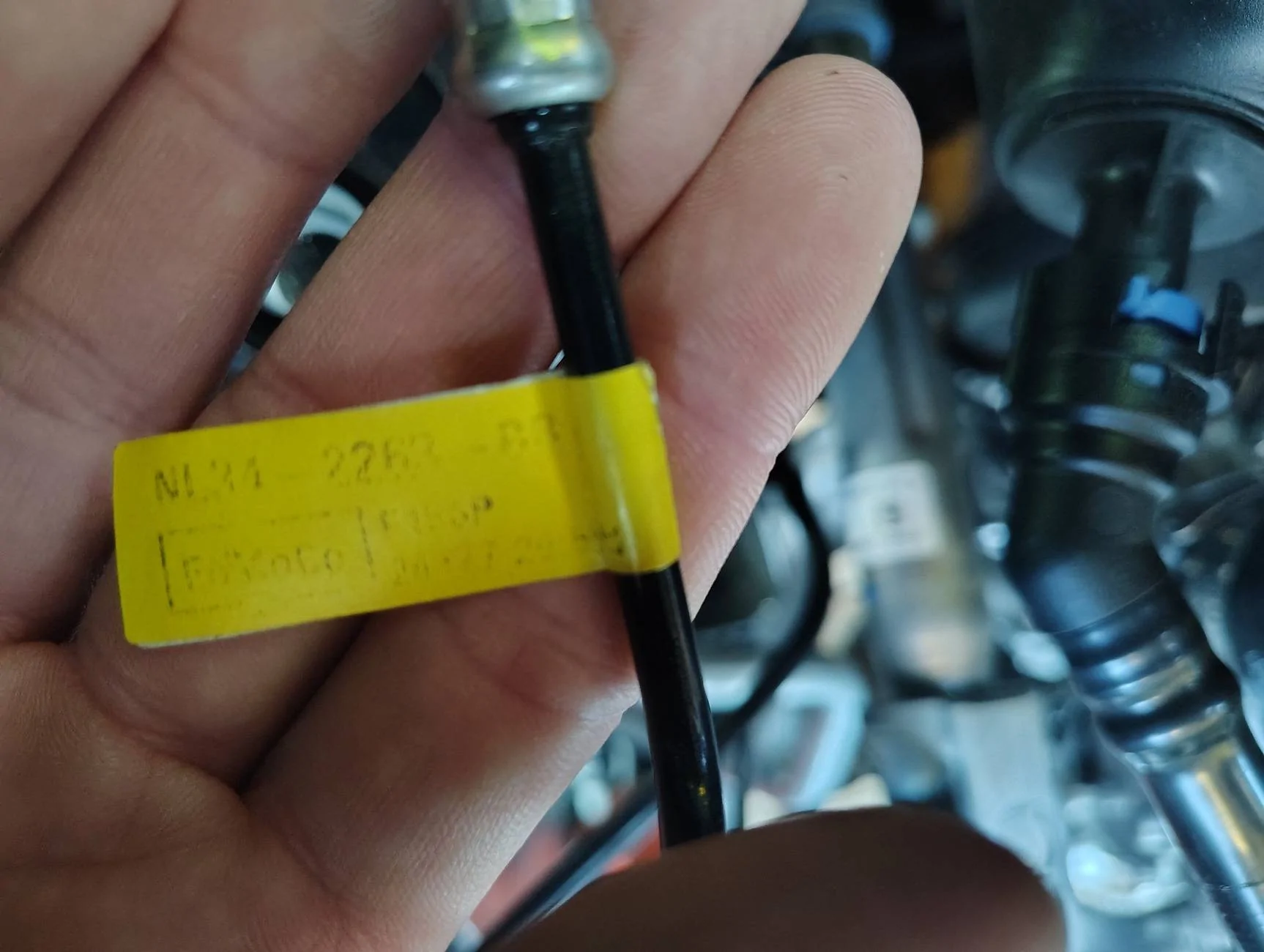

You weren't kidding about the ink, lol. My truck only has 1800 miles and my tag isn't much better.
Closest guess is NL34-2263-(G or B)(3 or 8)?
This is from a 2024 PowerBoost so I'm not sure if they use the same part or not.

Thanks a ton y'all! With the first chunks of numbers spanning our tags my local ford parts tech. was able to determine they've got one at the the next closest dealership and should have it by EOD tomm. for pickup.
Thanks again!
