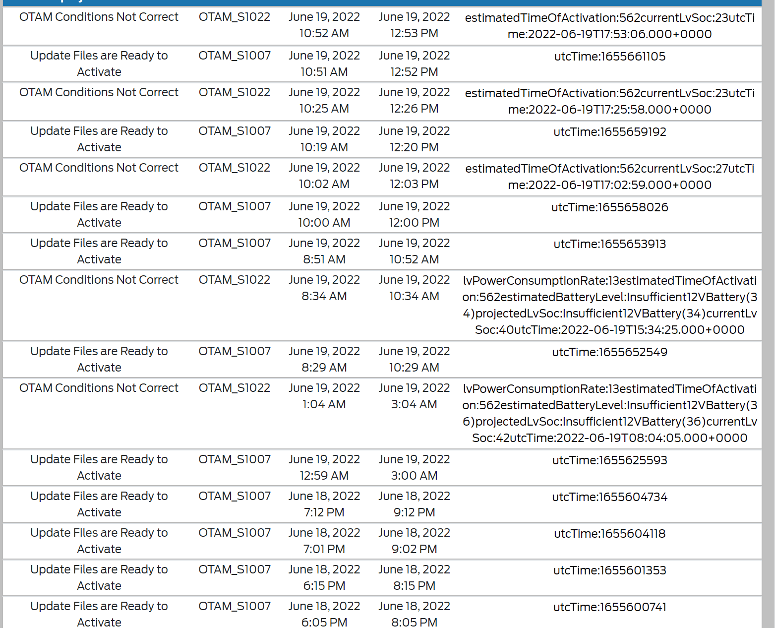

Update...after Jesse helped me out with the low battery issue (WTF Ford,) 2.8.2 just dropped last night. Odd that there's nothing in the update notes that BC just got activated. It seemed like it still wasn't activated until I got on the freeway, hit the cruise button and boom, it's on. Finally! Then.... it dops off before every large curve in the road. LOL. Ugh. Hopefully 2.8.3 irons out some of the kinks.

I’m having a similar issue. I’ve tried to update to 2.8.1 today and it’s failed 3 times. I guess it could potentially be a low battery. But shouldn’t that be concerning? Especially since I’ve already had the battery replaced once already because it was dead. My vin is
1FTFW1E59MFB92573
Would anyone be able to check for me?
