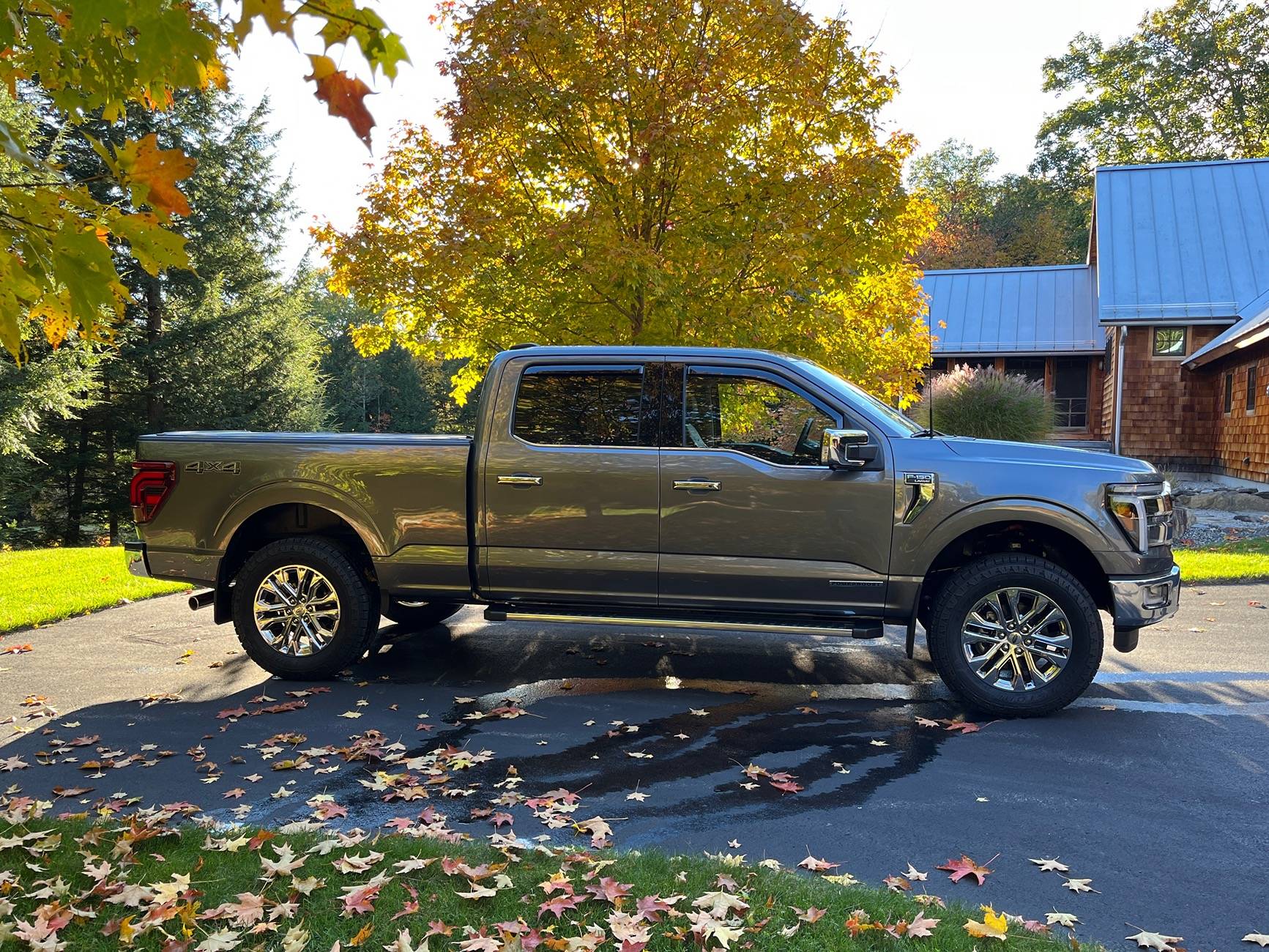

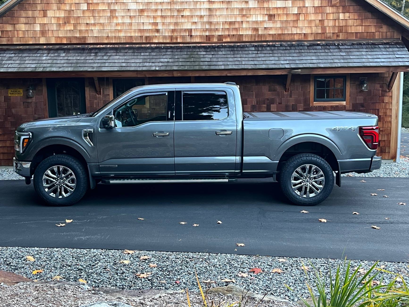

oldbarn70
Oct 19, 2024
Sandwich NH
2024 F150 Powerboost Crew Cab 6.5’ bed
2024 Powerboost CC 6.5’ bed
- 2” Readylift level
- LT276/65R20 Bridgestone Dueler Ascent AT (53 lbs - nice and light for a load range E tire) inflated to 50 psi.
Ended up with a 3/4” leftover rake up front (started with 3”).
Ride is mint. I’ve always put load range E’s on, they ride so much nicer, but the secret is to do one of the lighter E’s. They range from 52 lbs to 68 in this tire size. These tires are incredibly quiet but labeled as an “On-Road All Terrain”.
MPG: was getting 24-26 with factory tires, now it’s about 22 but with only 500 miles, the engine is still breaking in. I drive conservatively.
I’ve attached before and after pics
Ford F-150 Best Level/Mild Lift Options for Powerboost? IMG_0463
Ford F-150 Best Level/Mild Lift Options for Powerboost? IMG_0508
Ford F-150 Best Level/Mild Lift Options for Powerboost? IMG_0513
Ford F-150 Best Level/Mild Lift Options for Powerboost? IMG_0515
Ford F-150 Best Level/Mild Lift Options for Powerboost? IMG_0514
