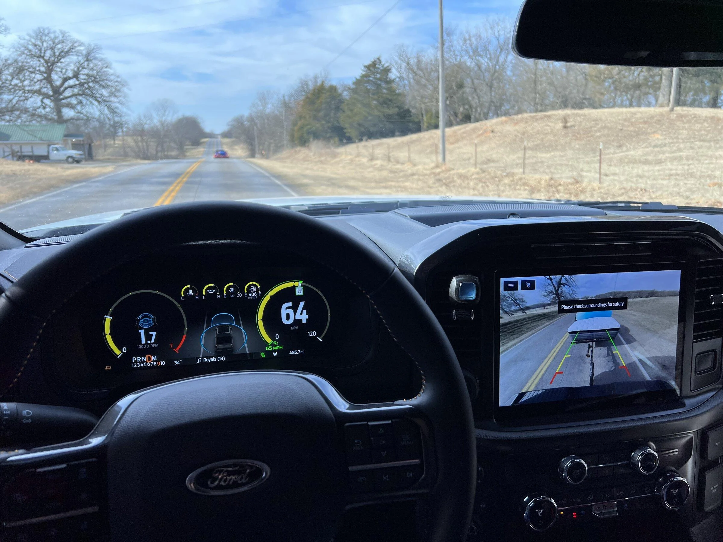

My job 2 truck has been able to show the bed camera in full screen or side screen indefinitely. I’ve been worried about a software update making it quit working and you’ve made me realize my fears are rational.
I’m gonna turn off auto updates.
Wouldn't that be some crap if they took it away. Maybe it got enabled accidently on Job 2 trucks and they are now fixing it.

Your bed cam should as well. Mine does.
