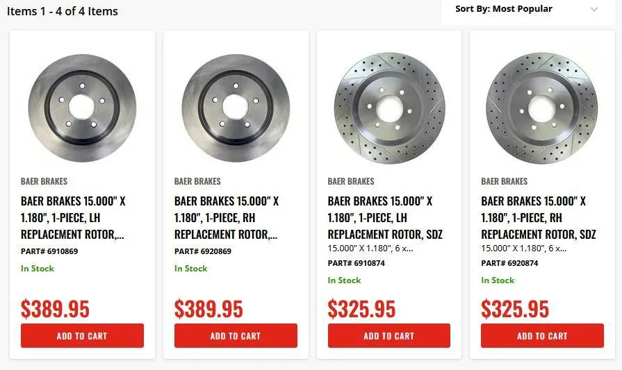

Before they changed up their site, they had both solid and slotted rotor replacements available but this kit was strictly D/S. Now I cannot find the replacement rotor part numbers or listed on the site.
I think I found them, but I'll have to call Baer to verify. In any case it looks like replacement rotors cost more than the whole kit, not much more, but still more than I would have expected at $779.90 for 2 rotors.
I wonder if I would be able to order the kit with plain rotors by calling and ordering directly from Baer.

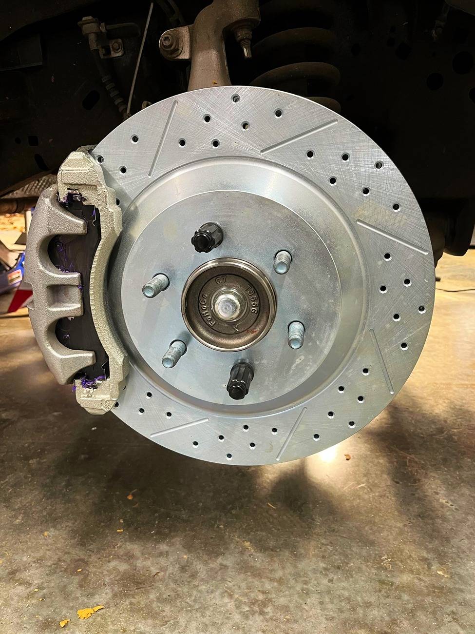

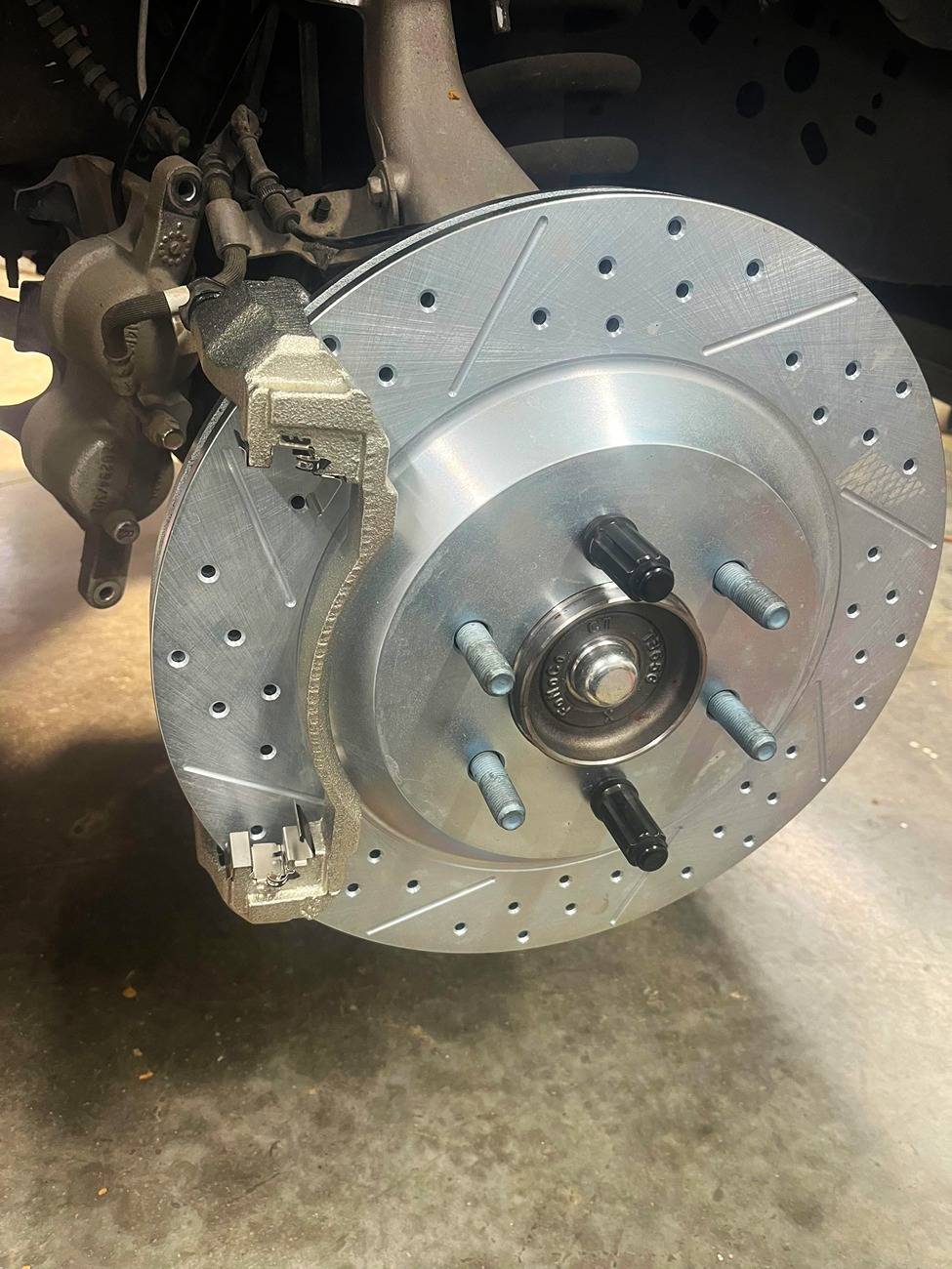

New bracket on and prepped. Fantastic feeling quality btw, no scuffing or damage on anything either.
Ford F-150 Baer Brakes Big Claw Performance Rotor Kit - #2261046 bracket-rotor-installed
OEM size Baer pads with full contact top to bottom.
Ford F-150 Baer Brakes Big Claw Performance Rotor Kit - #2261046 mount-with-pad

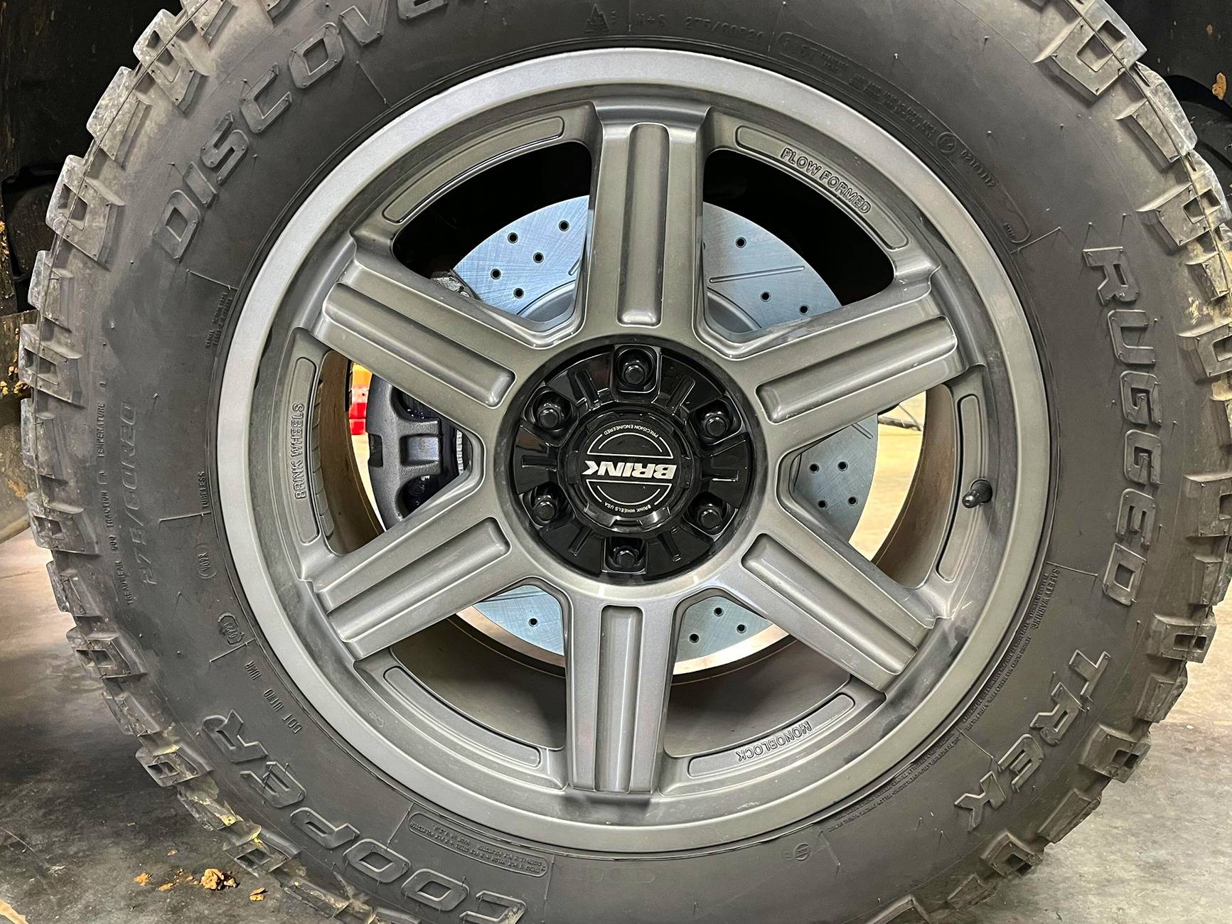

Done.
Ford F-150 Baer Brakes Big Claw Performance Rotor Kit - #2261046 completed

Nada, you're looking at the kit 100%. You a Baer hater hah? I'll call them, you most certainly can.
When looking up replacement 15"x1.18" rotors for a 6x135mm bolt pattern, these are the only options listed on their website. The drilled and slotted rotors are a little cheaper, but the prices are up there if they are correct.
Ford F-150 Baer Brakes Big Claw Performance Rotor Kit - #2261046 Baer

Spoke with Baer, part numbers are as follows for the drilled & slotted rotors:
Left: 6910874
Right: 6920874
They are $650 for the set. He said Holley runs a pretty persistent free shipping @ 10% off code but suggested when the time comes source from AutoZone. I had no idea but AZ will be starting to carry Baer soon, he said when that happens expect prices to drop.
