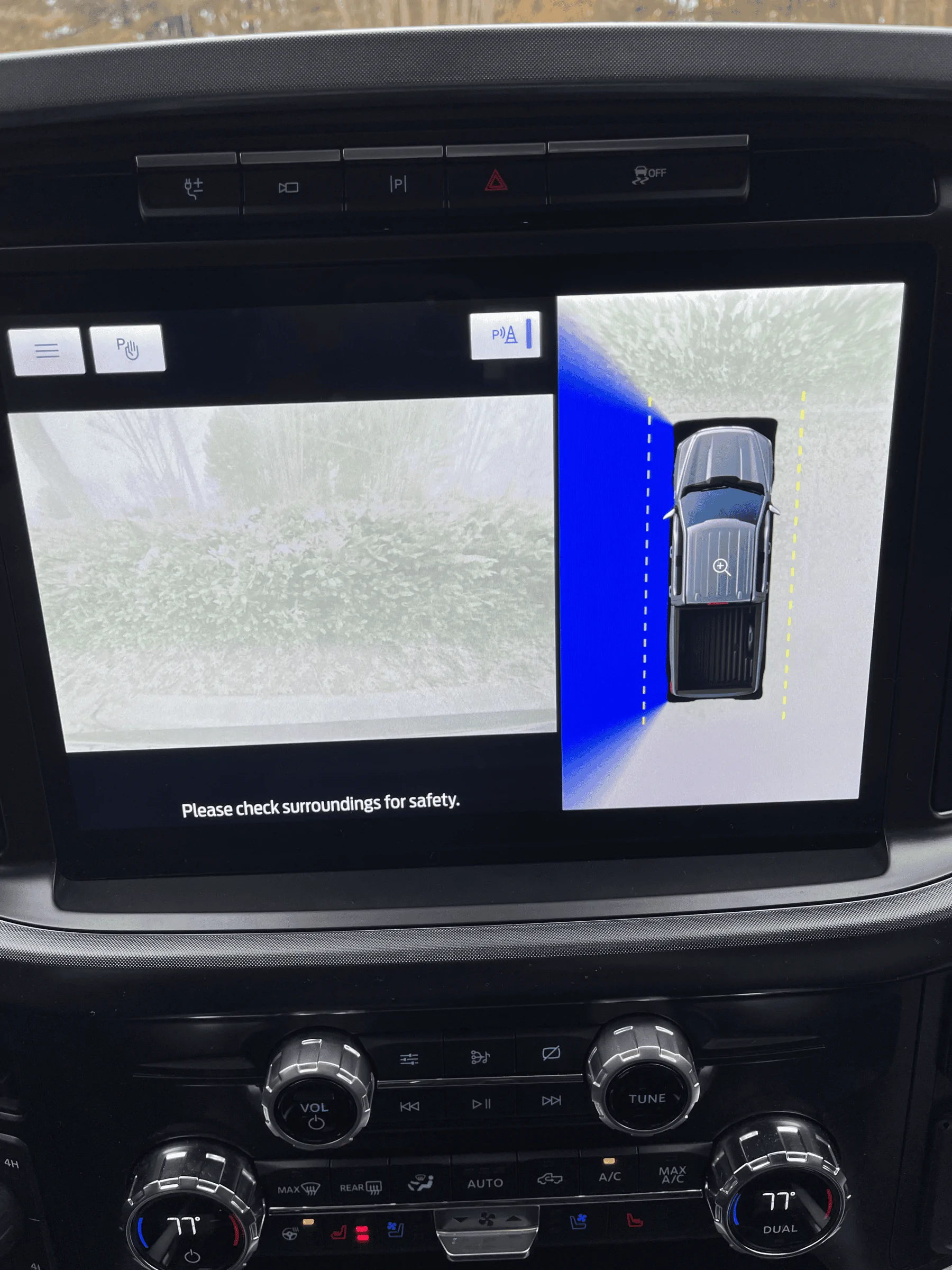

Has anyone experienced this? I get a blue, fuzzy video feed when using the cameras (both for reverse or front/overhead cameras). I've checked all the fuses and will get maybe 1 out of 10 tries when the camera does work. Not sure if coincidence or not, but this started happening after my last OTA update 2.1.
Ford F-150 Backup Camera - Blue Screen Blue_Screen_Shot

I know there is a recall on the Explorers for this same problem with the back up camera

My display looks just like that. This just started this evening. It was fine this morning. Did you find a solution?

The Ford tech removed some trim and found C5104 unplugged from the mirror harness. Once he plugged it back in all the codes cleared and everything worked again. Thankfully it hasn't been an issue since.

Do you know where this is? Ford can't get my truck in until February 16th...

Unfortunately I do not. The tech said he had to remove a few things to get to it, but he wasn't very specific.

My truck had the same issue. A connection came apart. The tech also said that the driver's side camera was bad and needs to be replaced. However, it has been working ever sine I picked the truck up. I'll still have it replaced once they can get the truck back in, which isn't until March 22nd.

Same problem here 2023 F150 with 14k miles on it. This started an hour ago.
