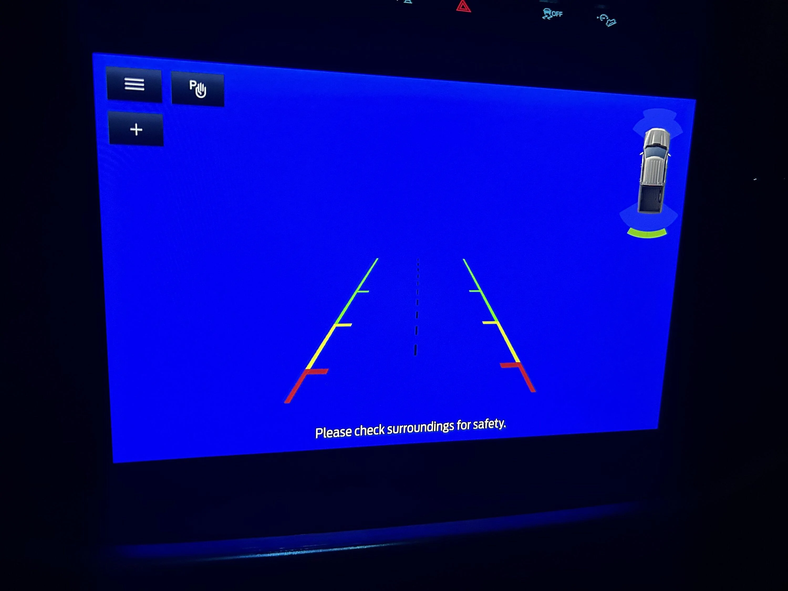

Backing up today, put tailgate down as I was backing up to a garbage bin to off load garbage from box of truck. Didn’t notice right away but once I got back in the truck noticed right away that camera screen is just solid blue. No cameras working at all. Any idea on how to reset? I did the radio power button and right seek button reset but did not fix the issue. Reverse lines still work. When I bring up camera menu for other cameras that shows up but nothing works except for going in to trailer backup mode.

Finally crawled under it and the camera plug locking tab is gone. Likely from the guys who very recently did my spray in box liner. Camera is working again now though for the time being.
