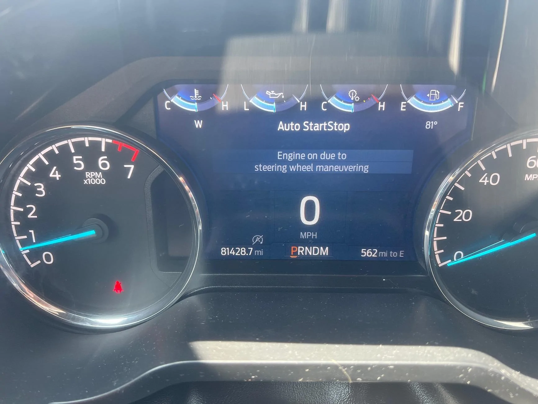

When I went in for the fuel, economy and pressed auto start stop, that’s what it said.

Did you buy your truck new or used?
One Forscan method of disabling Auto Start Stop is coding a steering movement as always on. This disables ASS. Maybe a previous owner turned this on in Forscan and now your ASS won't work no matter your battery voltage.
This is where I would go next if I were you. Do you have a Forscan compatible cable/dongle? Ever used the software? If not, we can help get you going in Forscan, it's worth it to disable all the warning chimes also...
