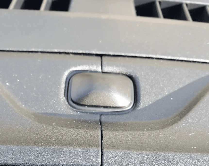

Ag
I have this "issue" too and it drives me nuts. Even worse on my wife's Expedition. 2PM, not a cloud in the sky and my headlights come on from the shadow of my own roof if the sun is to the rear. Dash dims then I can barely read anything. Crap design.
That was easy enough -- I blacked out that sensor and the headlights came on @fordhouston
