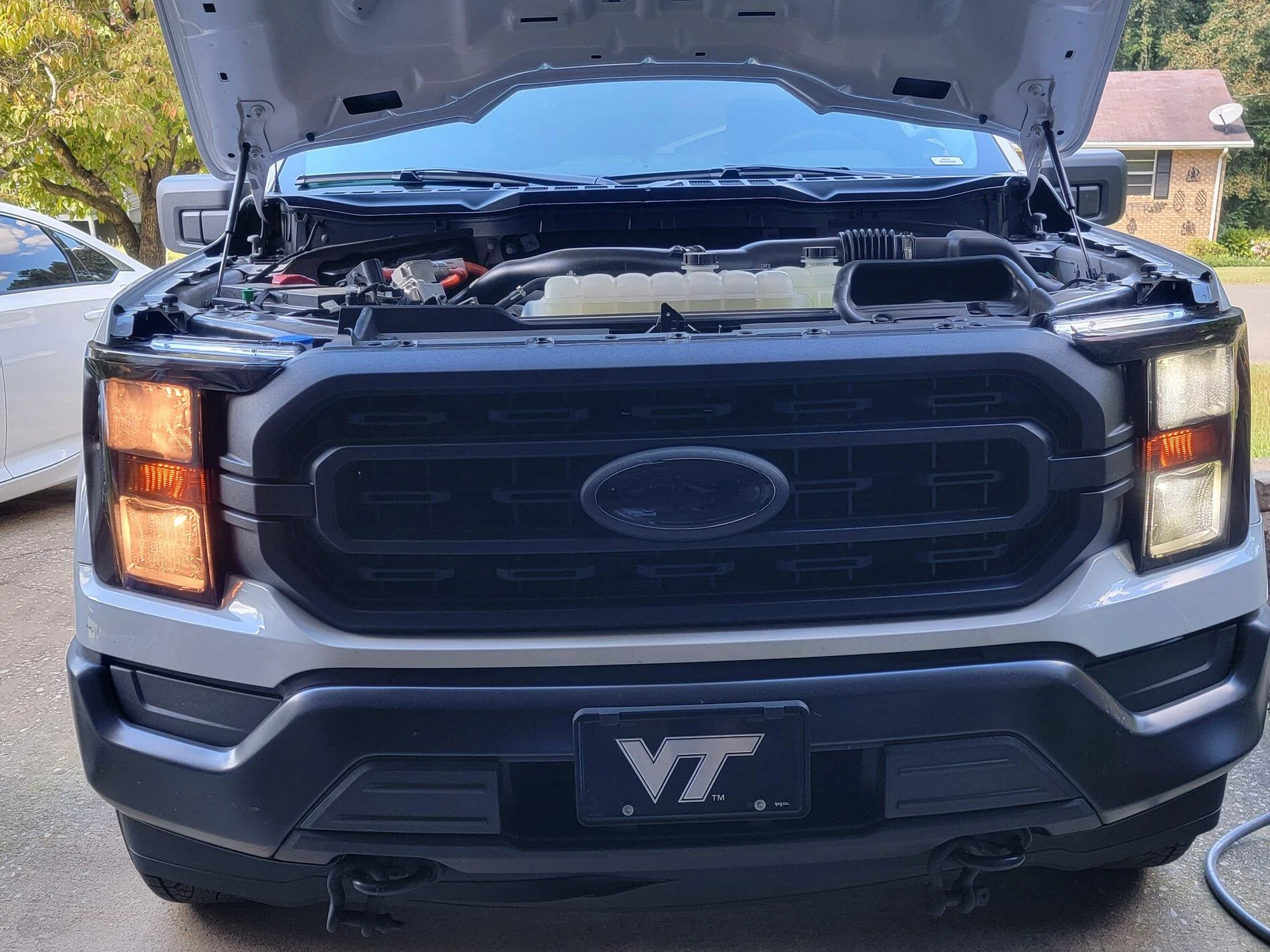

New here but am curious as to why Ford doesn't list the type of headlight that's on the truck other than Halogen. I'm looking at 2 trucks and it's pretty apparent the headlights are different. The XL has Halogens but the XLT has no such identification other than the housing being very different.

Ford F-150 Anyone Using These LED Replacements in Their Halogen Housings? XL Halogen Lights

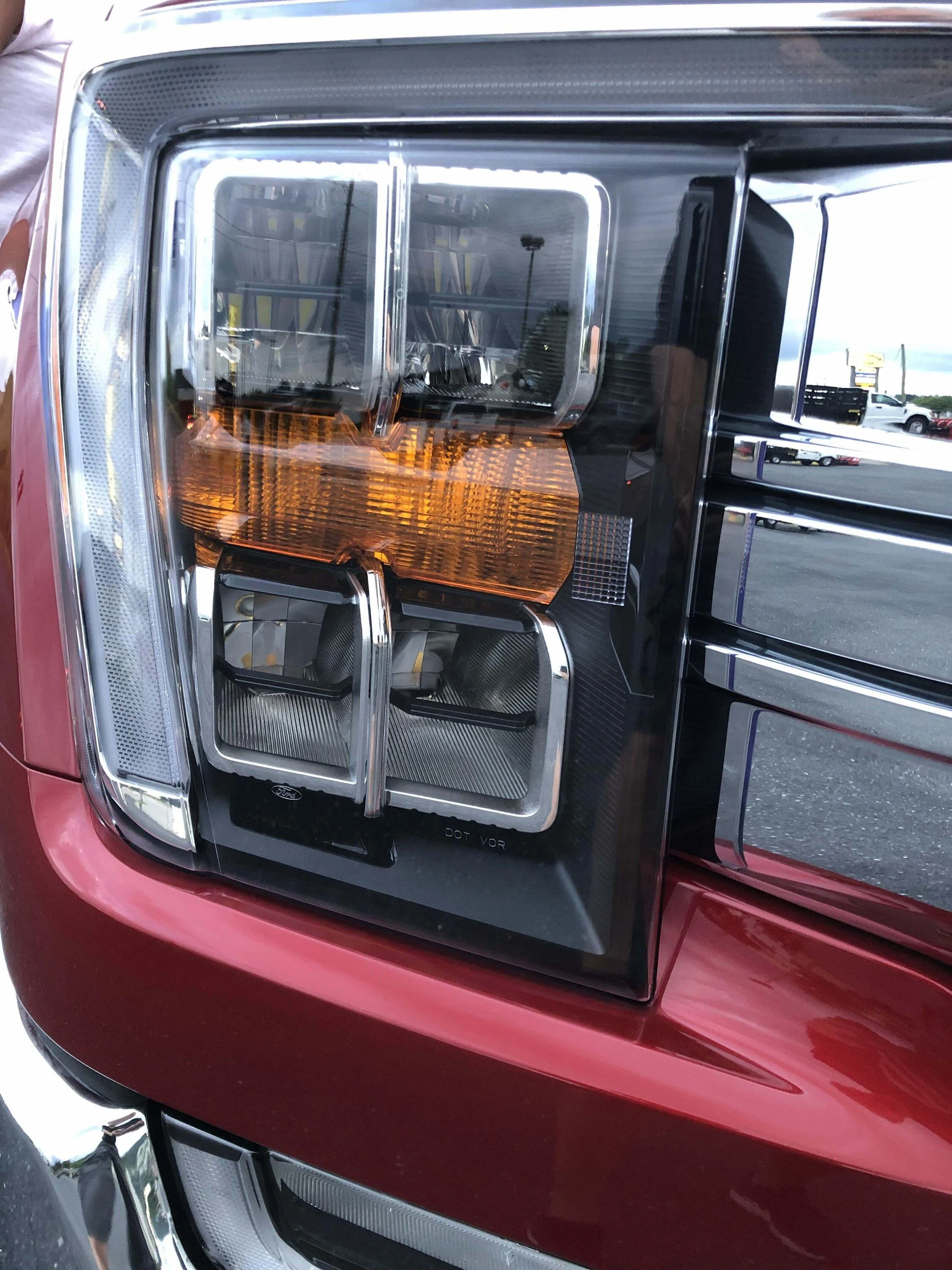

Ford F-150 Anyone Using These LED Replacements in Their Halogen Housings? XLT Lights

The xl trucks have halegon bulbs in the housing(you could easily replace these) while the xlt’s have led reflectors in the housing with halogen turn signals (you can’t replace forward facing lights because they aren’t bulbs they are built in diodes, then the turn signals are halogen bulbs) then lariat 502a plus trim trucks have full led projector headlights and turn signals( they are all built in diodes no bulbs to replace)

XLT in the picture has LED headlights
