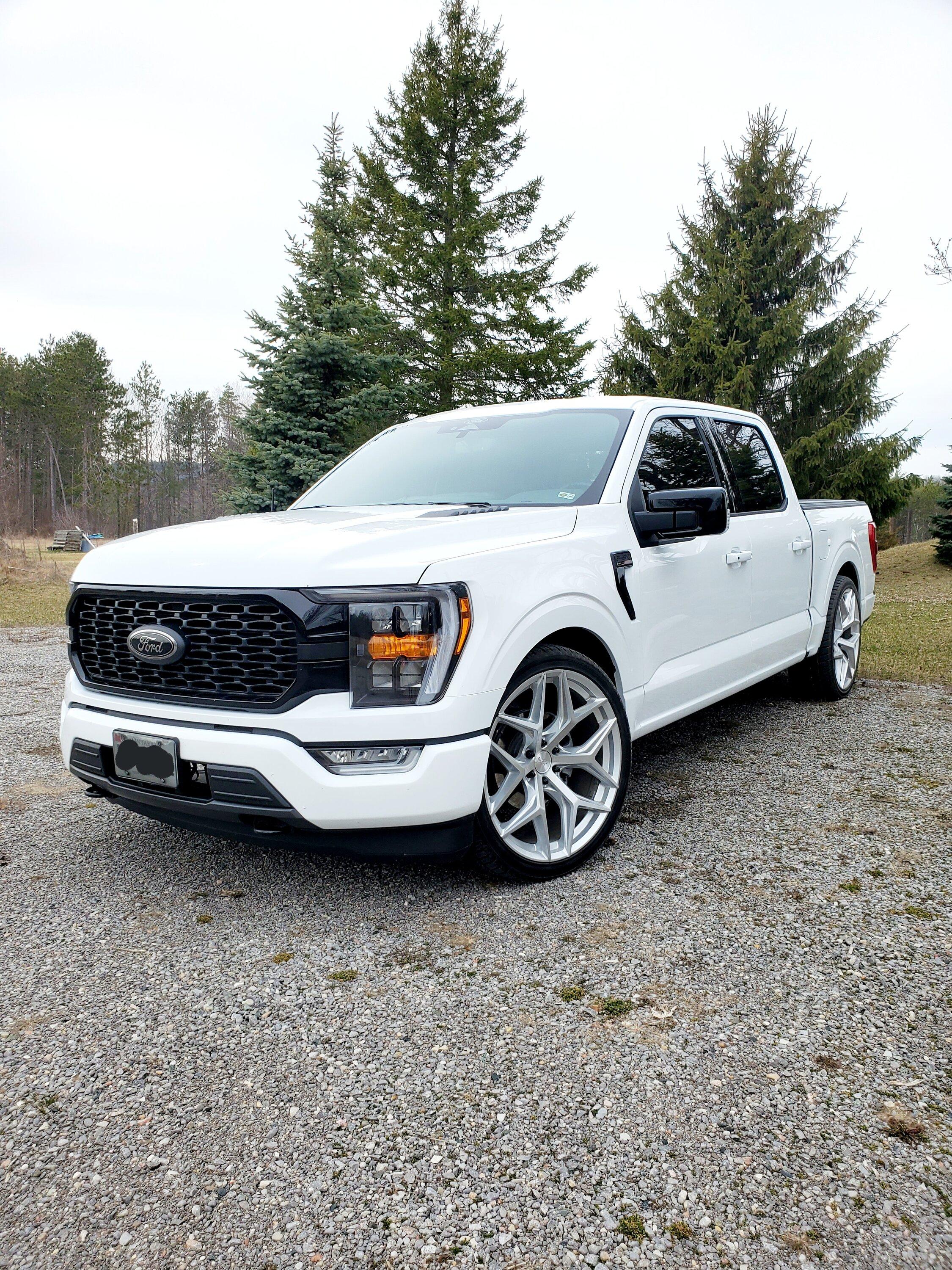

Not a Lariat so no camera provision but I swapped my Lariat style BAP grille for STX.
Dealer and body shop claim they aren't interchangeable but indeed they are.
Sheesh that's beautiful. Is the honeycomb glossy?

I finally got around to switching the grills. It took me some time to paint the emblems to color match so got delayed.
The swap was really straight forward. Had to cut off two small plastic pieces but other than that it was easy.
Was it a clean swap? Or did you have to make any adjustments??
For me, easy swap except I had to cut off a small (about 2"X2") piece of rubber to make it sit flush. Just used a utility knife to do it.
Was pretty well straight swap. Some of the holes for the grommets/fasteners for the shroud didn't line up but that's no deal at all and doesn't affect anything.
