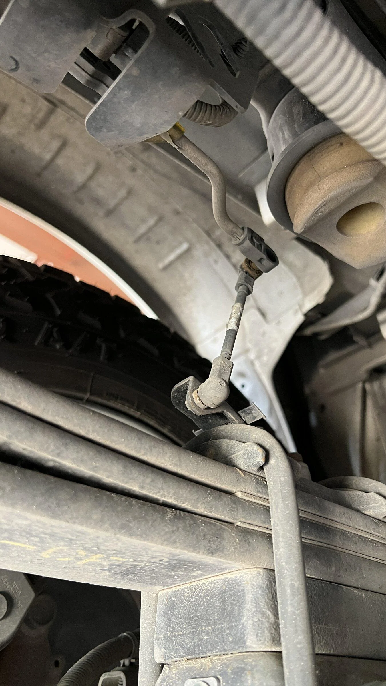

Any idea what this device is?
Litebulb
Dec 20, 2021
Houston TX
2021 F150 Platinum Powerboost
Electrical Contractor
Was installing an exhaust on my platinum powerboost and saw this connected to my suspension and wondered if anyone know what it’s doing and is lol. Thanks.
Ford F-150 Any idea what this device is? 74014EC6-6DB0-40E6-9189-7B8C71FD0A38
Ford F-150 Any idea what this device is? A03D35FC-7A5B-479F-B9F0-F868EEBC70A3
mmdpg
Feb 23, 2021
184
164
Massachusetts
2008 Bullitt Mustang, 2021 F-150 Lariat
Level sensor to adjust headlights as payload is added and the back of the truck squats.

Bad ass thanks. Looks like it’s possibly in the way to add a ready lift air bag setup.
It’s not, no issues when installing my airlift kit.
If it's the ReadyAir system, I believe they have a kit to move the sensor.
