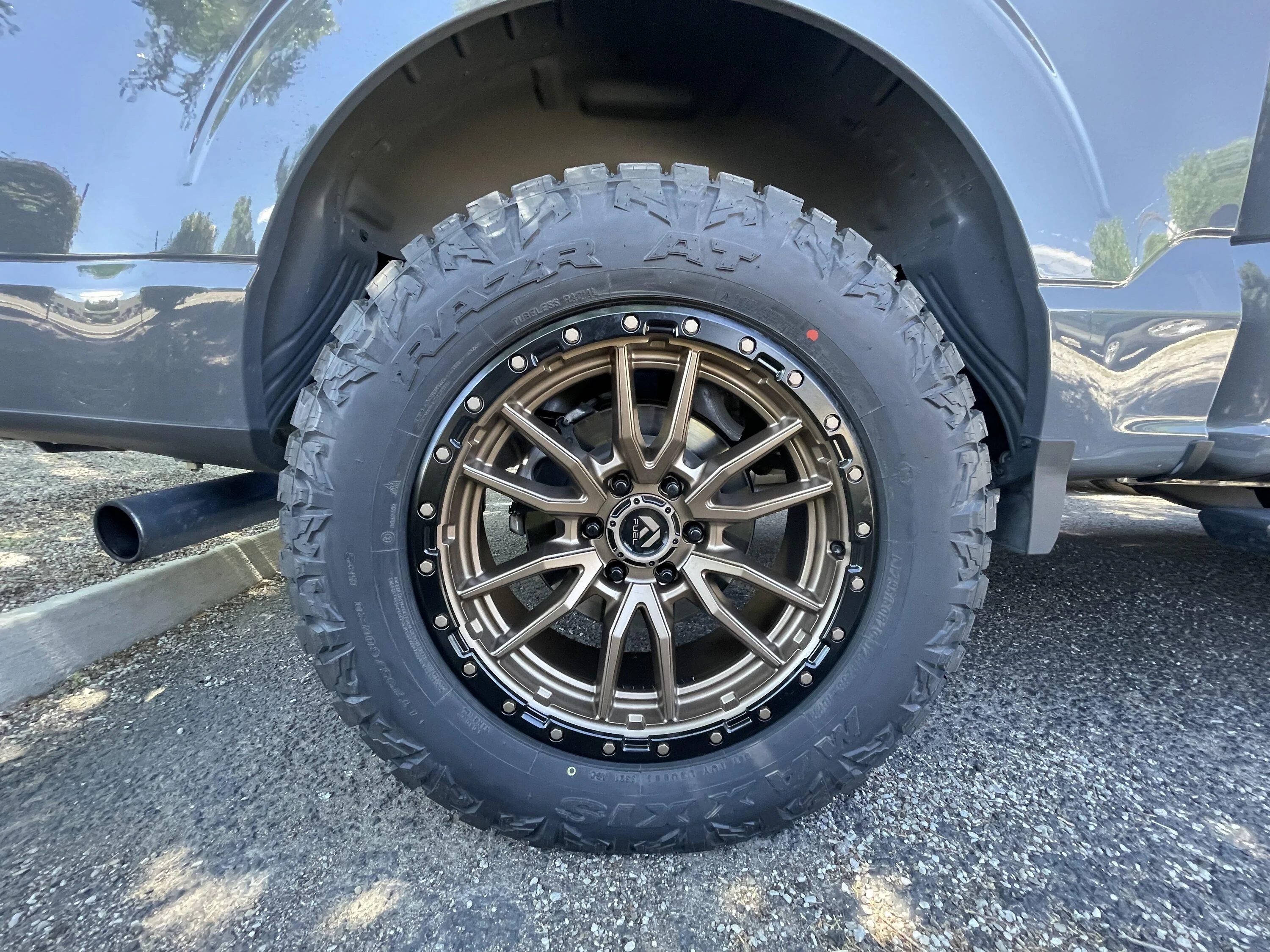

Saw this truck in Utah and love the build. I want to know if this is just a leveling kit, or if it’s lifted. I believe the tires are 295/70r18. I plan on going with Methods but haven’t decided if I want 18’s or 20’s. I was set on 20’s but not sure if these 20” Methods are too much wheel for a 33” or 34” tire. I don’t want any rubbing and don’t particularly want to trim anything. Can anybody provide info?

Simple pinch zoom on my phone with your picture shows 285/70/18, not 295. Just FYI.

The rear does not look lifted to me, if anything it’s a bit squatted
The front is up probably 2”-3”
Lifts usually are really apparent as the front cross member then dips lower than the frame.
Silver coils, so I would assume Fox, based on popularity. Figure a max of 2.5", then.

I went with the Ikon 2.5’s front and rear to level the truck and managed to fit 295/60 x20’s. They still rub a bit on the crash bar at full lock as a warning, but I would do it again if I could! The level is great as well, but with the ford lane centering you can get some serious lane drift that I did not notice before the level.
