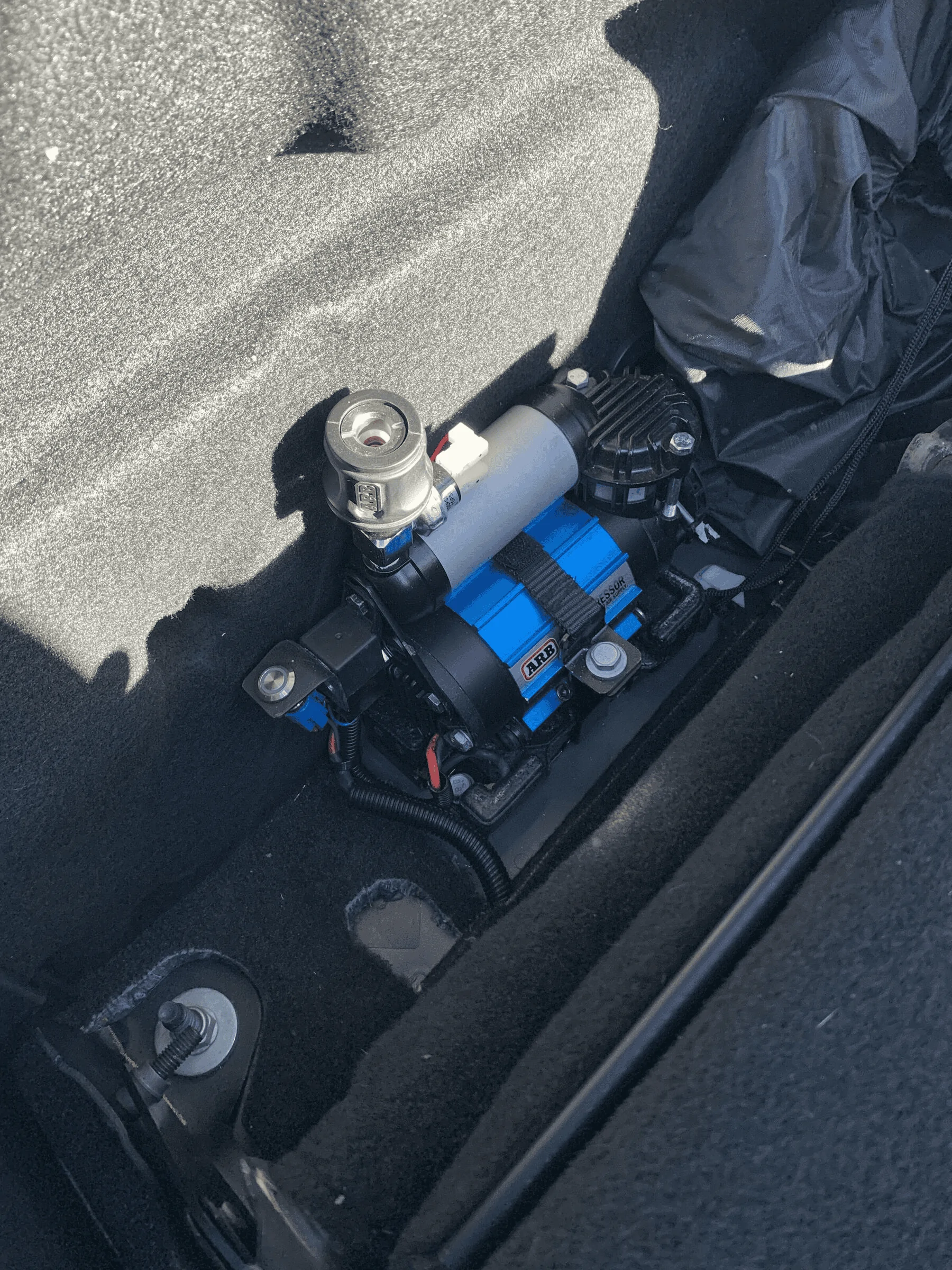

First thing I did was install my trusty ARB compressor. It's been through 4 vehicles over the years. Originally used to air up after offroading, now I use it to keep my camper and boat tires up to pressure.
This install was neat, in that it fit into the jack holder, behind the 40% rear seat with just a little modification. The foam keeps it nice and quiet. Plus the second battery is right there to power it up. That battery is plenty for that little compressor. I moved the jack behind the 60% rear seat back.

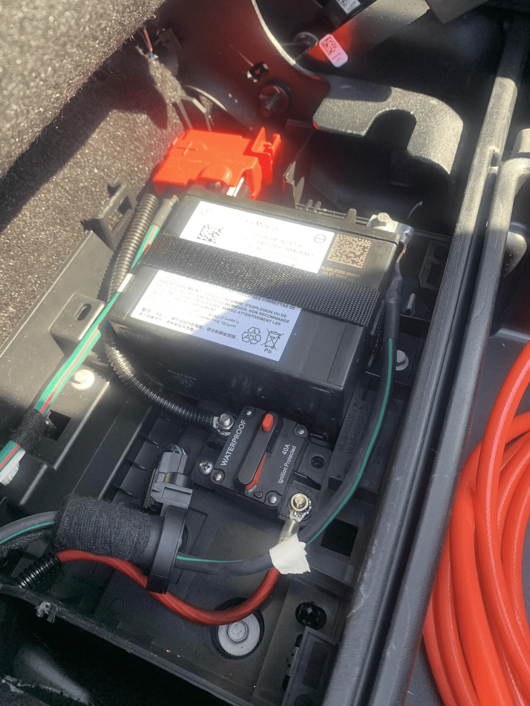

Can you give a little rundown on the wiring of this compressor to the second battery?

Sure-
The ARB Compressor wiring harness is extremely large and complex. I completely gutted it and used their wiring to make a simple harness. On the front of the compressor I mounted a relay and push button switch to power it on and off.
As far as wiring to the battery, The +12v 10 gauge lead from the compressor connects to a 40 amp circuit breaker and the other side of the circuit breaker connects to the battery +12v terminal. The Negative lead from the compressor is grounded under one of the mounting bolts. Very, very simple once you get past ARB's birdnest of a harness.
