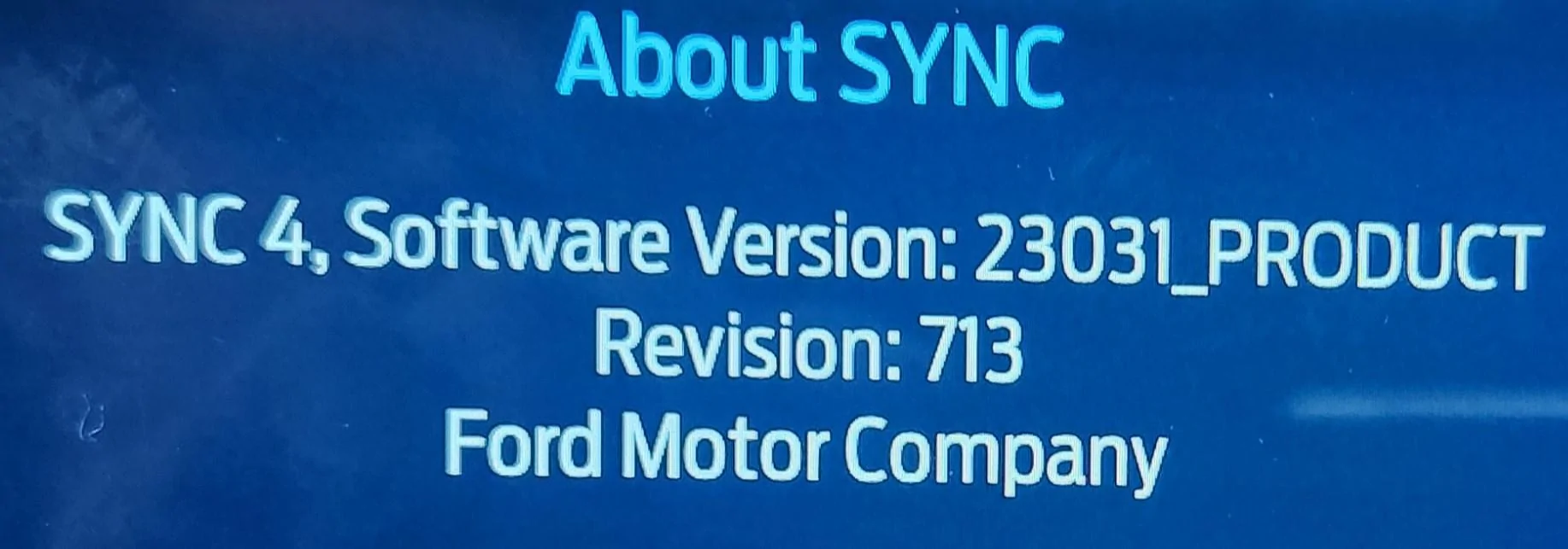

I don't know if that's true about the widget. I have the AIBox as well and also purchased the carluex pro. After an update a few days ago, the carluex will do full screen, especially after I'm using wireless carplay in fullscreen.

There's a few of us wanting to get the fullscreen back. Could you please provide us with the following:
You're using the Carluex Pro?
Current Sync Version?
Current Power up Version?
Android or iPhone?

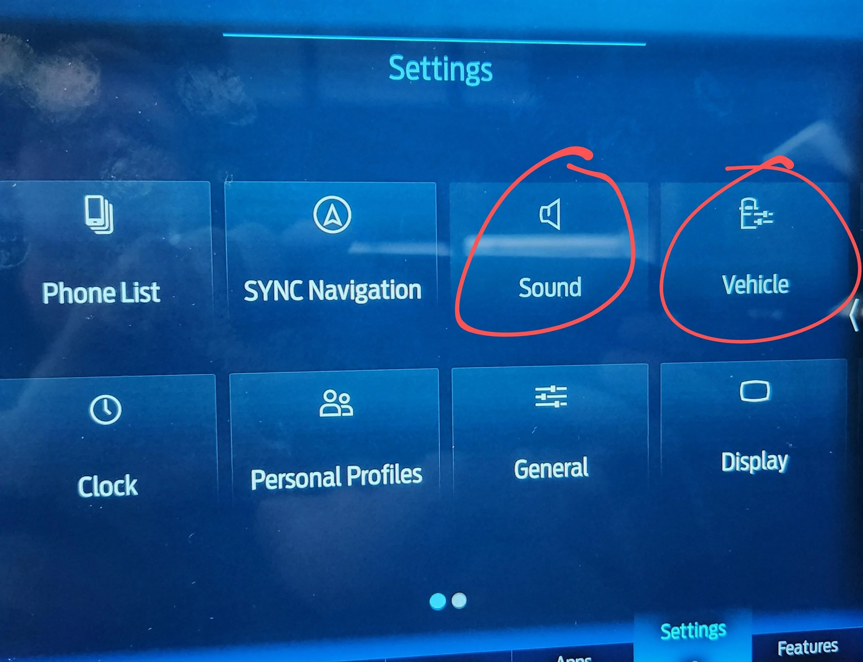

Here's an odd one. Maybe you guys have seen this before. So I started my truck a couple of days ago and switched from Android Auto over to my Carplay box under Phones. Immediately I noticed the audio was very tinny and seemed to be only coming from the front speakers, so it seemed. Went to adjust the audio settings only to discover they were grayed out on the Sync interface. Vehicle and Sound icons are both grayed out. This prevents me from even accessing the audio controls. Checked my Sync and PowerUp versions, 713 and 4.2.2.2, the same as they were when everything was working fine. Tried turning the Sync power off/on, no change.
Anyone else seeing similar or have suggestions for a solution?
The icons may not look grayed out in the photos, I assure you they are though.

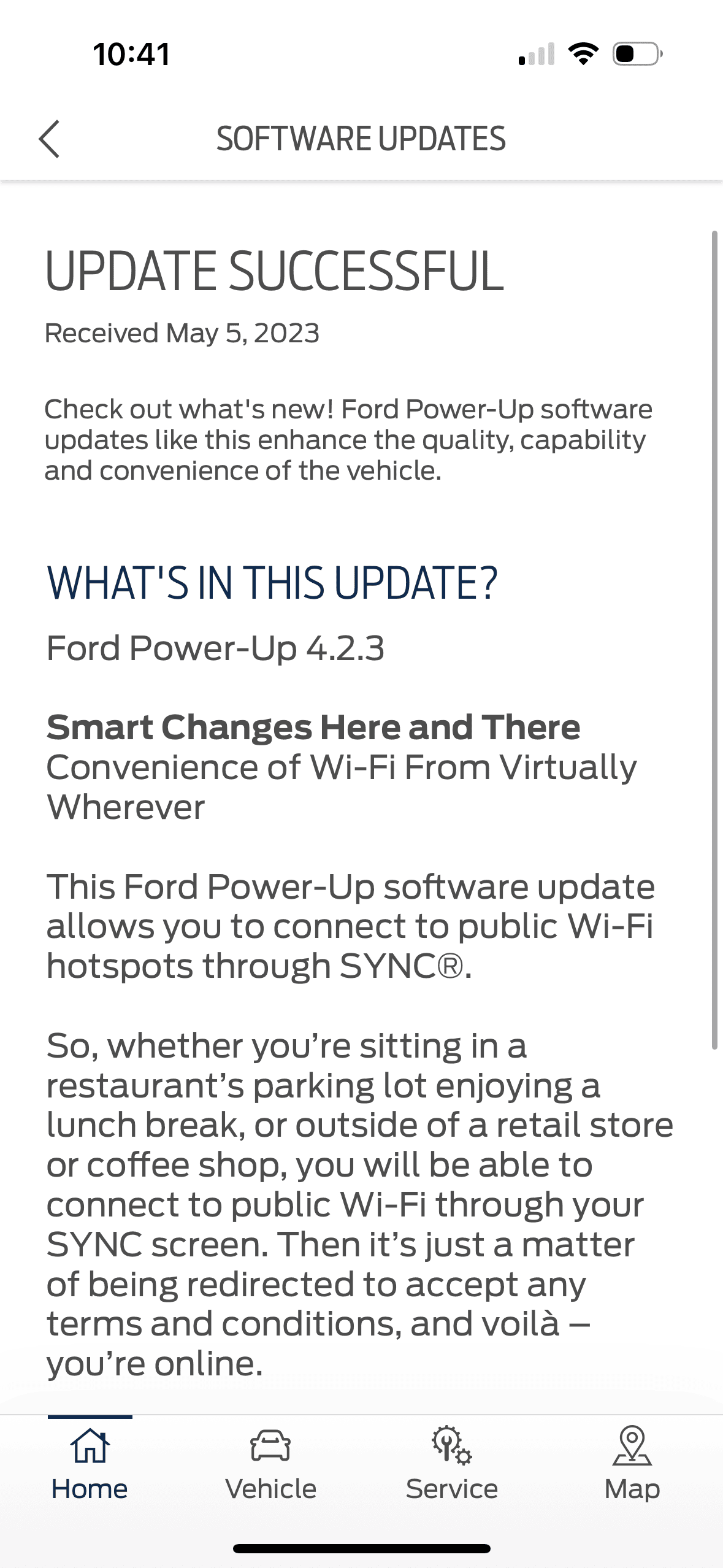

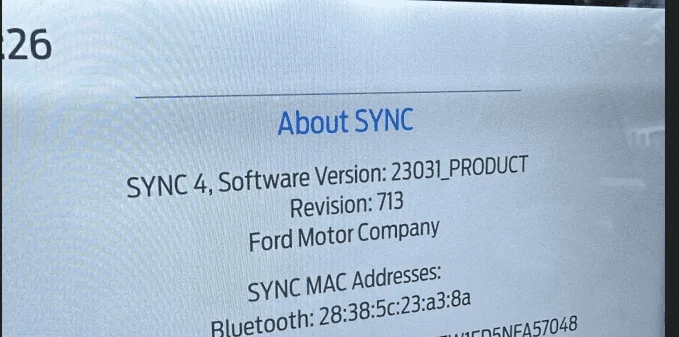

Hey ya'll sorry for the delay. The android box I have is the Carluex Pro. It works full screen only after using wireless Apple Carplay. Here's my SYNC version and Power Up. The downside to the Carluex is it’s more money and not nearly as responsive as the AiBox.

Thank you sir! This is good to know and promising. Bummer about the responsiveness. Wish they had a 8G Ram+128G storage version, no doubt that would help.

Just placed my order for Carluex Pro Wireless. @elibb98 had success achieving fullscreen with the same Sync and PowerUp versions I currently have in my truck. Used link they sent and it's $329 free shipping. Per their policy on website, I'll be paying return shipping if that happens. That link saved me $30 so I'll tell myself that helps ? Android 12 4GB Ram/64GB Rom

Thanks for the update. I recently bought the Carlink Max new version hoping it would work, but was unable to achieve full screen. I am thinking of pulling the trigger on the Carluex Pro myself to see if it will work. I have the same versions downloaded as well and have turned off auto updates to help prevent something that may work from getting bricked.
