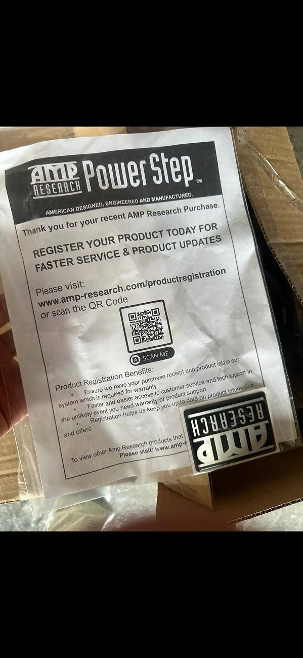

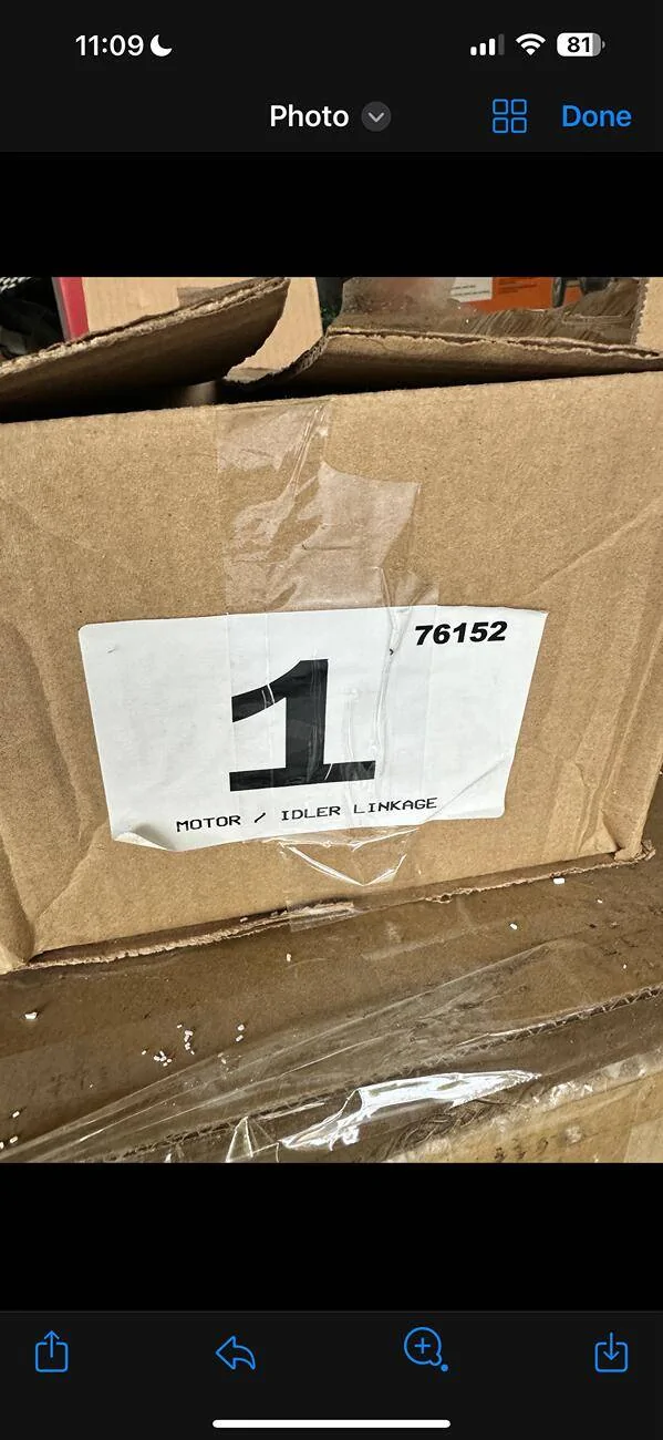

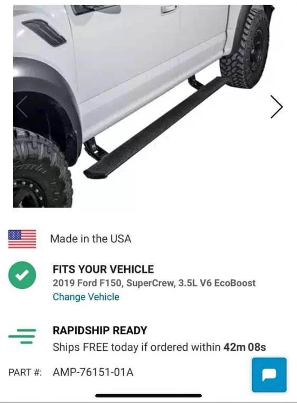

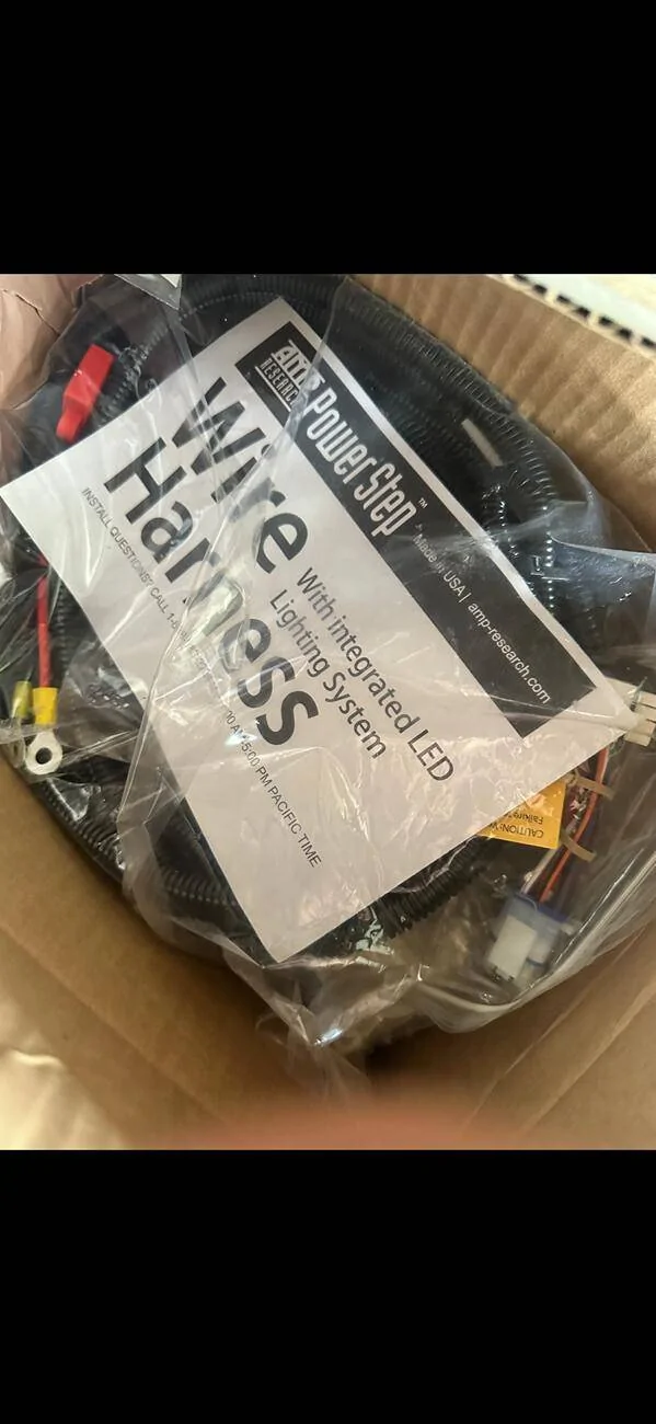

These are supposed to be pictures of 76151-01A for a 15-20 F150. (The boxes show 76152 so I’m not sure if that internal code or if it’s a different model number)
The owner sent these pictures to me when I asked him to verify the contents of the box would be compatible with my 2021 (after I get the proper OBD adapter).
Does this stuff look legit?
Thanks for any info. I’d love to not waste a two hour drive if I don’t have to!
They all look the same for the most part, no clue what the original boxes look like. The mounts to the body are unique to ford as is the OBD2 which is specific to generation and truck. You have to verify each part number on the website/instructions
